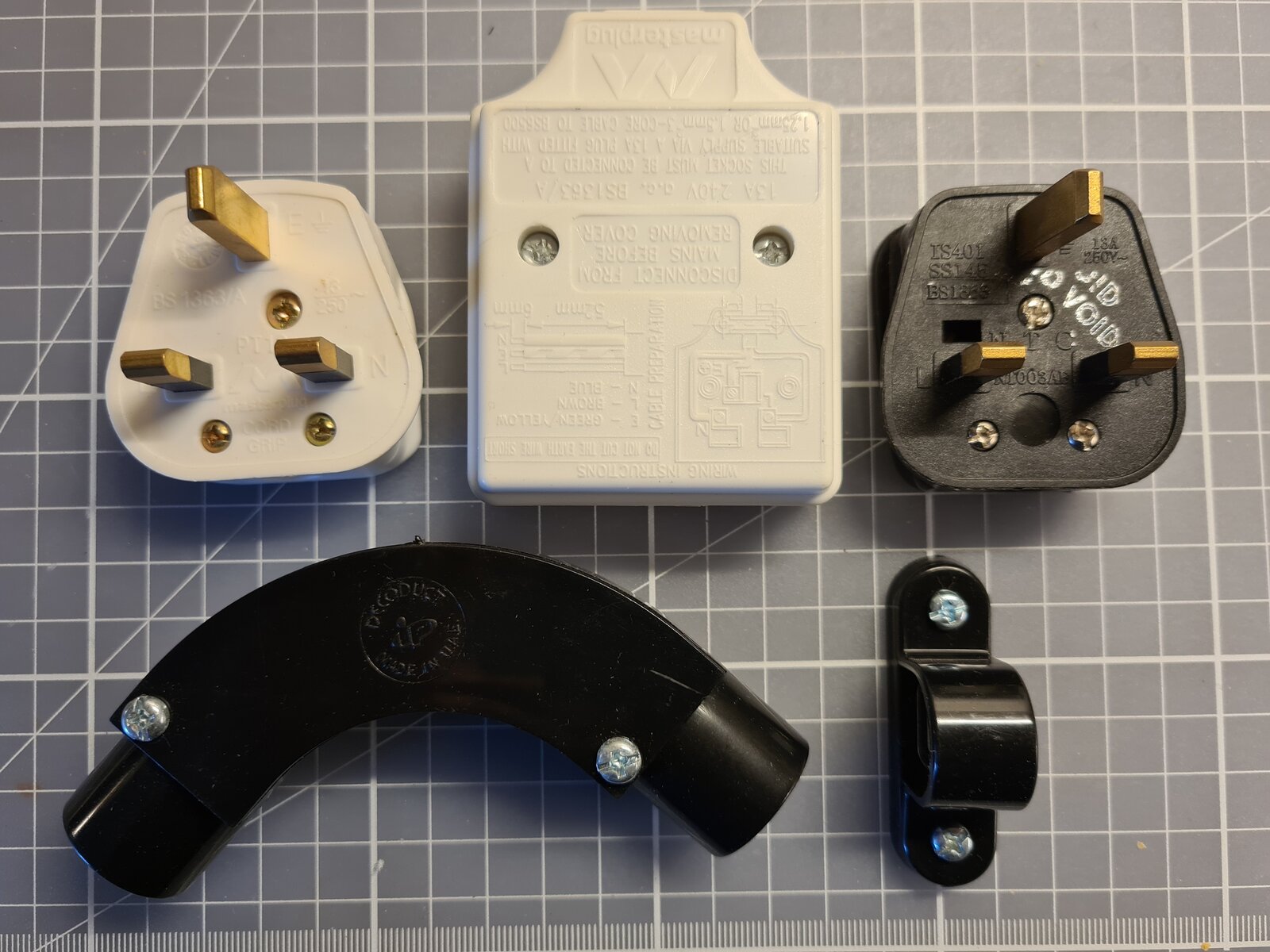

Plasterboard screws = Phillips
Plasterboard umbrella fixings = Phillips
Self drilling wafer screws = Phillips
UK 13A plug(and trailing socket) screws = Phillips
Conduit saddles and bends = Phillips
Electrical items made in China which aren't torx/snake eyes/etc = Phillips
No Pozi screws at all in that photo. They're all combined Phillips/Slot, but a decent PH2 screwdriver works so much better than a slotted screwdriver for all of them.
