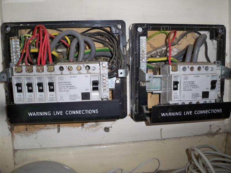

There are henly blocks after the meter on the other side of the wall and spare tails pushed into the floor, but no marks on the DNO board where another meter may have been.
There are spare tails stuffed into the floor as if it used to be connected to the one supply.
There is only room for the single mcb in the cover.
I can't think it would only have had one NSH.
I haven't had time to examine it yet.
