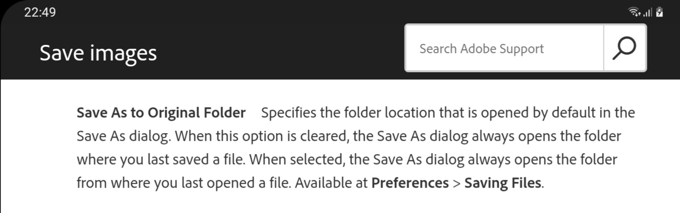

Hi,
I don't know if this will solve your problem?
This preference changes the default 'Save as' location between either, where you last saved a file, or where you last opened a file.
Full link:
https://helpx.adobe.com/photoshop-elements/using/saving-exporting-images.html
I hope that helps :)
