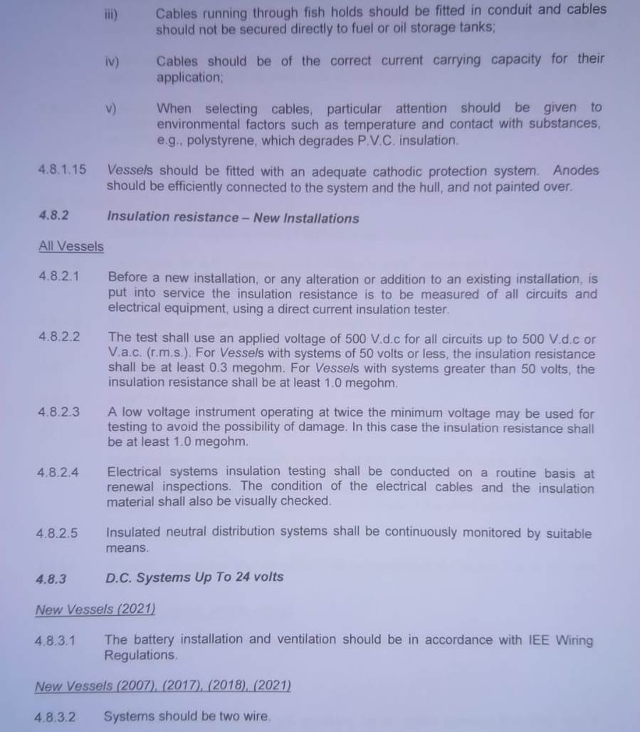

new requirements for fishing vessels.
I am slightly perplexed, it seems that 4.8.2.3 indicates that we may be able to use eg a 48V test for a nominally 24VDC distribution arrangement as found on most fishing boats. or a 24V test for a nominally 12V vessel. But this would be in contradiction of 4.8.2.2 test shall use 500VDC.
My megger only goes as low as 250V for an insulation test. are there 24V insualtion testers?

I understand that "the possibility of damage" pertains to sensitive equipment such as computers, radio gear, radar, sounders etc that may well be permanently connected. In the case of a standard 24V DC workboat, I would expect older equipment to be rated max 32V (from memory, older wide-voltage stuff usually states 12-32V) and modern gear 10-40V.
twice 24V = 48V, so a possibility of damage to eqpt remains if testing at this level. (?)
I feel that it is common sense to disconnect the actual gadgets when making insulation tests, so why not just make that the damage caveat. just from hard experience I feel that pressurising a soggy 24V wiring at 48V is still not going to reveal any weak spots, which is why the Megger(tm) goes orders of magnitude higher.

It's saying test at 500VDC unless damage is likely, in which case it is acceptable to test at a lower voltage so long as it meets the alternate requirement for insulation resistance
