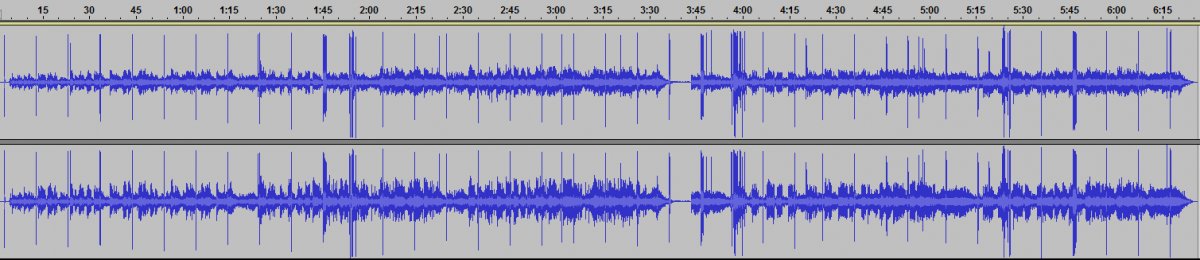

I have tried unplugging head phones, but how I stop interference after that I am stumped. I note it depends on time of day. I have tried fitting batteries still picking up interference. Also tried powered USB hub and direct to lap top. I have not noted the same problem using an analogue transfer although in the past I have in the main been transferring books on tape rather than music cassettes. The books on tape seem to be sold off cheap so transferring to MP3 is well worth while.

What sort of interference from where?

It is a sound which would lead me to suspect a central heating thermostat chattering but my thermostat does not switch on and off that often. Could be anything from beer temperature controllers to a faulty fluorescent lamp. For audio tapes it's not enough to worry about listening to Terry Pratchett at moment. But for music dead loss. It was very cheap opening offers in new local Aldi likely less than £5 but present so don't know exactly.

But I have found before some times some really simple things can cure a problem. I remember using 3 in 1 oil to remove scratch sounds on records when recording 78's. So always worth asking. For all I know there may be a software filter to stop it.
This is a particularly bad one. This spikes are heard as clicks as I say like central heating thermostat, but that many in 6 minutes?

The source of your clicks can be pinpointed by using an AM radio tuned off-station. Pray that it's not the tape player acting like a Van der Graaf generator! If it is then the only cure is humidity or a grounded conductive "wiper".
Good point with Van der Graaf generator something I had not considered. Humidity 43% so yes quite low so good possibility specially with the regular fault. In some ways good as I can do something to stop it. Now I have an idea I will try again and see if I can cure it. Thank you.
