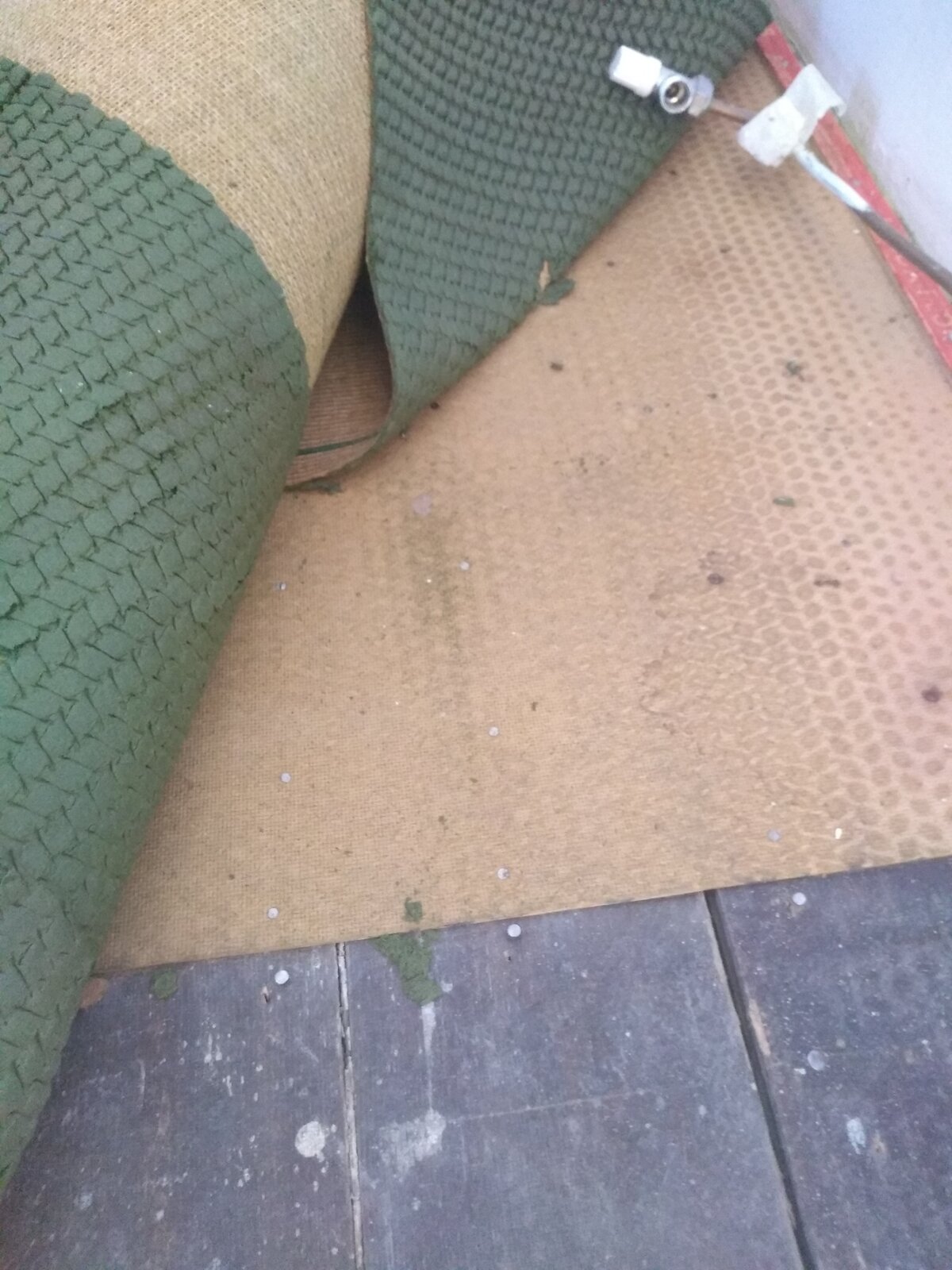

I am planning on doing a floating engineered wood floor in an upstairs in an old (200 years) house. I know that you would normally fit the engineered wood floor over the original floorboards, at an adjacent angle to the existing floorboards.
However, as there is already fibre board nailed to the old original floorboards I am wondering if this matters or if it would be ok to fit them parallel/ running in the same direction.

How flat are your 200 year old floor boards? Chances are they are either cupped or crowned, and you ideally need a flat surface to lay laminate or engineered flooring. Planked sub-flooring has the potential to move and for cups and crowns to telegraph througj anything laid on top, so personally I'd lift the underlay, install a layer of thin plywood onto the floorboards then float your flooring on top of that - at least then you will be assured that any cupping or crowning won't be telegraphed to the new finished flooring and the ditection of your planking won't matter
Thanks. I don't know if I was clear, but there is already board nailed over the original boards. I referred to it as fibreboard, but that might not be what its called. Its similar to the stuff you usually see pinned on to the back of cheap flatpack furniture.
Its about 2-3mm and its been nailed to the original boards, before the underlay and carpet were put on. I took a section off to see if the original boards were good enough for sanding (surprise, surprise they weren't) and its fairly tightly tacked on, need to get a chisel underneath and a claw hammer to prise it up.
Do you think this will this do the same job as the ply you suggest, meaning that I dont need to worry about the direction of the boards?
No. The fibreboard is underlay and wil conform to the floorboards beneath.

Just to clear we are talking about the same thing, as I said in my last post I don't think this stuff is called fibreboard. I looked it up online and its called hardboard. In Jewson its called 'standard hardboard' and b and q its 'brown hardboard', both 3mm which seems about right. I've put a pic below.
There does seem to be a small amount of conformity to the boards underneath, but I imagine most wood based materials that thin will confirm to some degree. I'll need to lift all of the carpet and inspect how flat it is. Its been down for at least 20 years so if its likely to have done any conforming its going to do by now. I've pasted a pic below where I lifted one of the hardboard sections.

You can check flatness with a long straight edge (I use a 6ft spirit level, but a piece of straight 3 x 2in PAR or CLS softwood would work just as well) an obtuse light source (i.e. a lamp shone across the surface of the floor, flat on to the floor). Different thicknesses of plastic packers allow you to gauge the depth of hollows
Thanks. I have a 6ft level I plan to use once I get the carpet up. One of the places I lifted it already was out of level, but that appears to be because its been lifted before and the board put back down with the original boards loose.
