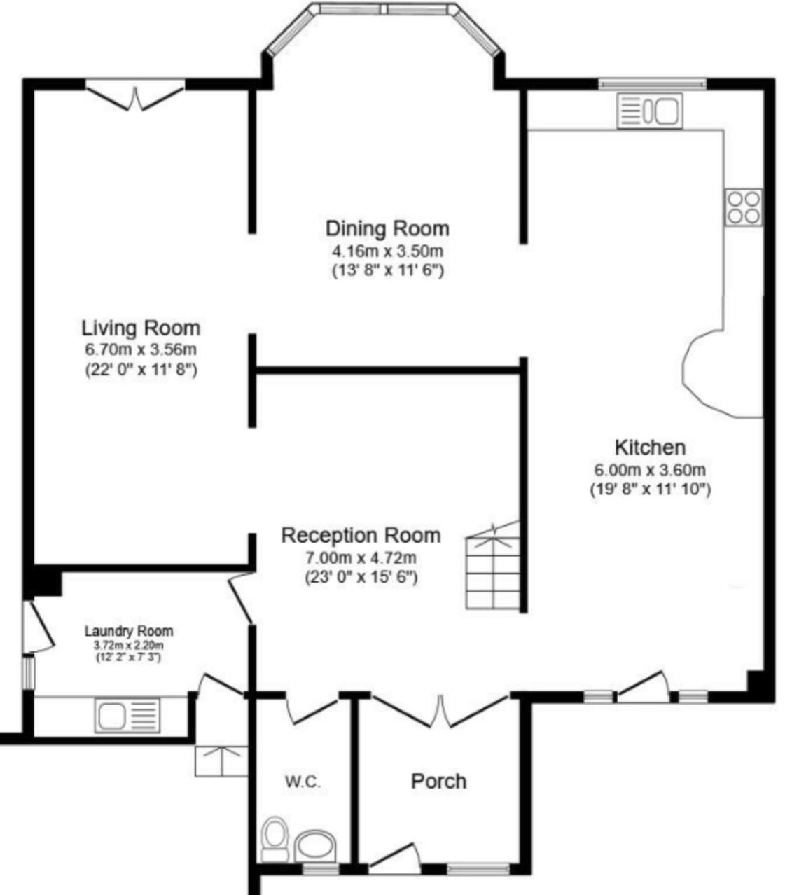

I have a new house that is very open plan, and whilst I've got some experience laying floor in single rooms, nothing like this. I'm worried about it all joining up. Layout attached. As you can see there are no doors and I plan to start at the lower left corner of the reception room. At some point the two sides need to meet up...I guess at the kitchen/dining room transition.
Any advice?
Porch has nice herringbone already so will leave, downstairs loo will be laid separate, utility room likewise. But the rest will contiguous.
I mean in theory it should be perfectly aligned. Right?
