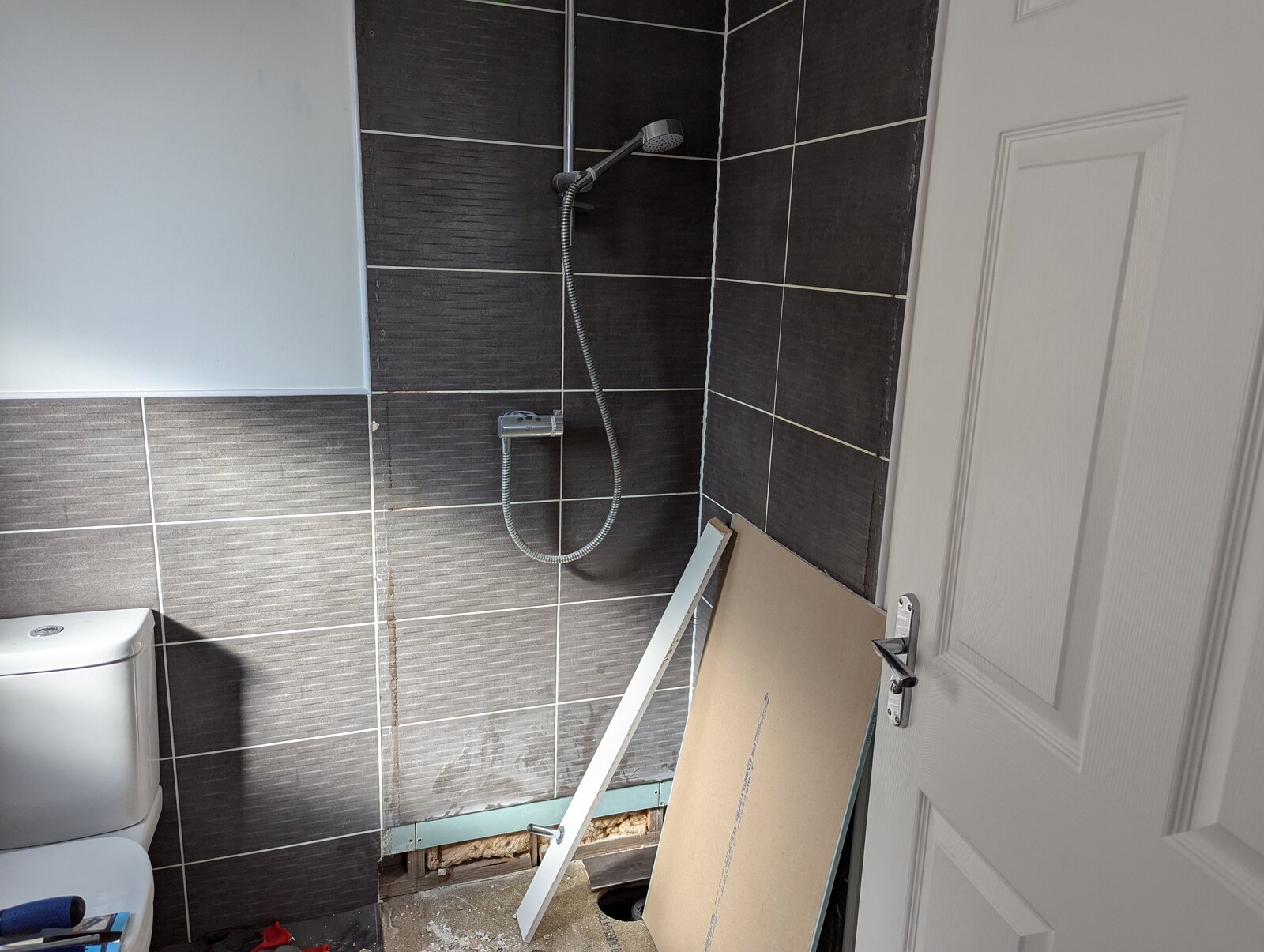

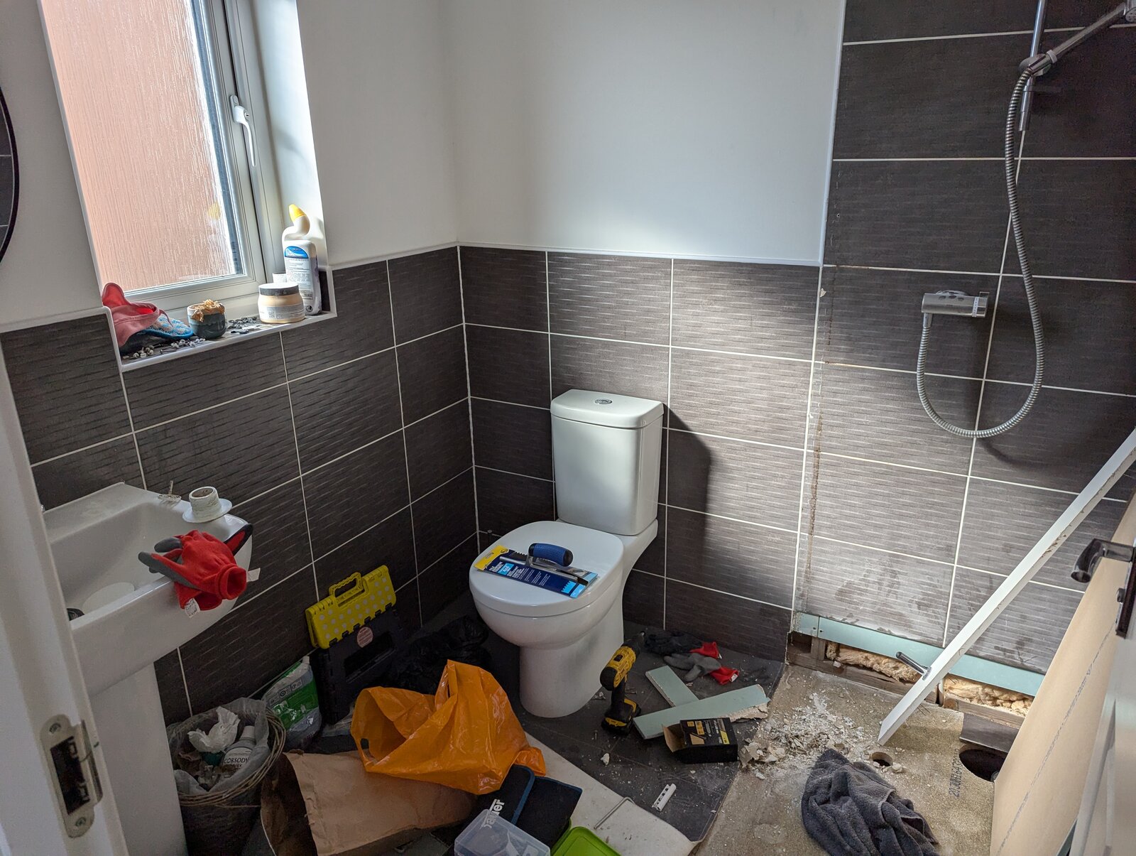

I'm about to embark on a renovation of my ensuite bathroom and would like to share some pictures of my ensuite as it is and get some advice.
A little bit of backstory as to why I'm doing this. It basically comes down to a leak, there was a small leak from my showers wastepipe under the shower tray and because the area is tiled, I had to rip out the bottom tiles to remove the tray and replace the wastepipe seal. While removing the tiles, a few of them broke/chipped and to no ones surprise the tiles are discontinued. So rather than patching it with a tile that is as close as possible, why not just rip it all out and start fresh?
Here is the space I'm working with:
As you can see it's a fairly small, typical ensuite you would find in your house built in the past 20 years. We practically hate everything about this space. We have never liked the tiles, the lino floor, the shower enclosuer, the basin, the radiator...literally nothing about it.

Oh I see. So you'd not move the toilet, but fully remove it and have the shower go all along that side where on the left (presumably where you enter) the window in the way? Can you move the plumbing over to the right wall and have the niche along the "long" side? That's pretty much the setup we have (including the window in the way) and it does not look bad. Works well IMO.
Yes exactly! We do not need the toilet and to be honest the flushing it at night wakes us up.

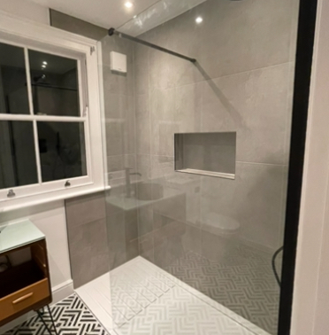

This is what it looks like now and we are very happy with it. Make sure to plan a nice looking tile layout with good center lines. As opposed to just starting with a full length tile on one side. All depends on your individual layout.
Ohhh that looks pretty darn close to what I had in my head! Luckily enough my drain is actually below the floorboards so I shouldn't have an issue there.
