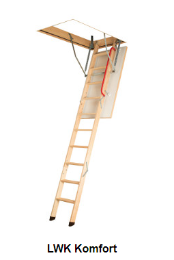

I've had this loft ladder fitted:
Currently I can stand on the top rung, and raise my left knee over the edge and onto a loft board. But if I board out the loft using the kit all the way to the hatch, I can't see how I'll get into the loft - it will be too high.
What's the best way to get around this?

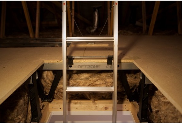

All of the pics I've seen online using the kit use a loft ladder that's attached to a joist inside and not to the loft hatch, like this:
You can't do it; that loft ladder isn't designed for a loft leg conversion. You need to work with the type of ladder that you're showing in the picture I'm afraid.
One of the reason that I never use loft legs.
You can't do it

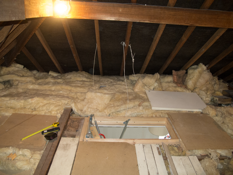

I've had a bit more thinking time since I posted the thread. What about a flat area before the raised area? If I screw loftboards directly into the joists immediately around the area around the hatch, then have the raised deck a little further away? Might give me some space to get up into the loft.
You only need to create a step in front of the ladders, not around the whole area, but essentially, the idea would work. Move the raised area back about 9", and you'd have a step to get up to the raised loft area.
I planned to do it at least to the the sides, mainly because the front is limited by a beam (old pic, before I removed everything):
Consider making yourself some sort of grab-handles, fitting between the raised floor and the rafters. Idea is that as you climb the ladder you move your hands from the ladder to these handles and keep climbing and eventually step from the top rung of the ladder onto the raised floor.
As been said, make an area straight into joists as a step in front of the loft ladder. If it's double insulated just remove one layer of insulation at that area.
So I've almost finished boarding the loft and am looking to make the stepped area.
The supports for the hatch sit about 10mm higher than the rest of the joists, so I have to avoid those ones. I was looking at adding some extra noggins in between the joists to support some cut pieces of loftboard.
Anything to watch out for? Or is it all fairly straightforward?
