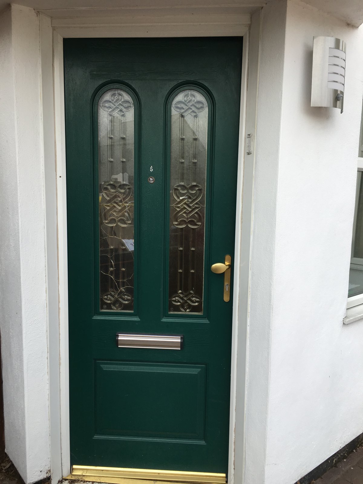

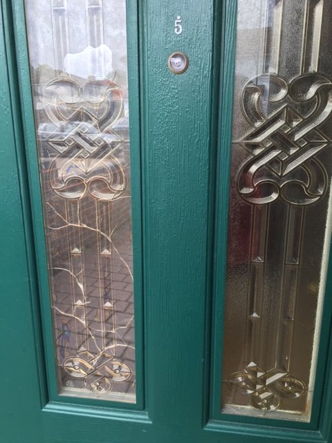

Hi Everyone,
I am looking for recommendation on where I can get the glass replaced and roughly how much it will cost.
It is on the entrance door. The glass has crack and every winter, the crack line gets longer.
I have googled around and most of the results are American. I will need someone in Southeast London or Kent area.
Thanks in advance

Might be cheaper and easier to change both panes of glass to a new style rather than match an existing.

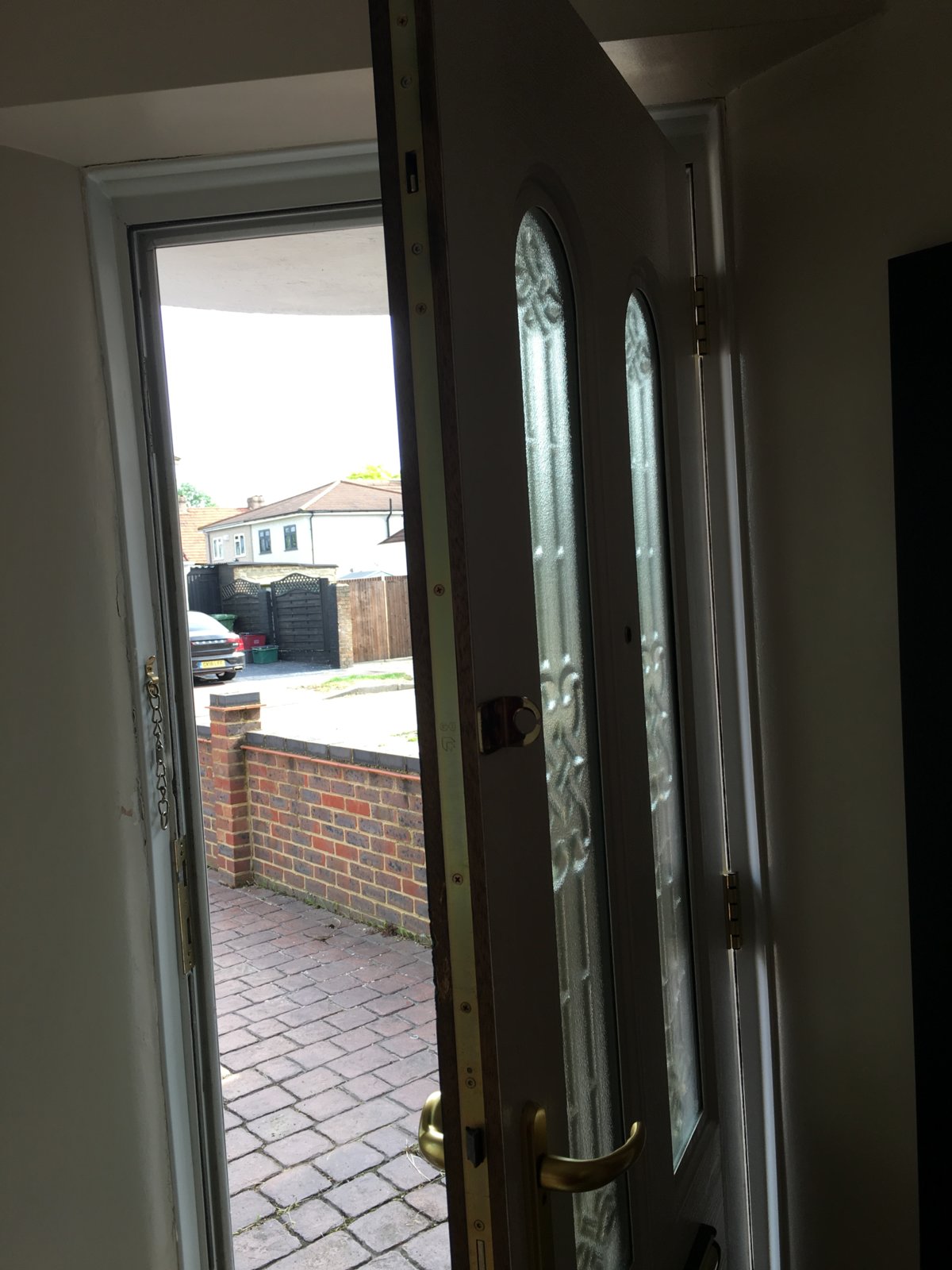

Do you know the make of door? That doesn't look like a standard glazing cassette arrangement, If its something like a Rockdoor you will need a whole new slab as the glass cannot be replaced
I agree with the suggestion to change both panes rather than have the hassle of trying to match the glass pane.
Not sure what the make of door is as can’t see any marking. I just can’t see how the panes can be taken out so knowing what my luck had been this week, I fear you may be right about changing the whole slab.
Fingerscross, I’ll get some glass and door guys to come and take a look.

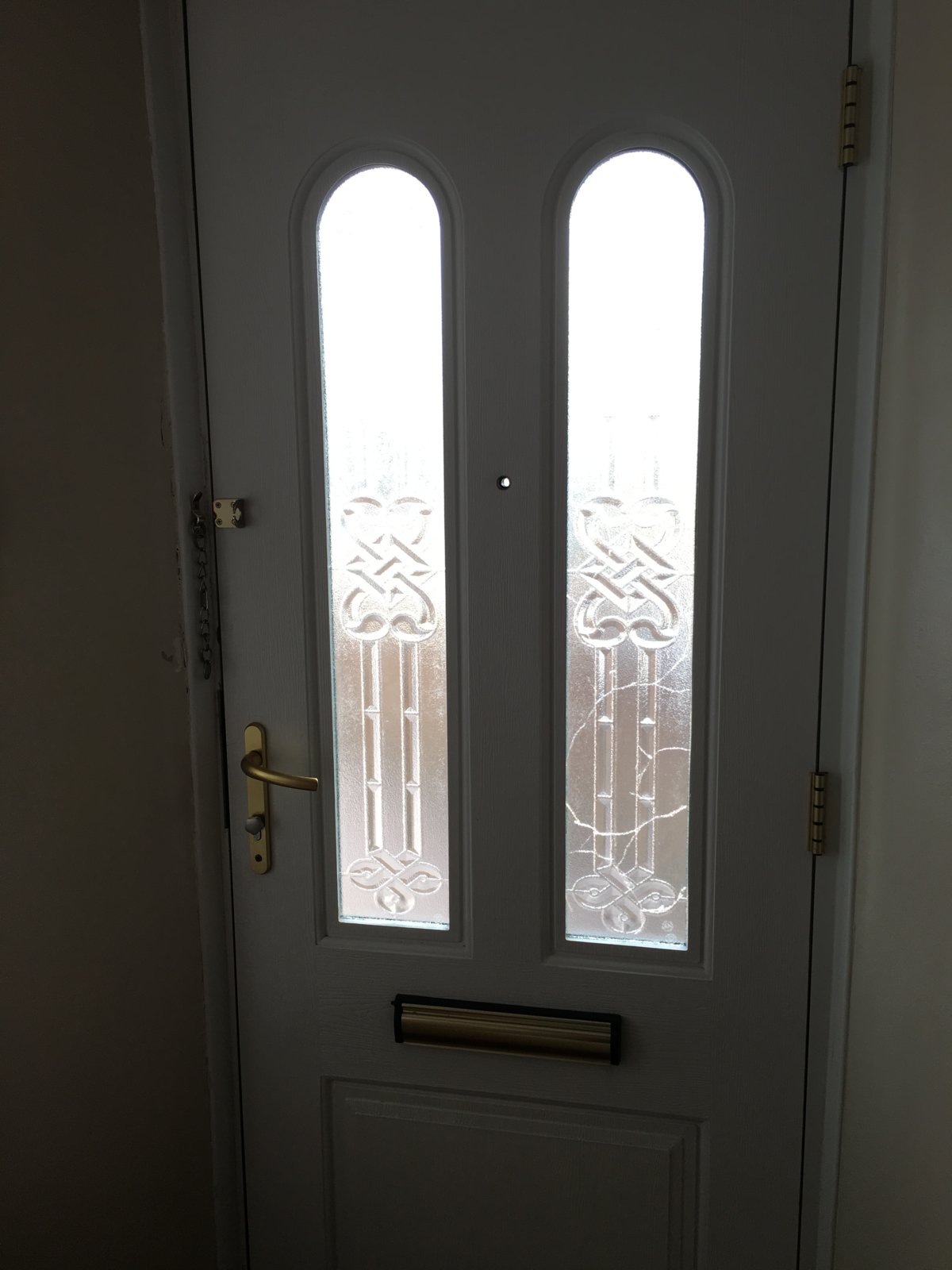

Only just spotted your internal pics, Looks like they are not replaceable to me.
