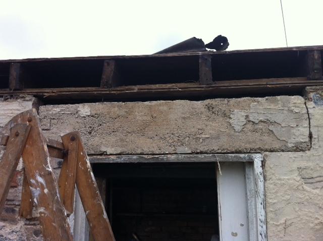

I'm planning on fitting an epdm membrane to my garage. I've done some research on how to fit it, the gutter edge and other edges but i'm not sure how best to fit new fascias.
Currently the fascia boards are simply nailed into the joist ends that are suspended across the walls. The bottom of the fascia boards are just about level with the top of the wall My issue is even with the epdm overlap on the edge its not going to come right down to the bottom of the fascia thus my concern is there is still some space for water to get in behind the fascia. I hope that makes sense!

Hello,
Pictures attached as follows.
This is a bit of an old photo the lintel has been replaced. I really just want to make sure I fit new fasica boards correctly. I plan to just nail them onto new joists, with a decent overlap onto the brick wall and flush with deck board when its fitted. I will then put a batton along for the epdm edge trim.
Is this approach acceptable? Also, what type of wood should I be using, i've been told to use marine ply and paint it but i'm not sure to be honest.
Hope that makes a bit more sense.
David.
When you say, what type of wood, do you mean the decking, ? if so use OSB T&G boards.
If you meant facias, you dont need timber behind the facias, unless your using cappit board.
If you are useing Permaroof trims, you dont need a batten on the gutter edge, the trim is designed to shed the water into gutters.

Yes, im using OSB for the decking. It was choosing timber for the actual facias I wasnt sure on. The gutter is along the end of the garage.
I'm intending to get my epdm from rubba seal, and use the trims they supply with it.
