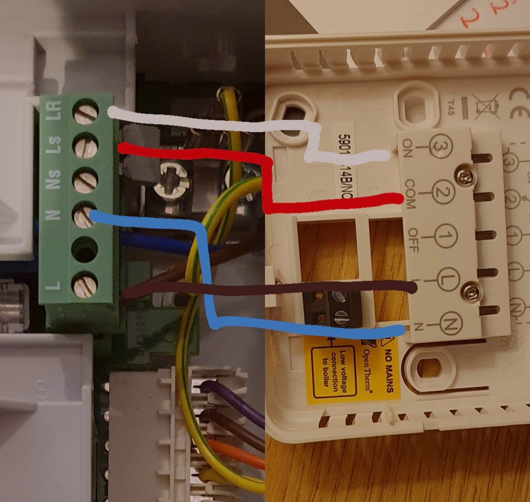

I've looked through past forums but I'm not totally convinced I've found the correct answer (possibly by 'merging' forums in my mind but I'd like to be sure).
Does this diagram look correct?
no that is wrong
Boiler Controller
L&N to L&N
LS to 2 COM
LR to 3 ON
No links anywhere
To confirm, is this adjusted diagram now correct?
