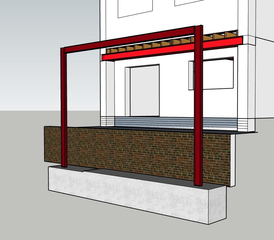

Hello,
I have a steel goalpost to put up and I was wondering the best way of doing it. The complication is the uneven ground around and that the vertical columns are 4m tall, 203x102UB23 steel. The verticals are 100kg each and the horizontal is 140kg.
I was thinking either:
1. Lift the verticals into position, chemfix into the concrete at the base, then genie lift the horizontal steel into position then bolt to verticals.
or,
2. Bolt it all together then raise the whole construction up and chemfix the bases after.
Steelwork is new to me. What's best with minimal manpower?
Thanks.

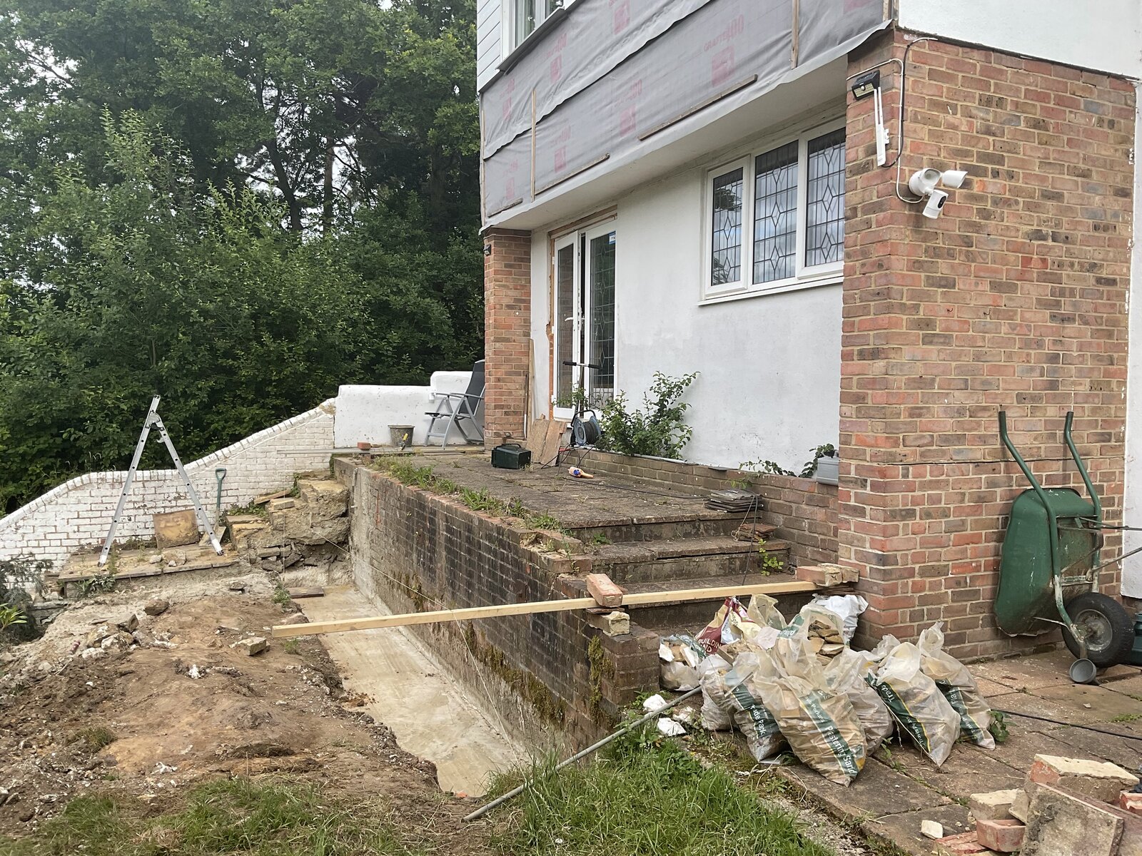

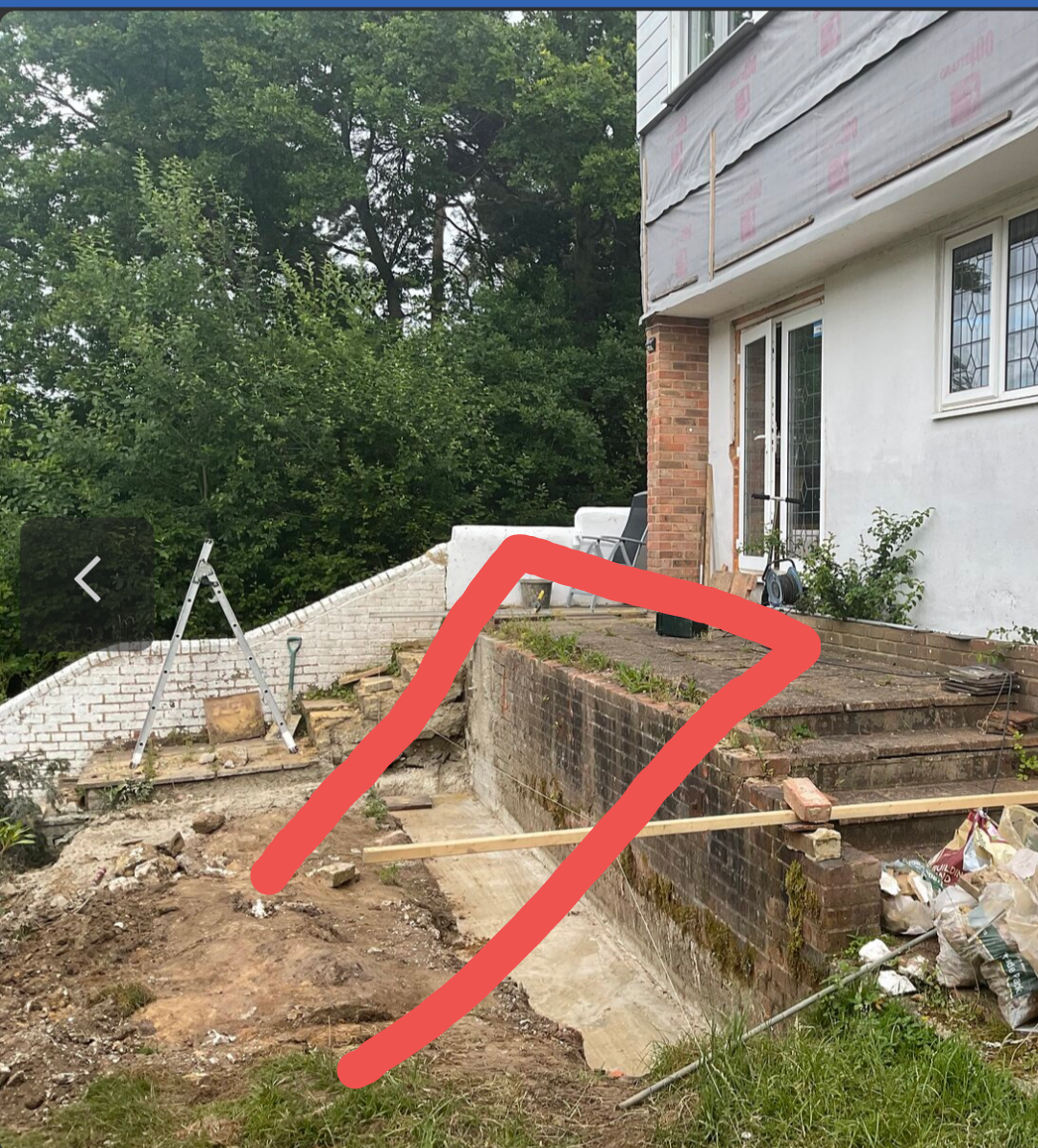

Here's the location:
Here's what I'm trying to do:
I'd assemble it into the position below and get a few helpers round to tip it up and walk it into position:
Wouldn't Health & Safety have something to say about that? If its 4m high, that's a lot of weight above head height?
As cdbe says, erect it in the position he has suggested but I would put the verticals into the foundation channel, so it is already partly erect.
Get 3 mates on the patio to start lifting and 2 others down below to push the verticals backwards and upright.
Jam some wooden braces against the uprights to hold it in place while you cement into place.
