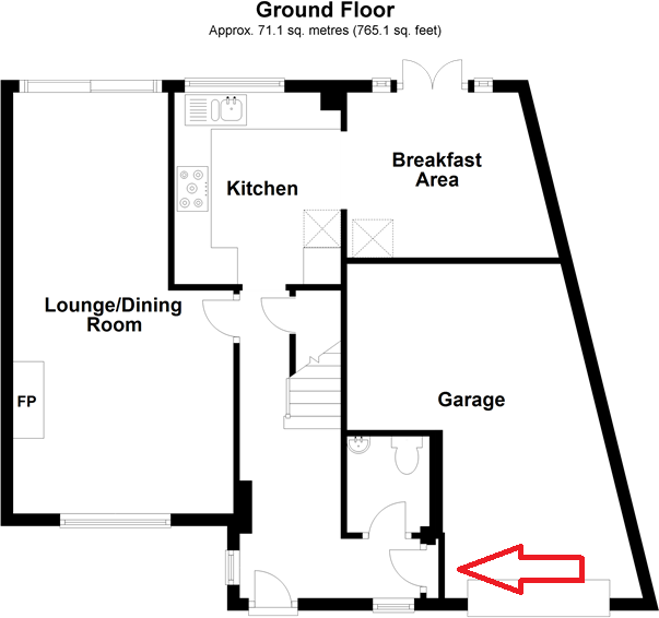

Hi all,
I hope you are well.
Wondered if someone would be able to give me an estimate to knock through an internal wall and add a doorway to an attached garage?
The property was extended some years ago and looks like the old doorway was sealed and turned in to a small cupboard (see attached floor plan). The wall behind it feels like solid brick.
Hoping to add a door so I can use the garage without having to raise and lower the large door all the time.
Many thanks,
Charlie.
I believe you will need a fire rated door, building control approved. A suitable (existing) lintel above the old door will save on costs. It depends where you are in the country but I would guess between £800 and £1.2k plus materials in this scenario. More if a lintel is needed, maybe also a step down into the garage, all add to the cost so get that sorted upfront. The challenge would be to find a reliable builder/chippie given the very high demand for services atm.

Can you see the brickwork from inside the garage? If so take a picture on of where the door was, and post it.
