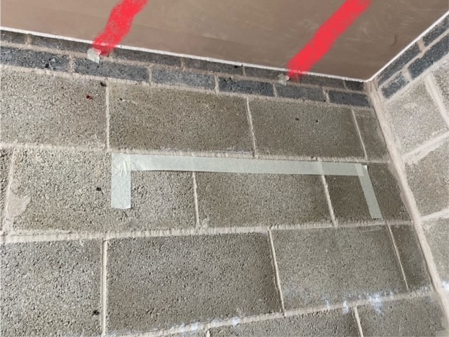

Hi, I'm knocking a doorway through from our garage to kitchen foor a 700mm door. The wall is internal, 100mm single block thick, no cavity and supports the joists of the bedroom above - see picture, joists marked up in red, position of door marked out with tape. I'm looking for some advice on the lintel - will a prestressed concrete lintel with the usual 150mm bearing be sufficient given the positioning of the joists?

Looking at the (composite) way it will be loaded I'd say yes, it'll be ok.
