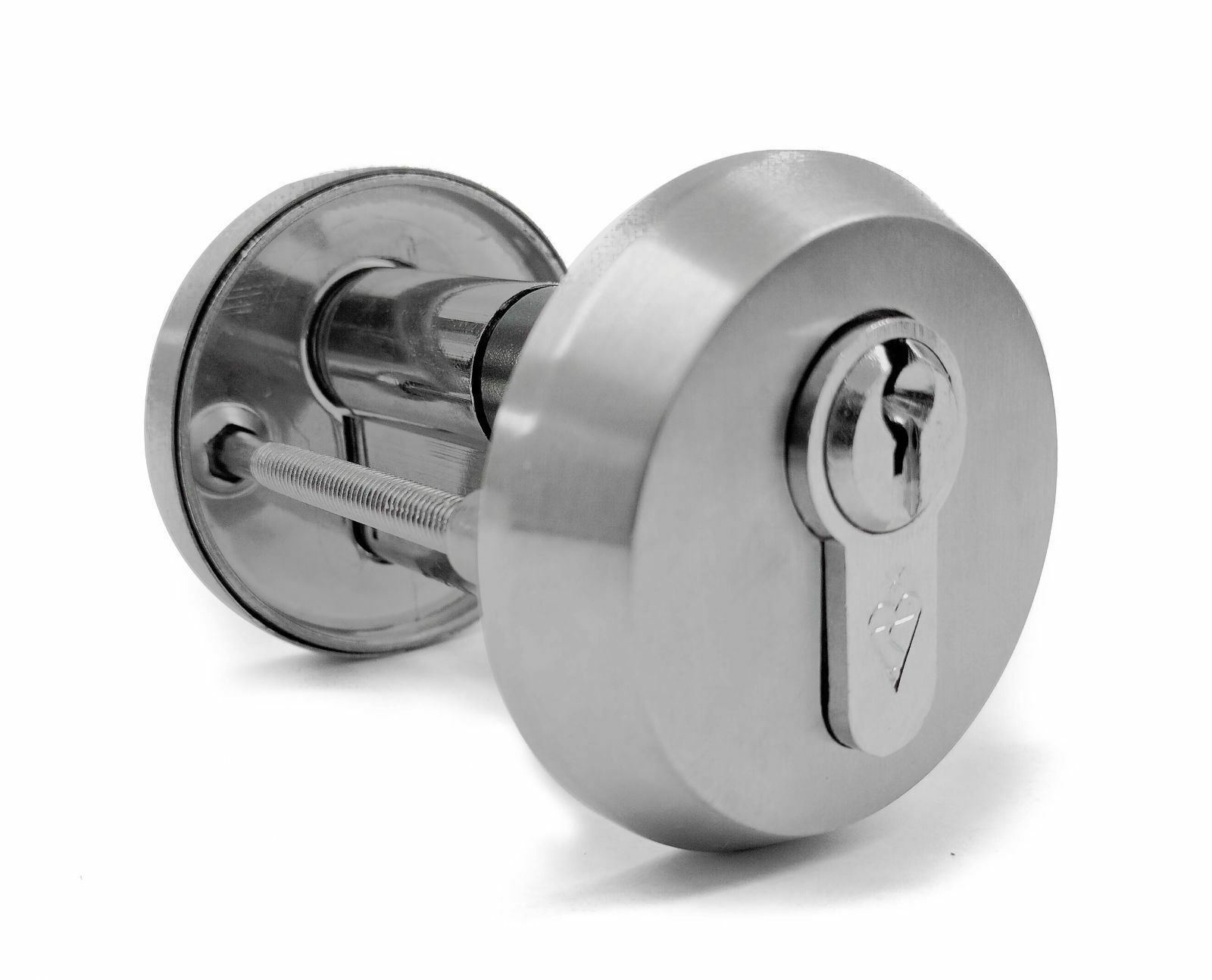

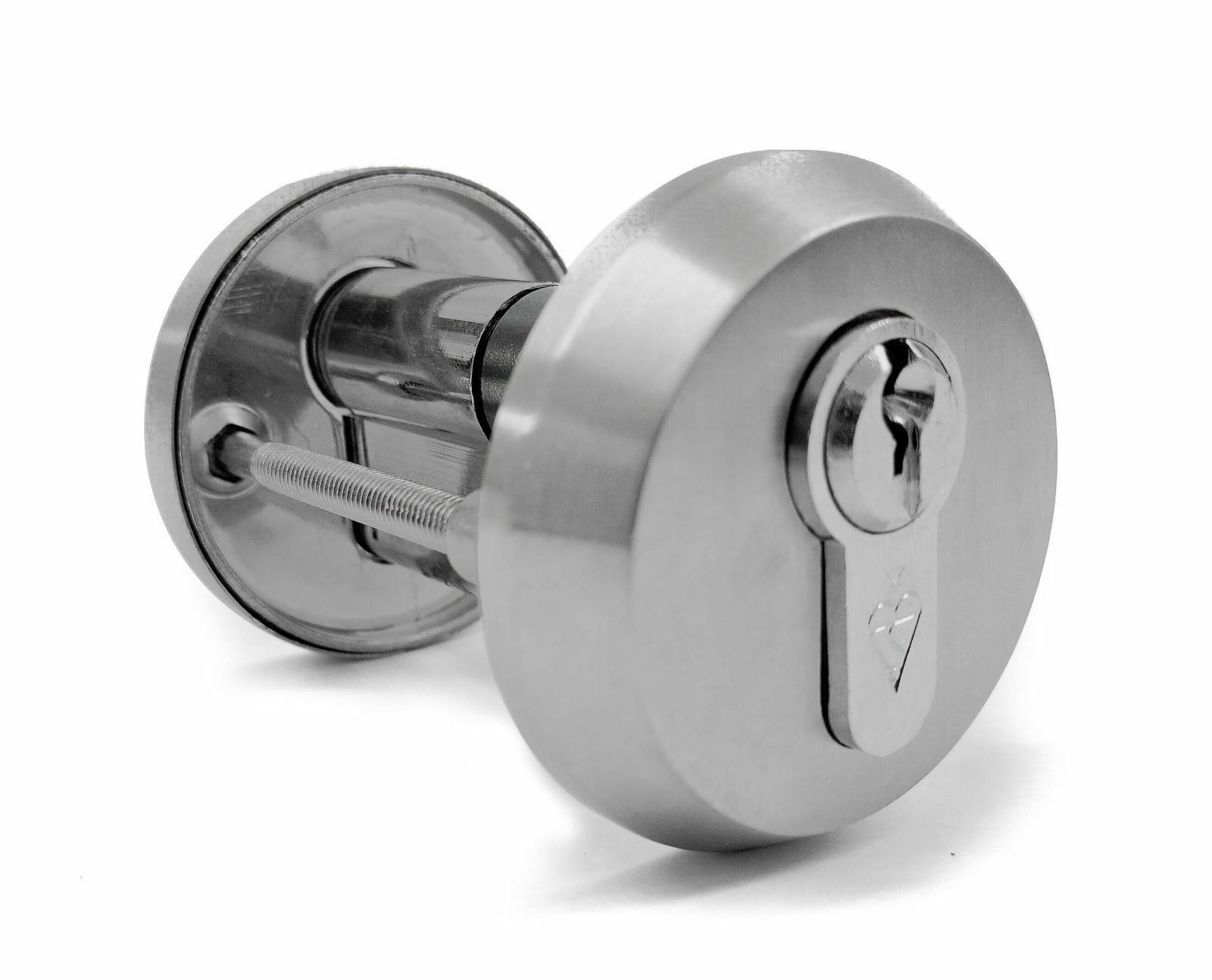

this is an example of a Kickstop Lockguard but there are others.
The screwholes are only on the inside of the door, they bolt-through to the outer plate
It gives some reinforcement to the door as well as protecting the cylinder.

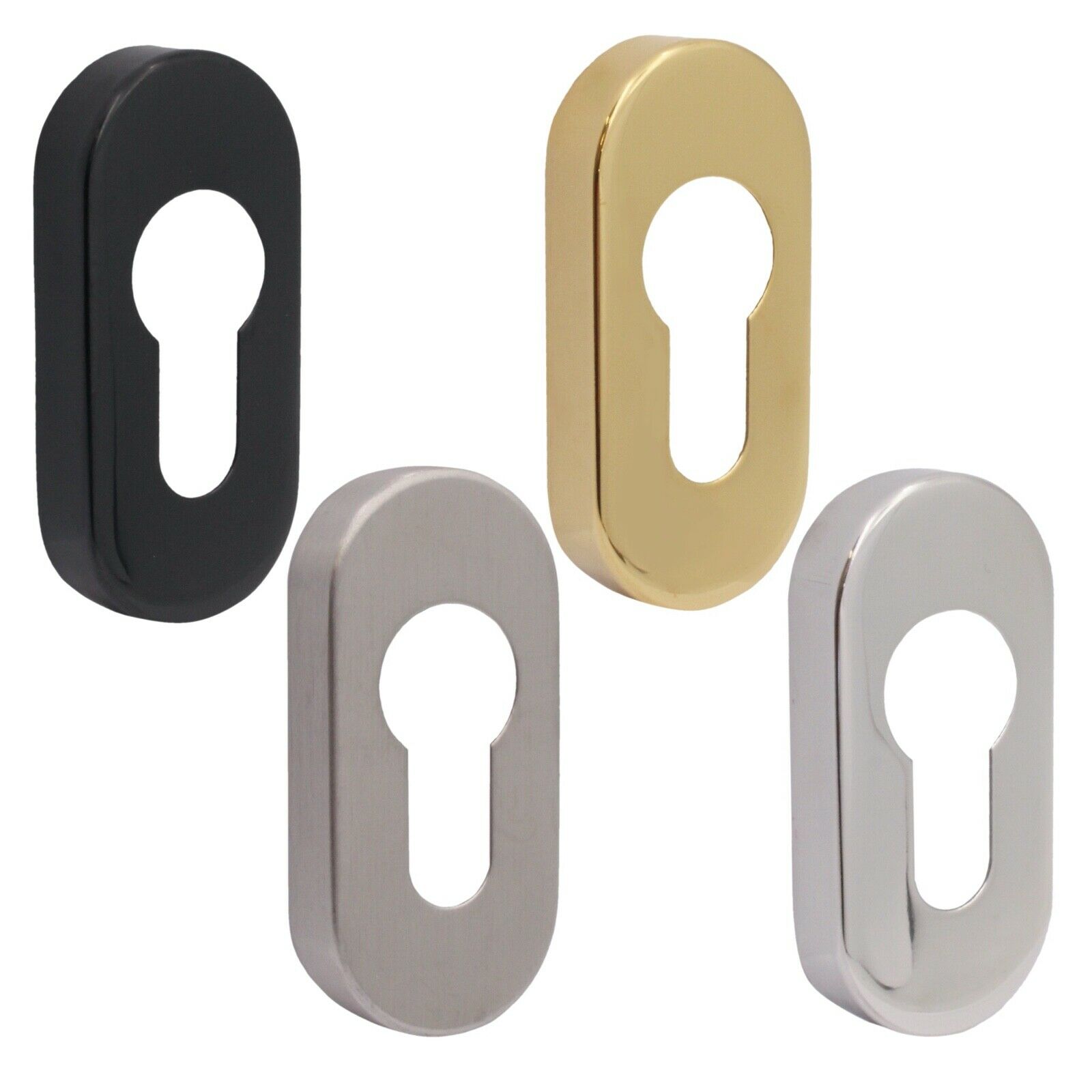

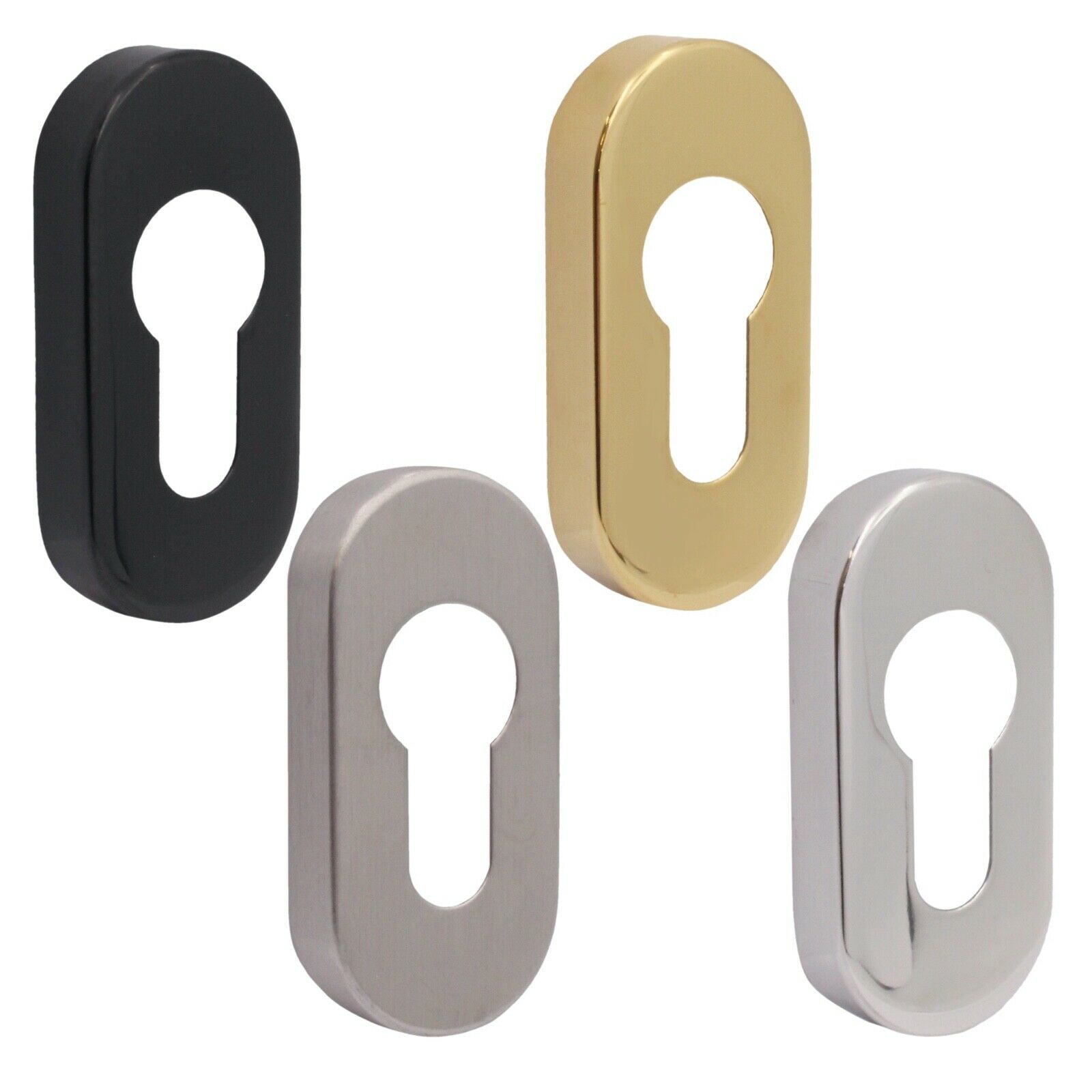

you could just fit a Eurocylinder escutcheon? A bolt-through is stronger than a surface mount.
