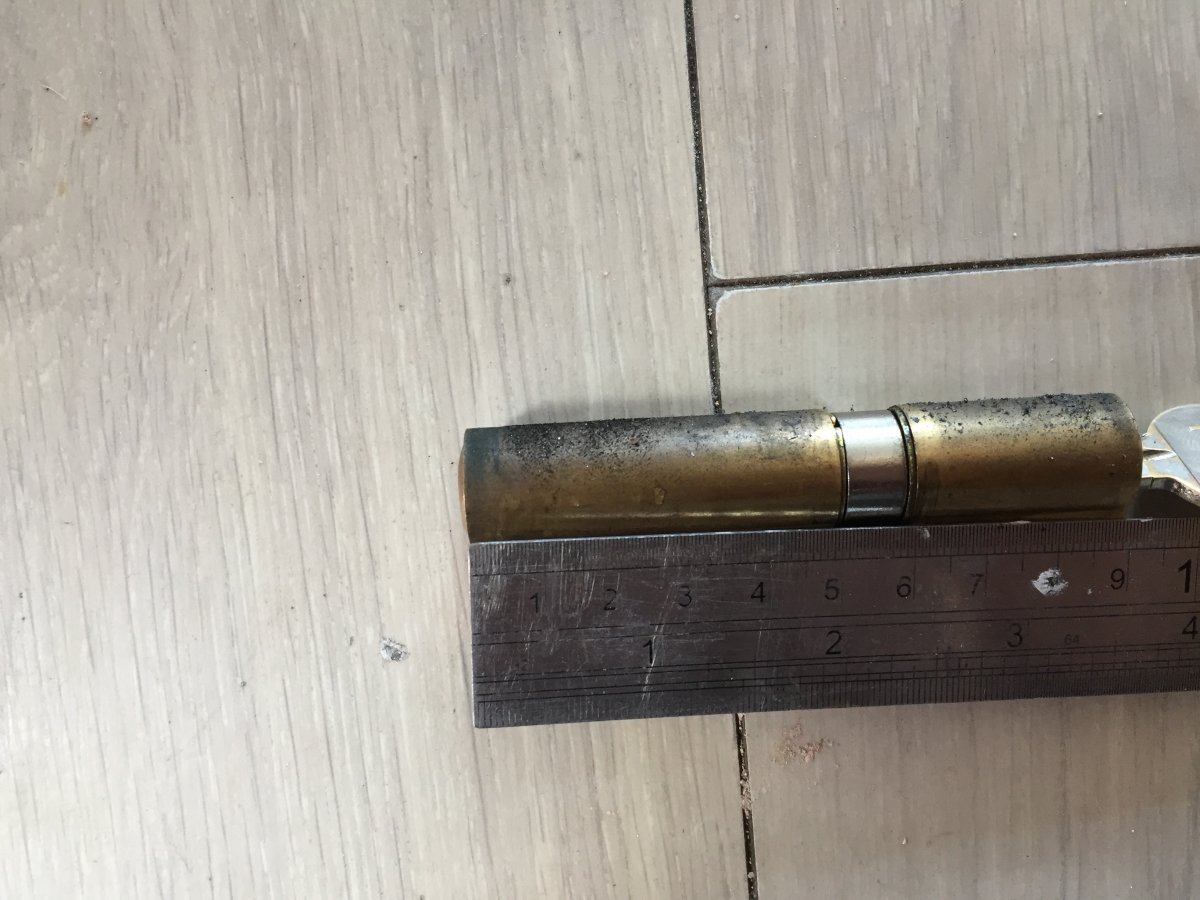

I need a new eurocylinder, but not sure which size to get.
I went to screw fix today and the only fit for this was a 55/45. Making a 100mm size overall.
My cylinder is 90mm overall. So i need a 55/35.
Do they sell this size or is the 55/45 ok, meaning the lock will stick out a little more on the inside.
show us the old one in the door, to see how much it projects inside and out with your current handle.
