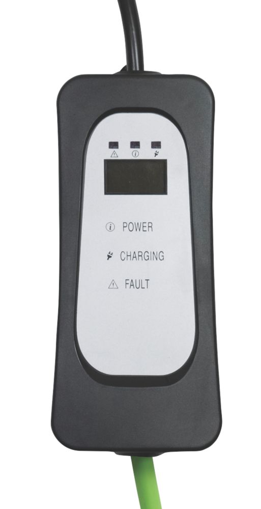

I have looked at 10 amp chargers
ae235
there is a box which clearly does something, maybe this does what is required to make it safe? What we need to know is what is in that box, and I don't know.

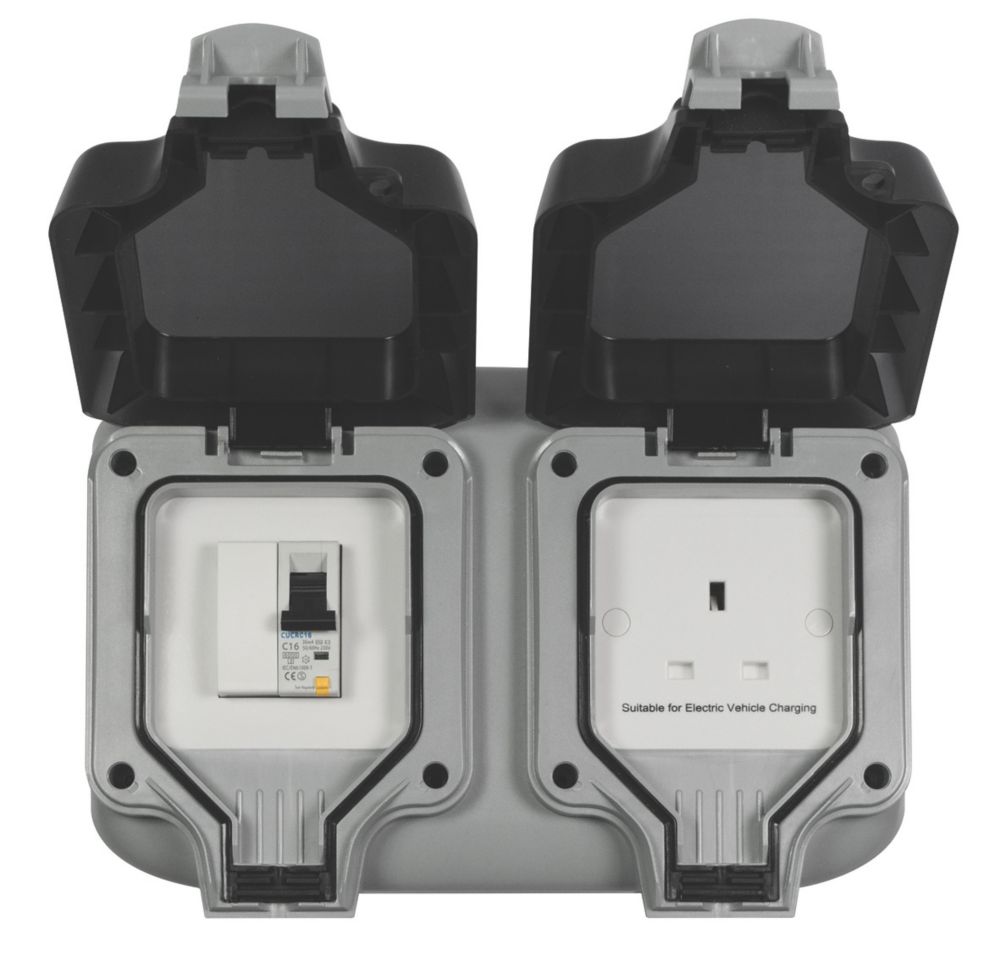

The problem as I see it is items offered for sale like this
ae235
it has a socket and a RCBO why it has a RCBO fitted I really don't know, as the instructions say it must be fed from a type B RCD, see data sheet I think it is misleading where it says need a type B RCD and a type B RCBO is fitted, it does further down say the type B RCBO is a combination of two functions, a type B MCB and type AC RCD. Which seems daft as it also states you need "Type A RCD and appropriate equipment that provides disconnection of the supply in case of DC fault current above 6mA or Type B RCD" so type AC is no good.
So in real terms the socket shown is an expensive bit of rubbish.
ae235

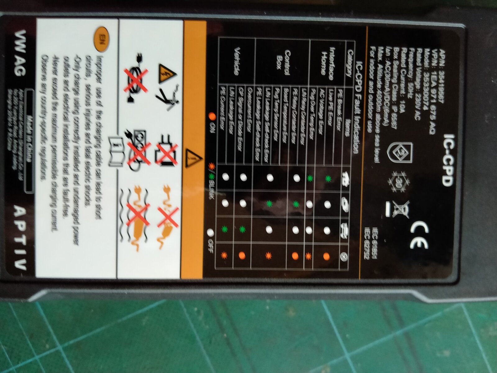

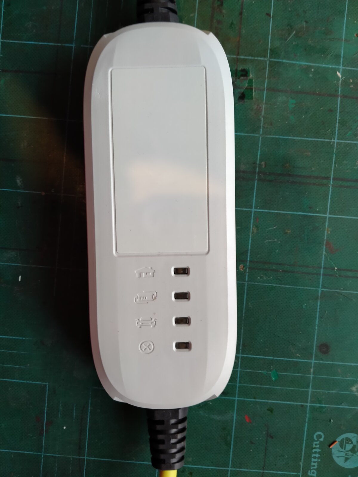

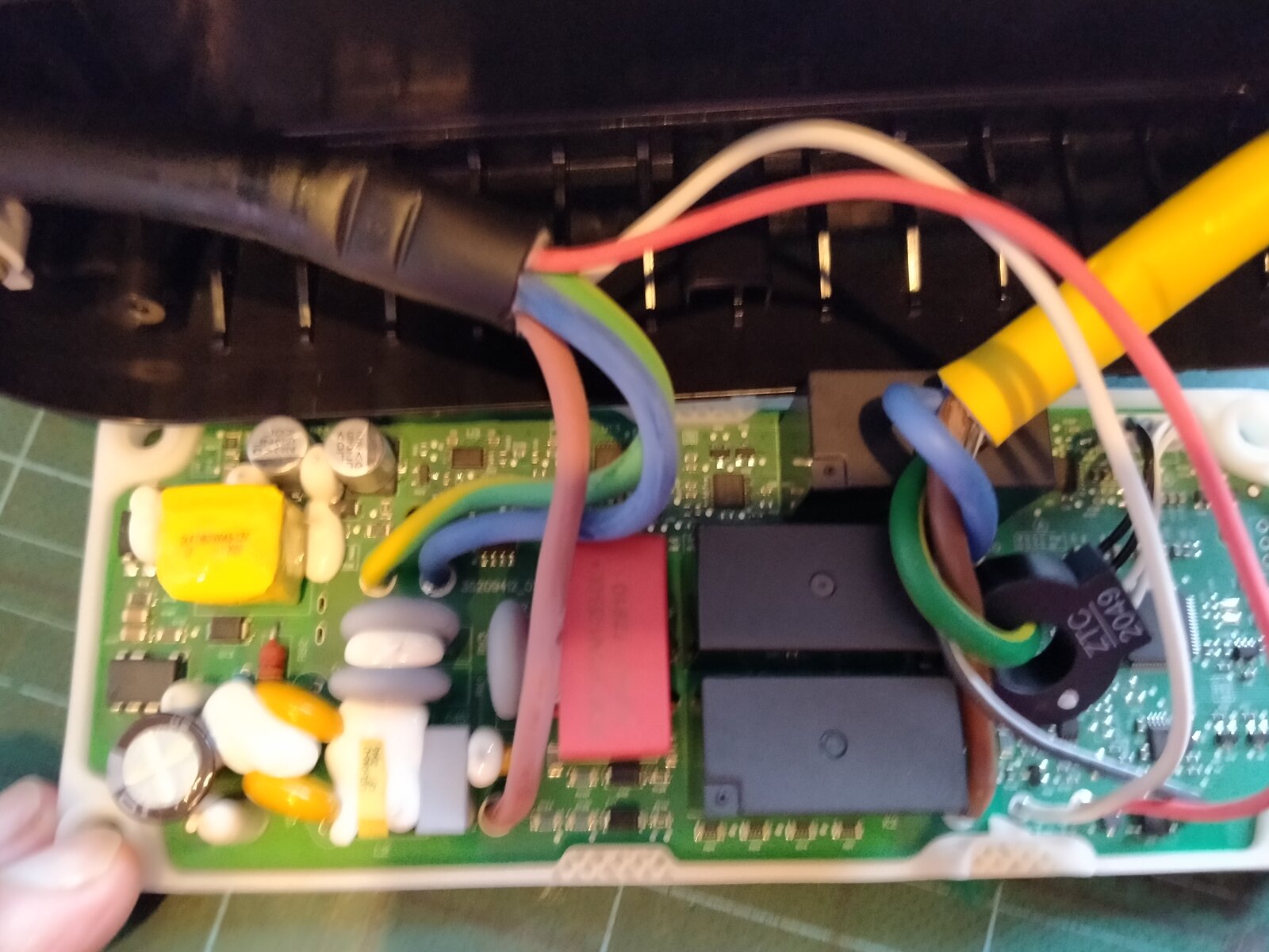

Your wish....
Note the toroidal transformer around the incoming CPC. Also 3 chunky relays. If you look at the rear label, you will note that it has 30mA AC and 6mA DC IΔn protection.
