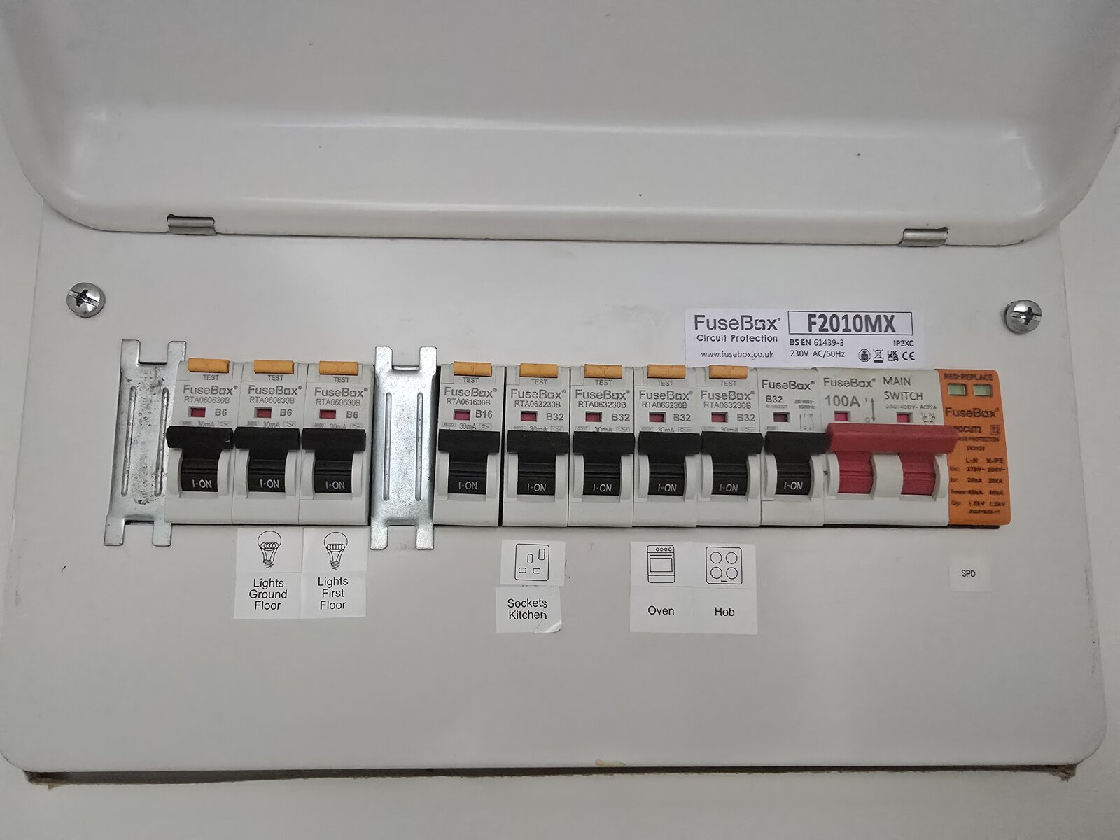

Hi,
I don't plan on getting a full EV, but do have plans to get a PHEV with a 33kwh battery, which using a 7kw charger would be enough to have the battery charged overnight everyday. I won't be fitting it myself but wanted to check if it was feasible to add a dedicated circuit to power a 7kw ev charger. I would like to have the cable routed through uninsulated cavity between by ground floor ceiling and first floor boards.
Thanks in advance.
Yes, will need a suitable RCBO installing into one of the empty spaces.
However if you go to the usual bandwagon box slinger types, they will probably insist on installing an entire new consumer unit just for the charging.

Thank you for the advice. Im not sure i follow the usual bandwagon comment? Also why is a PHEV a bad idea? Most of my driving is 20-30 miles and I don't want an EV for the longer runs.

Yes, that's very true. Given my next car is a 4 year lease, I'm happy to go down an intermediate route by having a 7kw charger running off my CU and in the future when I have my driveway done, bury a cable that can we used for a future high powered charger in case I go down the full EV route. As im renovating now, I have rhe option to run an internal cable to power a wall charger for the PHEV
