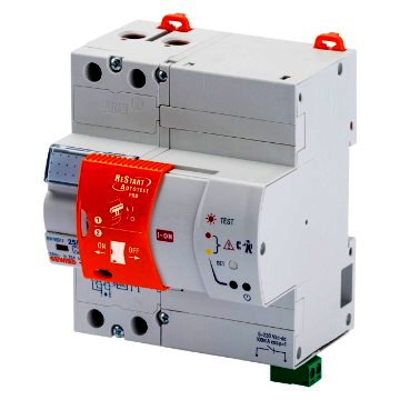

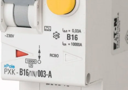

I know for experience a 30 mA RCD can test as compliant, but will trip on a regular basis, and it can be replaced with another one which tests as being compliant, but it does not trip. And we in early days had auto resetting RCD's temprcd.jpgand also RCD's with a warning getting near to tripping stage, X-pole.jpg the X-pole who's name causes problems when trying to look it up on the internet. I know a 10 mA RCD MK socket when you pressed the test button would take out the 100 mA RCD in the main board, and from my return from the Falklands I found RCD's caused a lot of problems, many down to not switching neutrals, we had type S from early days, but the type AC, A, F, and B are relatively new, only seen them in the last 20 years, and the whole idea of RCD's has changed the way we test, again early on I found the strain on the cables could affect their performance, so they need testing after being installed, this means to test a RCBO is a small problem, as how can one remove the load?

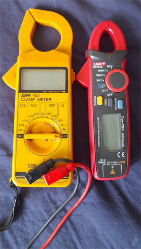

The result was a new meter, Clamp-meter-small.jpg my old trusted meter to the left had been good enough when I got in in Hong Kong before the take over when working there, but as time went on, I realised the 0.01 amp resolution was not really good enough, and also now we needed to measure DC amps, meters like this 1723491826878.pnghad been good enough for years, if the car charged at 15 amp or 50 amp it really did not matter that much, it was the voltage we were more interested in, so the old hold on ammeter was good enough, but no way can they measure 6 mA so it was time for a new meter, 0.001 amp resolution, and AC and DC amps, the AC amps range great, but the DC was a little hit and miss, and for years we have had units which will cause DC to flow, the three port central heating valve as an example, not looking at fault DC current, they were designed to use DC to stall the motor in the centre position.

My solar panels produce DC, my immersion heater uses pulsed DC, (iboost+) the switch mode power supply not only uses switching, but also uses high frequency transformers and DC at mains voltage. The LED bulb also in some cases uses switched mode control. The 13 amp socket and plug my look the same as when invented at end of second world war, but even that has evolved. We now have a problem with bidirectional and unidirectional MCB's, RCB's and RCBO's and nothing once installed to show which they are, the details can't be seen with the CU covers in place.
