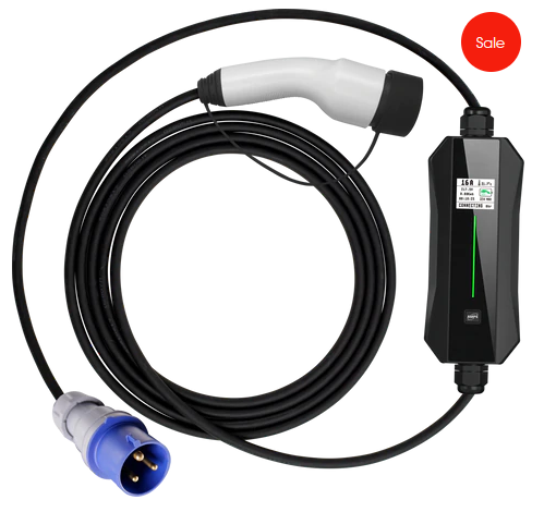

I have to agree with you. I looked at plug in chargers, this
cost £270, plugs into a 32 amp socket, charge rate selectable 8A, 10A, 13A, 16A, 20A, 32A I personally don't like the idea, far better to have a dedicated EV charge point, but this does show how cheap they can be.
No details saying if 6 mA DC trip, loss of PEN trip, if built in RCD or not, seems loss of PEN rare, but built in RCD and 6 mA DC detection reasonable standard.
So with a TN-C-S (PME) supply there are basic three options, make the supply TT, use a small earth rod as a reference point, or have it auto disconnect if the voltage is not within 207 to 253 volt. The latter seems an easy way out, the supply is 230 volt +10%. / -6% and the volt drop in the property is limited to 5%, so voltage has to be 205.5 to 253 volt.
So a 47.6 volt window, but loss of PEN will only cause over or under voltage if not balanced, it could with the multi-earth rods stay within the limits for a long time, and of course the reverse a local solar panel could tip the balance with over voltage, and machinery starting could tip the balance with under voltage.
