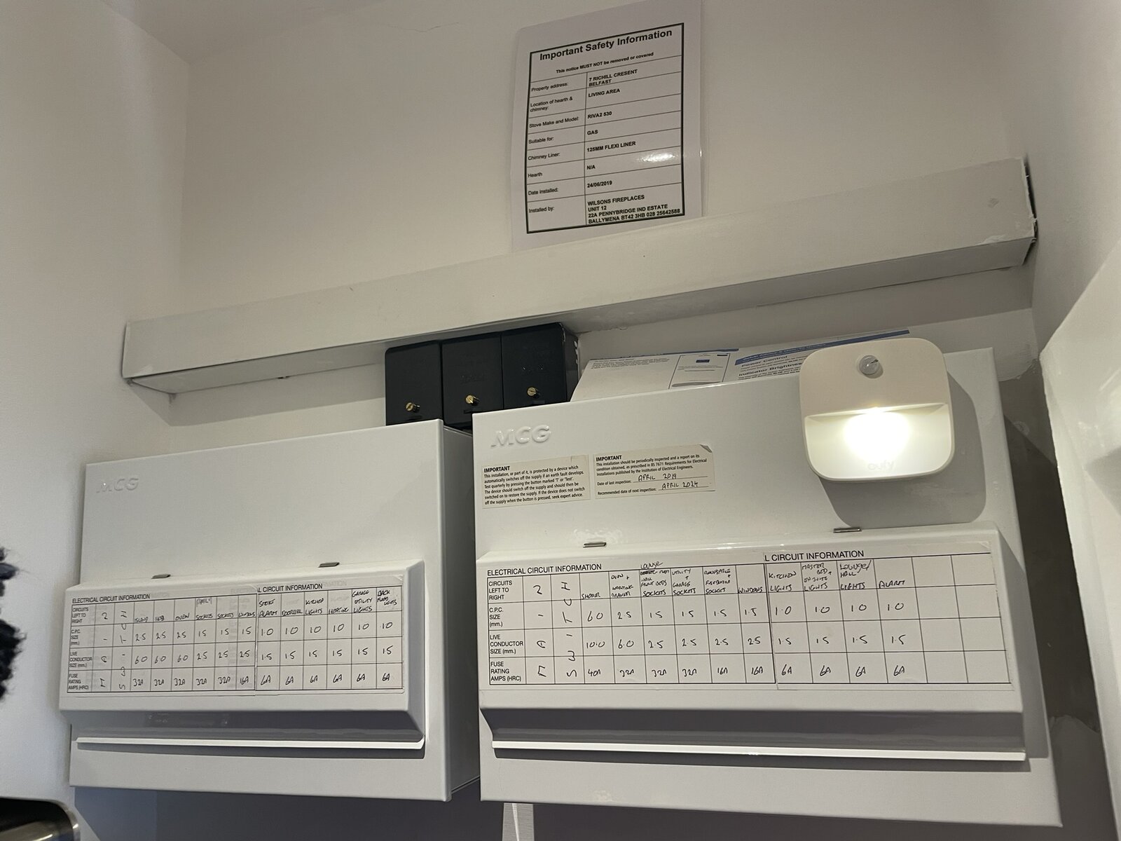

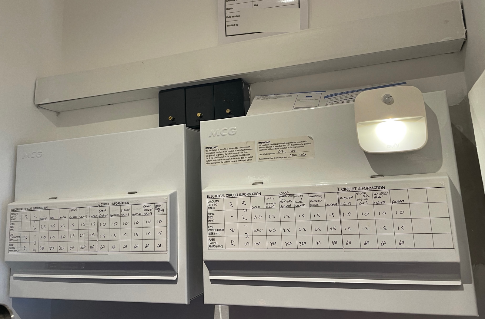

Not sure if these photos help.
The incoming tails are inside the stud wall and enter that square horizontal conduit. They then connect in to the henley type connectors then each split goes back into the wall and down to each CU.

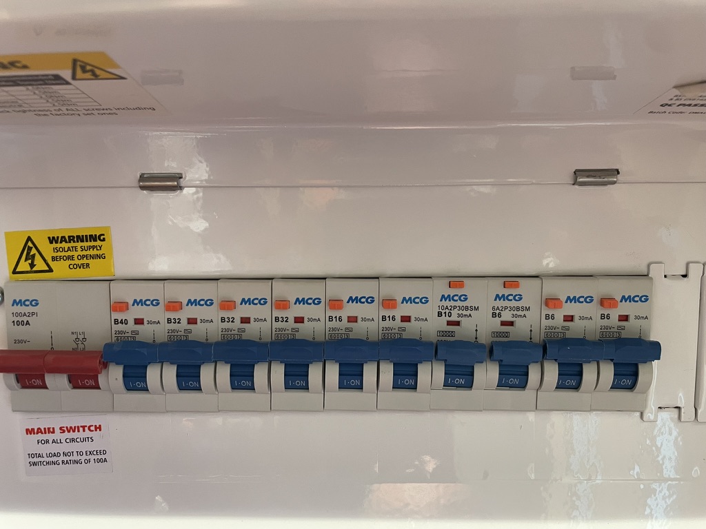

The right CU has spares and is shown below. Doing a quick search shows that MCG RCBOs are still available.
It MUST interrupt all live conductors though, so a suitable device may not exist. (I believe MCG do manufacture these in a single mod format, but whether they're compatible with the other devices or not I wouldn't be certain off-hand.) Also a surge arrester would be advised.
Thank you. So maybe the conversation I should be having with the installer should include duscussing having an additional separate CU for this and including a surge protector.
