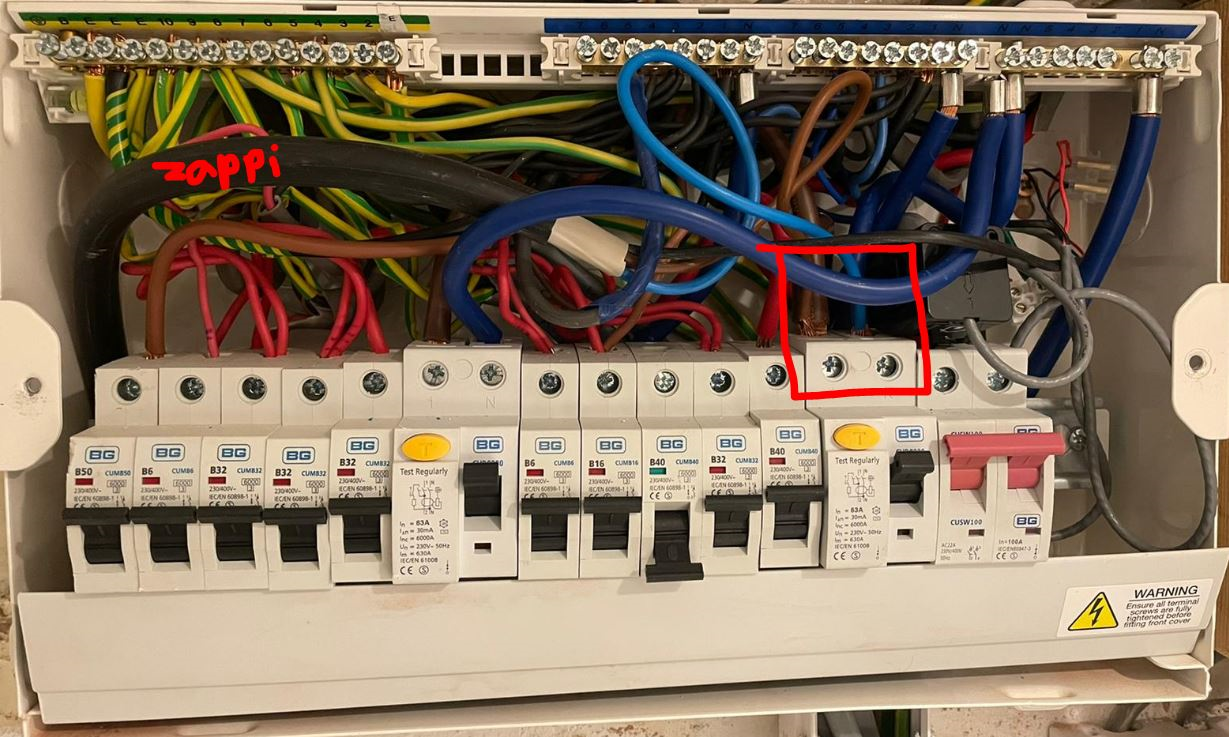

Can't find in the BGB (I know we've moved on from the BGB, I haven't got the latest yet).
Have you a shot where the SWA enters the Board at the bottom?
Was this done with an OLEV grant?here's a photo of how the 'installer' left things.... still waiting on a reply from the company....
Is it SWA, looks like NYY-J to me, or do I need glasses?...
The terminals aren't rated for 90 degree operation though.No seems Multicore armoured 90 °C thermosetting insulated cable 4 mm² rated 49 amp. However it does seem Zappi call for a 32A type B so still too big.
