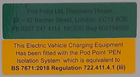

EV charging is this TT or not, and within 1 meter of metal building is it safe?

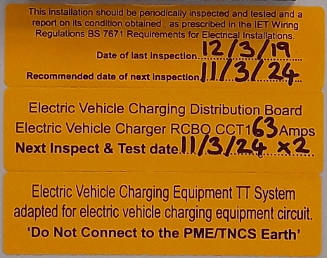

I don't understand, if using a TT supply why does it need a PEN isolating system? The box EV-DB-Railway.jpg is connected to a bus bar chamber so can't see how the enclosure is not connected to the PME earth, the building is metal, and has three independent supplies to the building, originally a set of start up units, likely built by the council, but has been all owned by one company well before the company I work for bought it, the cost of removing two of the supplies was silly, so seemed a better idea to use them, other than being given money for the charging point, the company has nothing to do with the charging point, they did not install it. That was done by the company who manages it.
But the two labels don't seem to match up, if a TT supply why does it need a PEN isolation system?
I don't understand, if using a TT supply why does it need a PEN isolating system? .... But the two labels don't seem to match up, if a TT supply why does it need a PEN isolation system?
I agree that it doesn't make sense - I would suspect that one of the labels (probably the one which mentions TT) is 'incorrect'.
Mind you, it's potentially a bit confusing since, even if one uses a TN-C-S earth and a "PEN isolation system", then one pressumably still needs an earth rod of some sort, since, as one would expect, the reg in question says:
(iii) Protection against electric shock is provided by a device which disconnects the charging point from the live conductors of the supply and from protective earth in accordance with Regulation 543.3.3.101(ii) within 5 s in the event of the voltage between the circuit protective conductor and Earth exceeding 70 V rms. The device shall not operate if the voltage exceeds 70 V rms for less than 4 s. The device shall provide isolation. Closing or resetting of the device shall be by manual means only. Equivalent functionality could be included within the charging equipment.
... and the only way it can know the potential between PEN and earth is >70V is presumably by having some sort of earth rod, isn't it?

Since a metal building with three independent supplies it seems very unlikely the earth would be lost, but from the fact the building is bolted to earth and there are three independent PEN's coming into the building, so in real terms no problem.
However the board with the notice on is connected to the bus bar chamber with a barrel nut, so seems highly unlikely it is not earthed to the bus bar chamber, and the supply leaves the board with a standard SWA gland.
I would think the notices refer to the charging pod, rather than the board they are stuck on, it seems the safety officer has the keys to reset the pod should it trip out, he is also an electrical engineer/electrician so highly unlikely he would have made an error, but it still seems odd to have the two notices on the same box.

I would think the notices refer to the charging pod, rather than the board they are stuck on .....
One would certainly think that in terms of the left-hand one of the notices you posted, since it refers to a "Pod point 'PEN Isolation System' ".
