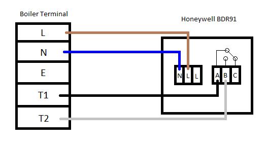

Just bought a new build house that is fitted with a Baxi Neta Tec combi boiler. The central heating system has been designed to current building regulations so has 2 zones (upstairs & downstairs). The system was controlled by two danfoss Tp500 and two zone valves.
I have since bought an evohome base pack and a Hr92 for all radiators in my house (now to become a 9 zone system). I have removed then danfoss Tp500's, set the two zone valves to manually open. I have removed the link from the boiler to the tp500's and the zone valves. I now have a link from the adjacent spur to the live, neutral & earth terminals on the boiler. I have then installed a 5 core cable as shown in the attached picture.
Please could you confirm this wiring set up is correct? I have factory reset the evohome controller and bdr91 then bound them together. Signal strength is excellent but the evohome controller wont activate the relay. When i select heating off on the controller the green light stays active.
Any help would be much appreciated.
