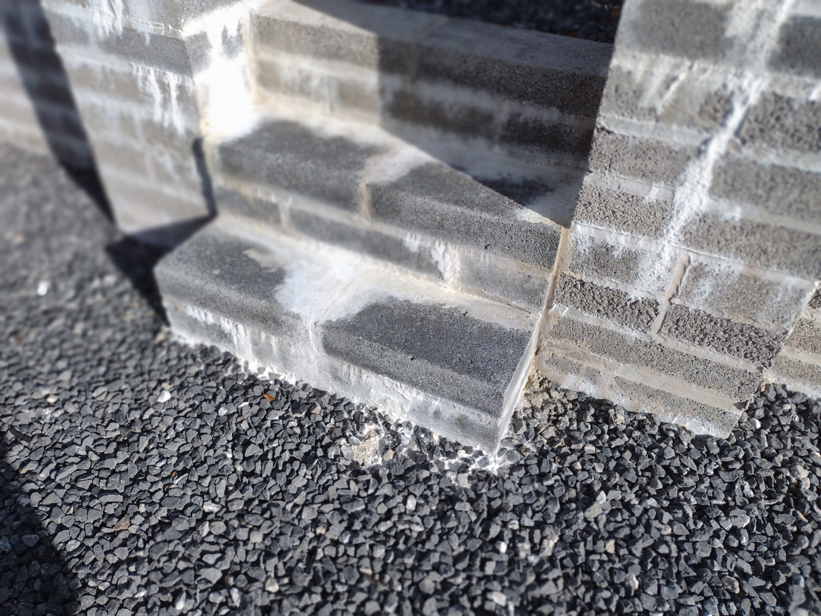

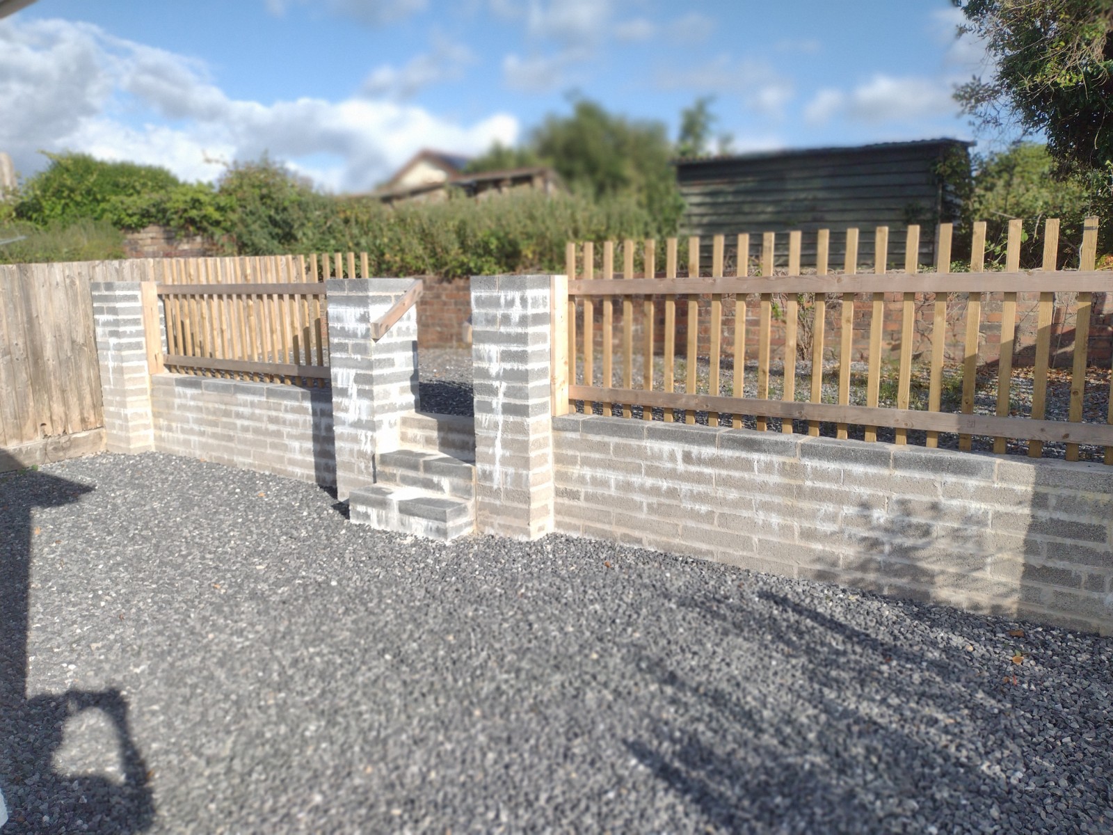

My friend went to look at a newly renovated house on friday and in the back garden they have built a retaining wall out of concrete blocks, laid flat, approx 6 courses she said and they are leeching a ton of what looks like salts all over them! Quite thick in places and, at the steps, its all pooled with white residue!!
Wish she had taken some pics!
Any ideas? Salts?
Easy to remove and cement over etc?
Retaining wall? Probably due to groundwater.
No point in painting it or trying to clean it off.
OOI, is this in a hard water area? If not, it may eventually weather away.
Couple of pics of said wall and steps taken today:

It washing out from rain, in your pics, out of the mortar
