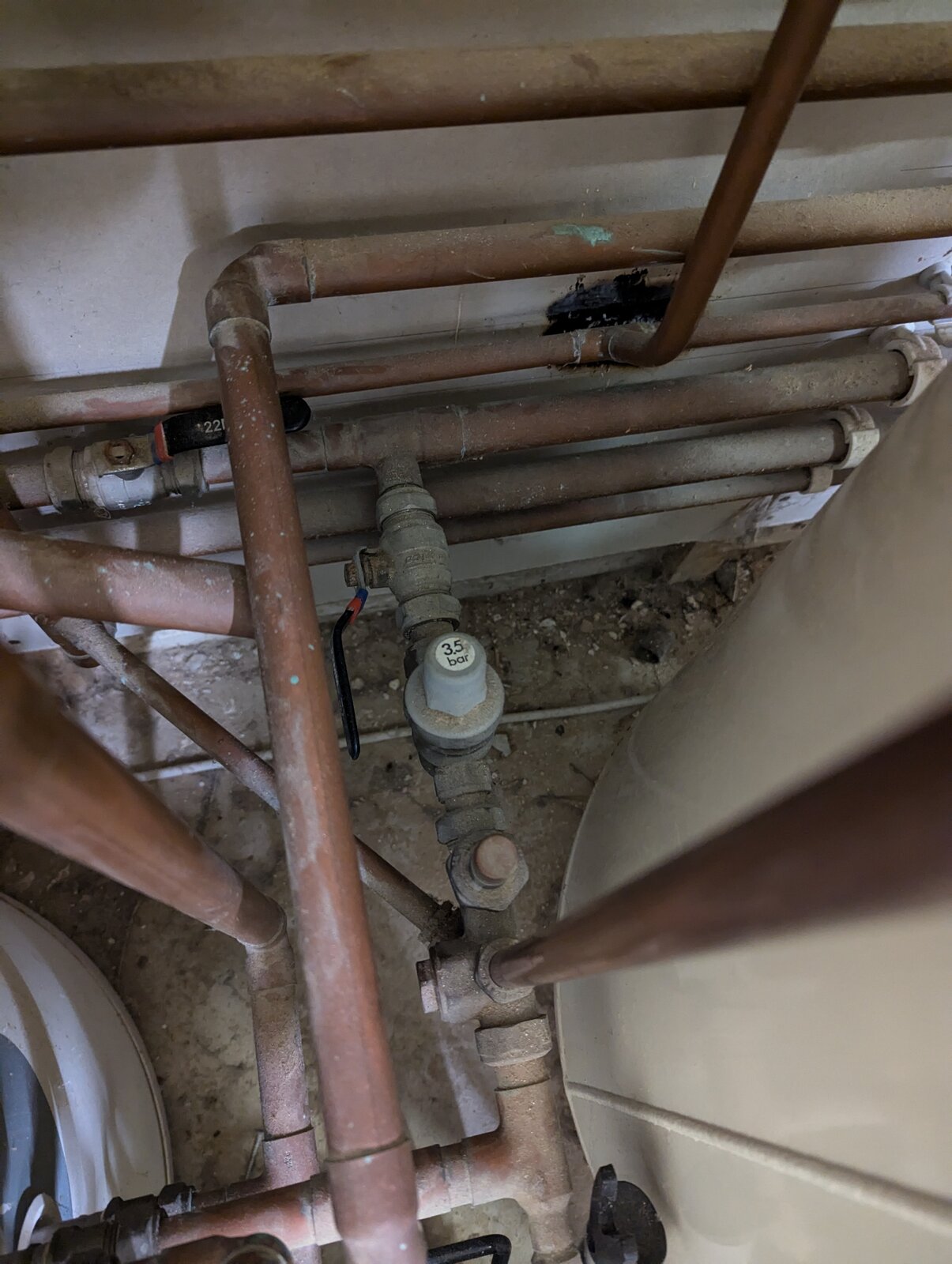

hi, there is PRV installed
Is the supply to the outside tap taken off before or after this PRV, is the supply to the accumulator taken after this PRV and is this PRV also supplying the 300L HW cylinder. If the accumulator is fed after this PRV then no good as its the direct mains that should supply it.
