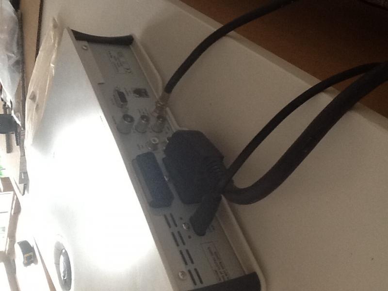

Hi, I've tried to extend my sky box from a bedroom up into the loft. The box originally had a shotgun cable going into the sky box but only one actual connected in, so from that I've put a connector on and ran some single sky cable up (we only use it as free view). I've now realised that the phone line type connection also needed to be ran up as well, what now are the options??
Will a wireless phone line extender be suitable?
Any help would be good

We're not trying to view a same channel, we're basically moving the TV and sky box up into our loft. Step by step I've done the following...
Run some single sky cable from the existing bedroom up to loft
Connected the shotgun cable to the single cable, not sure if one of the shotgun cable has any importance to the other but I've tried the join connector on both
Move TV and sky box up to loft and connect as it was previously.
The only thing not connected in is the phone line

There is one join in the cable in which we've used a F plug, we have no aerial on the house so thought by extending the cable up to a different room nothing would change. We ended our subscription with Sky a while back but still got all the free view channels through the sky box
Check your cable joints. One little strand of the braided shield wire touching the centre conductor can cause all sorts of issues. These things are important. Get it right.
If it's still not working then go back to basics. Take the TV and Sky box back to the bedroom. Hook them up as before. If all works then mark which of the two shotgun cables was active and in to which socket on the box. Move the TV and box back to the loft. Repeat the connections but this time you definitely know which cable in the bedroom to connect and which socket on the box. The only unknown is the bedroom to loft shot gun cable. There are only two possibilities now on each end of the extension cable.
If you've covered all possibilities then either your F connector wiring is stall bad, or the extension cable is poor quality and it's causing too much signal loss. Unless there's something else you're not telling us, then these are the only two additional elements in the system, so it has to be them.

If both runs of the "shotgun" are still connected at the LNB - either will work. So that leaves connection quality, the length of your "extension" and the quality of the coax.
Sat signals are much higher frequency than terrestrial TV, so a cheap length of coax that might work on TV aerial may not work as a satellite extension. Even better as pointed above, run a new continuous length [edit: of sat grade coax] back to the LNB.
What grade of coax are you actually using to extend?
What is the signal levels in the service menu when the STB works in its original location?
Also what is the length of the original shotgun cable to the original location before the 15M extension using yet to be identified coax?
Total run perhaps over 40M and I can't see a grade or spec mentioned on that coax extension. My guess is you have no signal left in the loft.
Can you not make a more direct run straight back to the Dish which is shorter?
