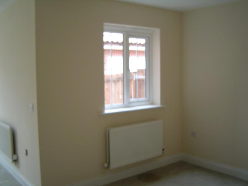

I'm looking at extending my house ,but would like to know if its going to be cost effective,if at all do-able.
Basically i have a 2 storey L-Shaped house and i want to make it square(ie normal shape) all the way up. The problem is that in the sitting room where the L meets(internal corner) i dont want any post or structure holding up the original corner ie i just want a square room with four walls.
Upstairs would remain as it is with the extra space made accesible through a hole in the wall
Your post is practically un-answerable with the little info you've provided.
However, anything is possible although whether its cost effective is another matter altogether.
Its a bit of a vague question, as lots more details would be required for a proper answer.
However, it is technically possible, but with this type of alteration the biggest issue will be the roof, and how it fits in with the exiting roof. The other is window positions if the new work will be where existing windows are
Also, this type of job will not be like a typical extension, tacked onto and merely accessed from the existing house. Rather, it seems like significant alterations will be required to the existing internal arrangement.
Heres a snap of the corner. The wall on the right is the gable end wall and just to the left out of shot would be the rear wall. So the intended new space would be directly outside that window
