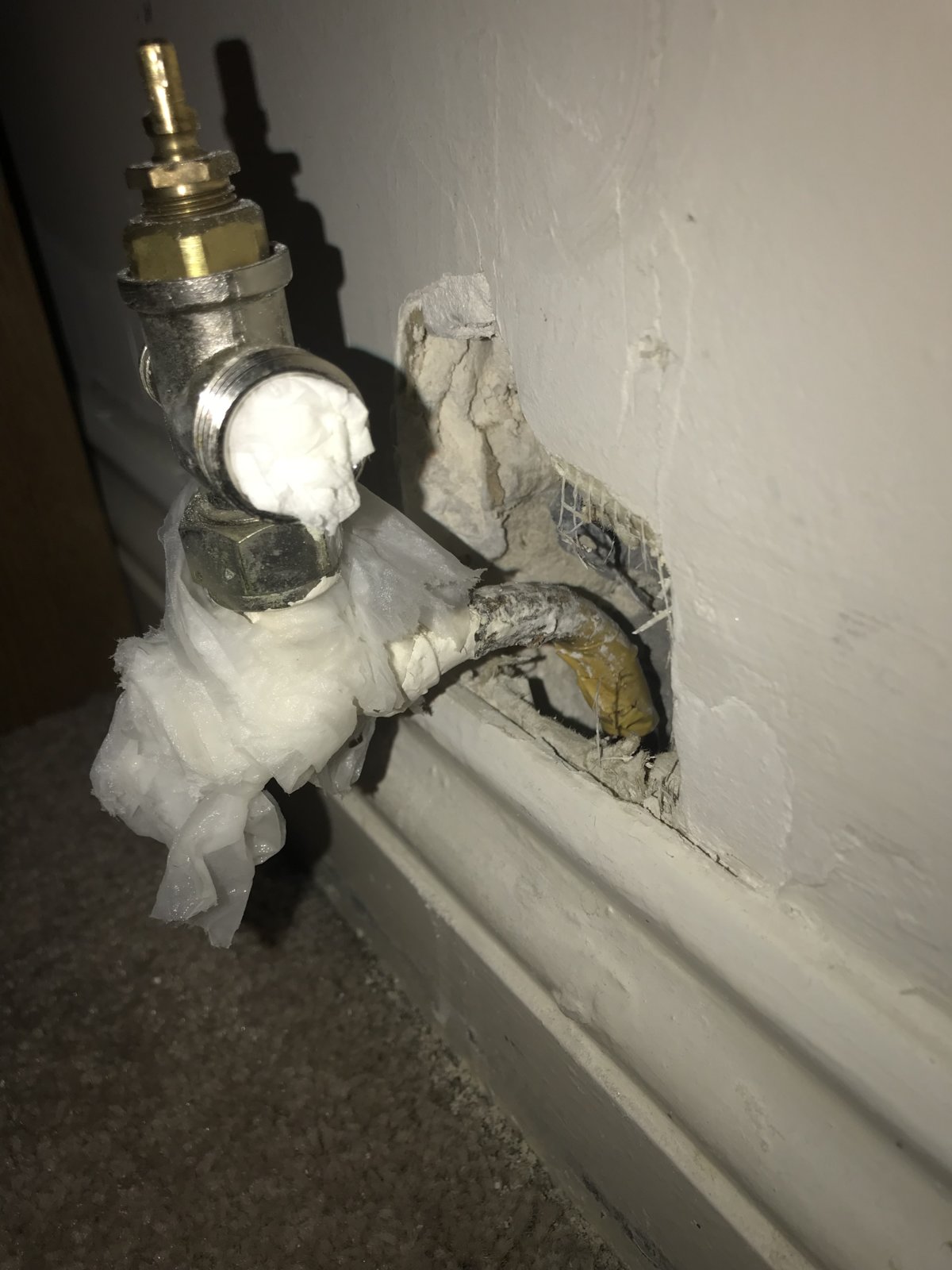

Just moved into a ‘new’ (18yrs old) house, and am decorating one room at a time. I want to replace the old single radiators without fins as I go, with double radiators in some instances.

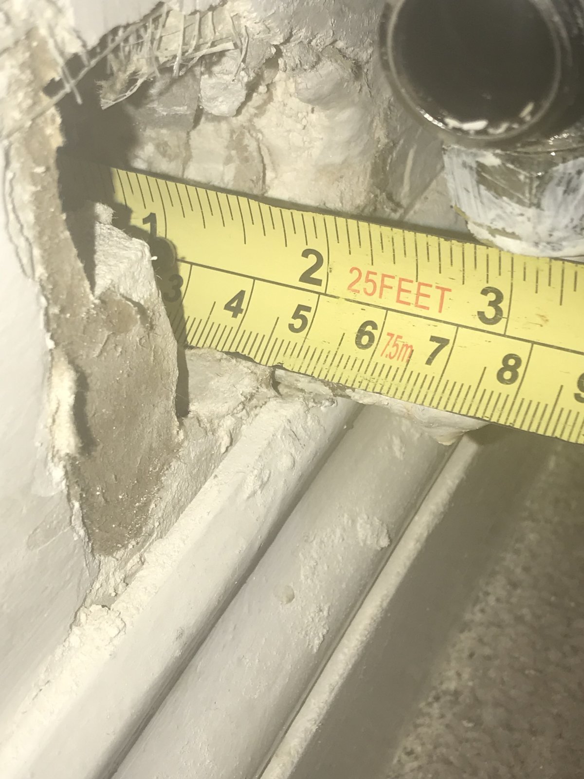

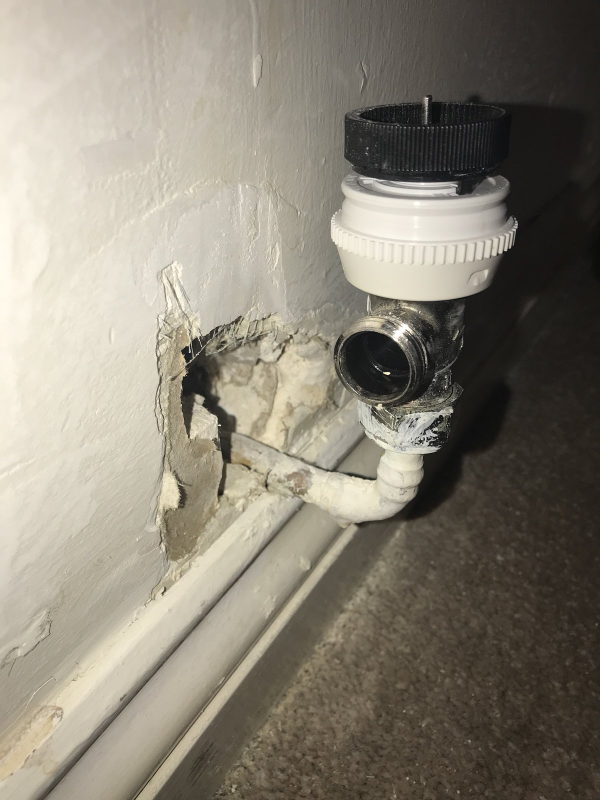

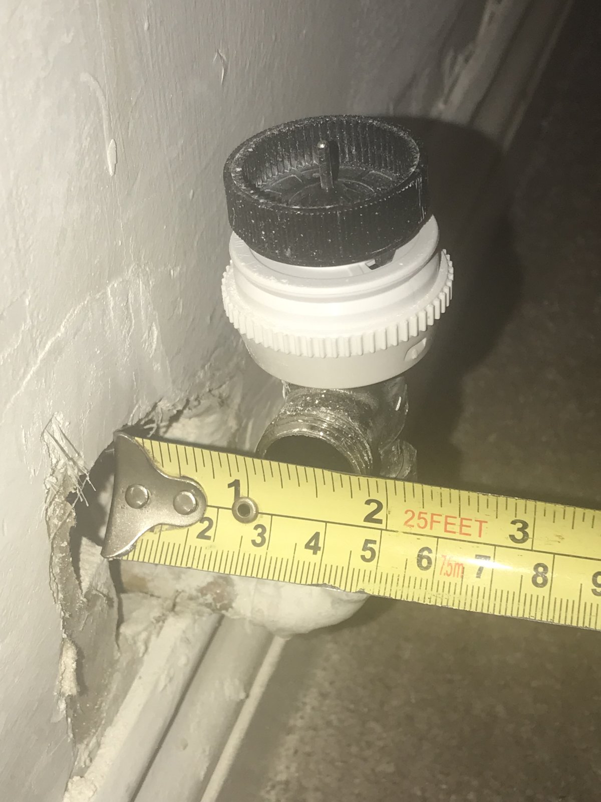

The pipework is 10mm copper, and protrudes about 40mm from the wall. I think need to extend it out by about 20-30mm to fit a double rad. Just wondering what the best way to do this is, without soldering.

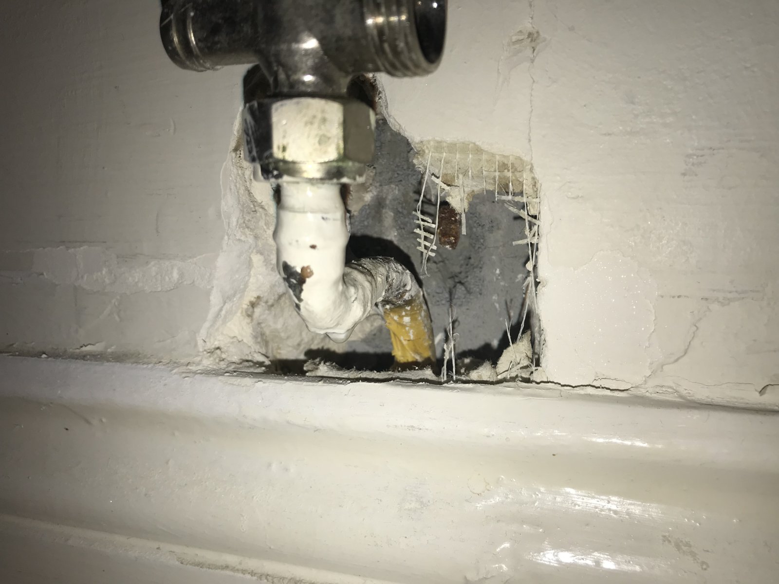

Also, valves at both end ends of this rad had a slight weep, so will be replacing them. But they had wet the plaster around the pipe, so have broken the damp plaster away and will fill it once it’s had a while to dry out. Will expanding foam be ok, topped off with filler once dry?

I think you’ll need to pull the floor up and start further back.
No, seriously. How are you going to make a connection onto those pipes without soldering?
That might work, i’m not a plumber but i’d think that elbow would need unsoldering (i’m not sure if that’s a real word). Good luck though (y)
Not sure. Was thinking of cutting the soldered elbow off and putting a omething like a 10mm pushfit in chrome onto the horizontal pipe?
Would need to get the paint off the copper i’d imagine.
https://www.screwfix.com/p/pegler-push-fit-elbow-10mm/28509
Not sure of the extension provision of that product. By the time you've cut the 10mm pipe and cleaned it up to take the push fit elbow, I doubt you'll have the length you'll need (from the wall) to the projection required by the new double panel rads and I also don't think you'll have the room for a coupler > a short bit of pipe > then the push fit elbow. Plus, it'll look rough as fu©k.
Better to go into wall and bring new tails out, or solder new extensions on.
Ok, thanks. And I presume the pipe has to be cleaned of paint etc before soldering an extension on?
Yep. Back of a stanley blade to scrape the initial paint off then an abrasive pipe strip to clean it up to shiny.
