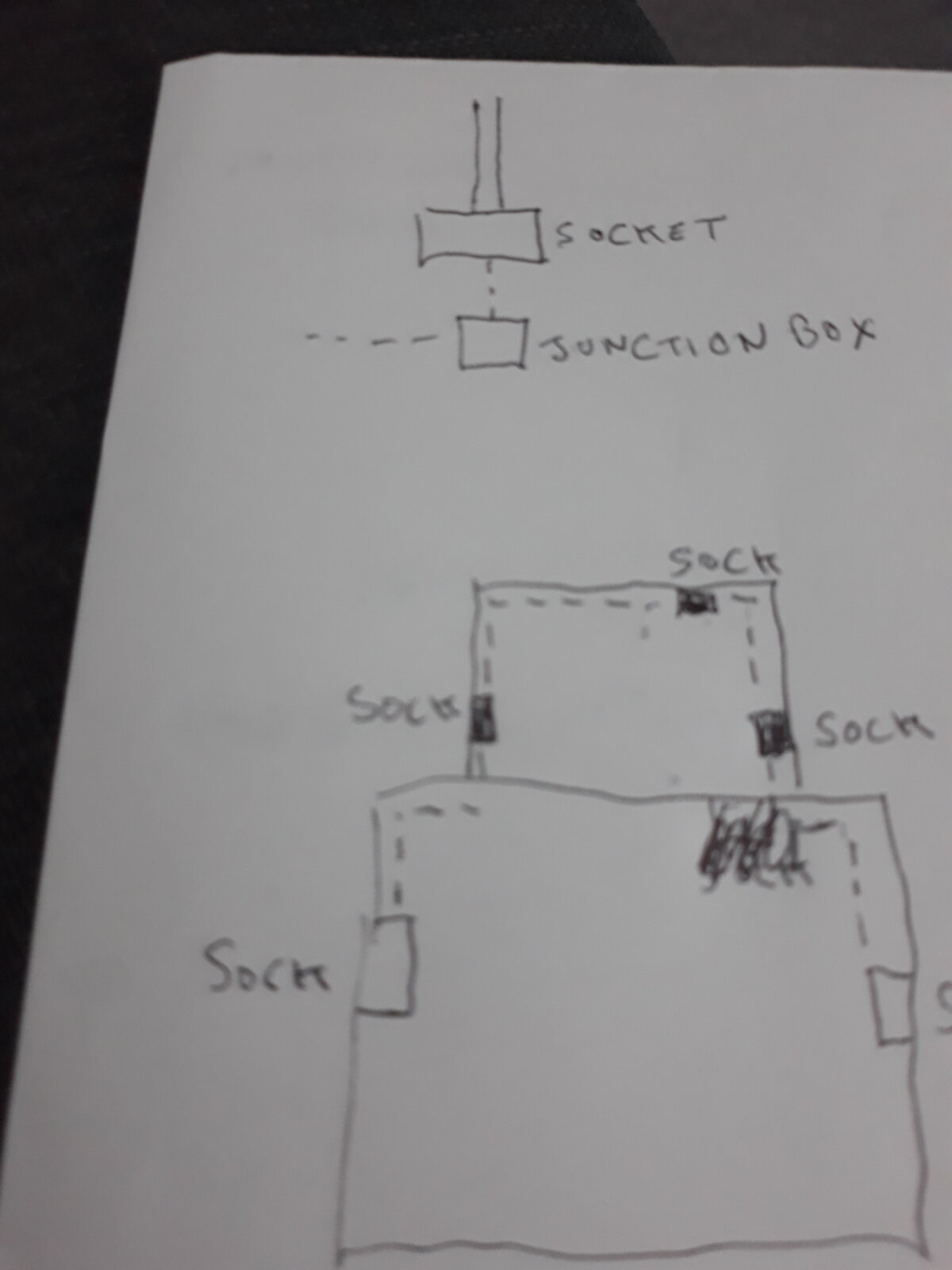

Hi after some help.i an having a conservatory built.and to power and light it.i want to feed it from the downstairs ring 3 sockets one interval light and one outside light.from what I have read I can't extend the ring from the sockets and have to break into th the wiring with a junction box is this right. Do I need to do it at both ends of the ring .my sockets are fed from above. So can I break into the ring just above the socket and use a wagi box

Thanks Eric for your reply .this is what I was planning. For extending ring and doing the same on the other side of the room to continue the ring.do you think that is practical
I don't understand your diagram.
Where is the second cable that must be attached to the existing socket and where does it go?
Why do you need a junction box?
Sorry not very clear on the drawing. Hope this gives a better idea.will do a more detailed drawing if still not clear.i thought you have to tap Into the circuit wiring to extend the ring .with a junction box at either end
Yes that would be alright - as long as you remove the existing cable between the living room sockets making sure it does not go anywhere else in between.
Can you not access the cables at the living room sockets so that you do not need junction boxes?
Junction boxes must remain accessible unless you use Maintenance-Free ones.

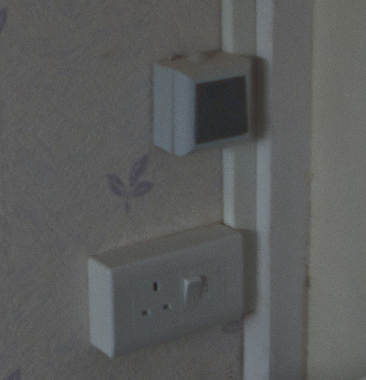

16162589172188430870517929731939.jpgthe two sockets in the lounge ar fed down the wall with 2 cables.was going to put cable joints in wagi boxes
You can't just connect another cable to each socket without finding out where the two cables go.
Well you could but that wouldn't be extending the ring.

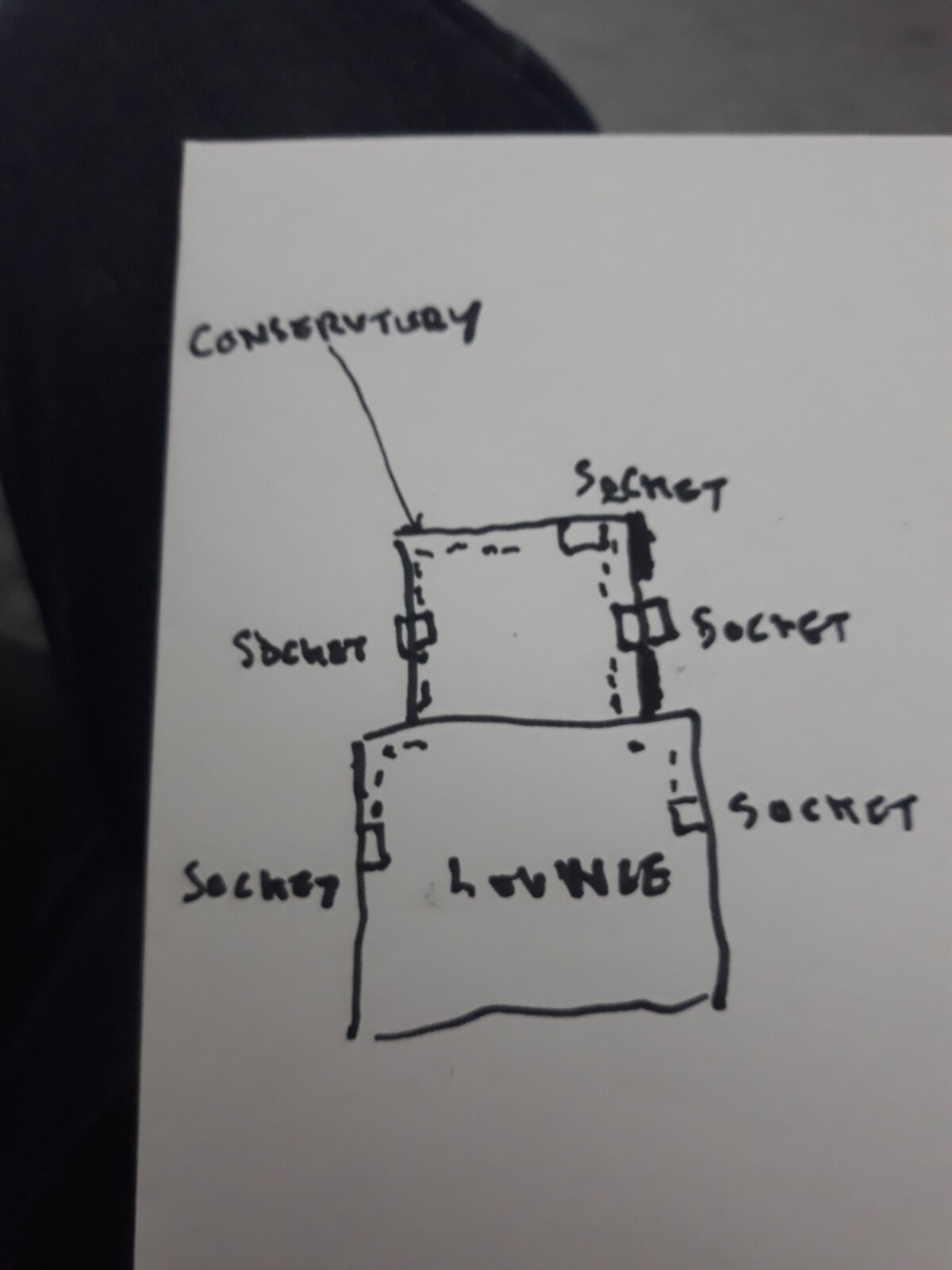

No it's a small terrace.sorry a bit slow grasping this.do you mean taking the live cable out from the first socket.and the live in cable from the second socket.and then feed the new sockets to the sockets I have taken the cable out .so I end up with 2 cables in lounge sockets
If your socket box is a 35mm one you would have room to extend the ring from there.
Disconnect one cable from the back of the socket, run your new pair of cables round your extended ring. Connect one into the socket and the other join to the previously disconnected cable with Wagos.

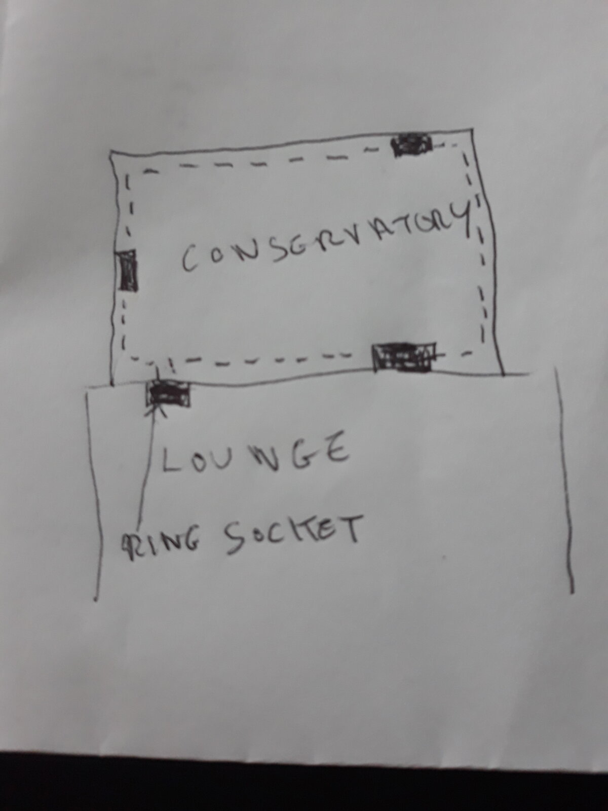

Hi Timbo ithanks for your message is this what you were thinking of
