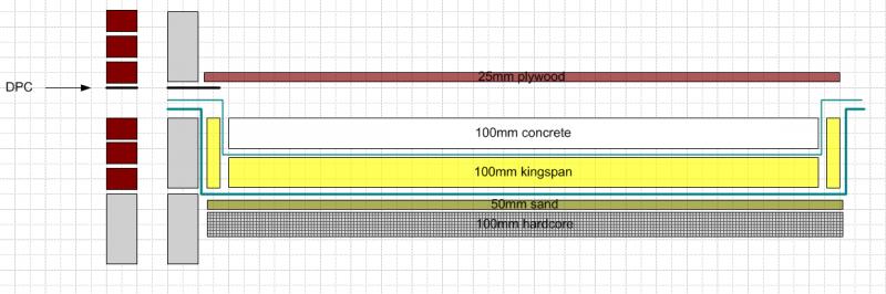

I doubt that anyone on here has got away with advising an OP to have a FFL "at the same height as a DPC"?
Sometimes its unavoidable when dealing with existing circumstances but its not advisable to build it in.
May I ask why? I did this a few years ago, because of circumstances as you say:
