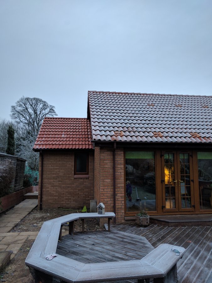

I have had a small extension built which has a vaulted ceiling.
The roof insulation installed was some form of Celotex foil backed stuff that was fairly thick.
However we have found that although it heats well, it cools down very quickly, more so than the rest of the house. Having seen the amount of insulation in the build I had expected it to be like a hotbox.
This morning when I went out I noticed that my main roof (which isn't vaulted and is insulated with glass wool) was frosty but the extension was wet. Could this highlight an issue?

I've sent him the photo but I cant imagine he will say anything other than that is normal. To say otherwise would mean he would have to fix, put new plasterboard up, replaster and then redecorate.
He has replied saying as there is no ceiling in the extension even with the insulation there will be a bit more heat loss than the rest of the house, which has a ceiling and thus a big, vented gap between it and the roof itself, which would explain the difference.

The construction, from inside to outside is plasterboard, block, insulation on outside of block, cavity, brick. Should be plenty of thermal mass there I'd hope.
But your little extension stuck on the side of your house has loads less mass and when heated contains loads less heated air so will cool much quicker.

It certainly makes sense, maybe I was just hoping for too much. Would that still.explain the warmer roof?

It's the mass to external area that matters, the air has little thermal mass. However good point that there's more roof:wall ratio, do you think that would be so noticeable?
