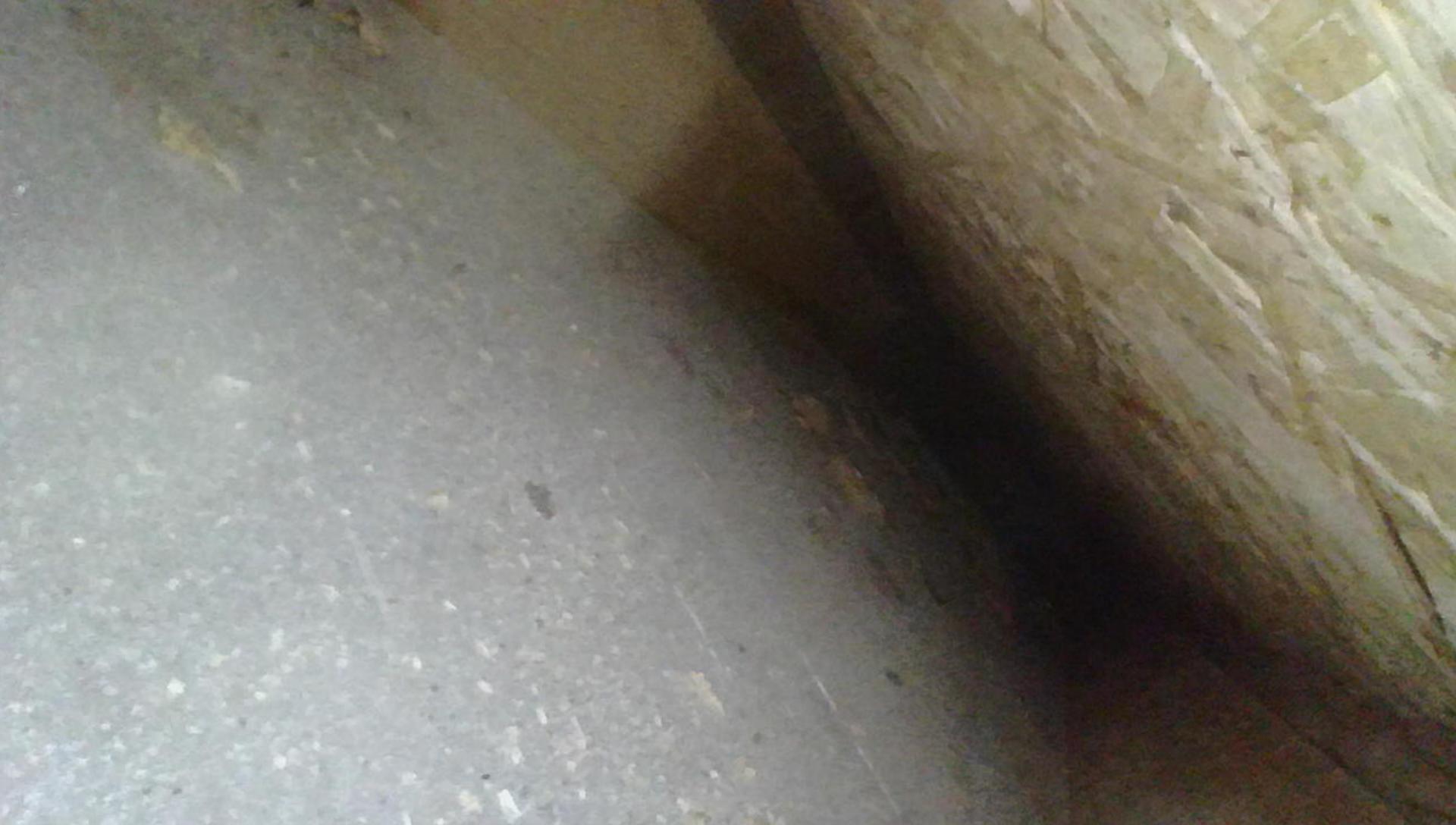

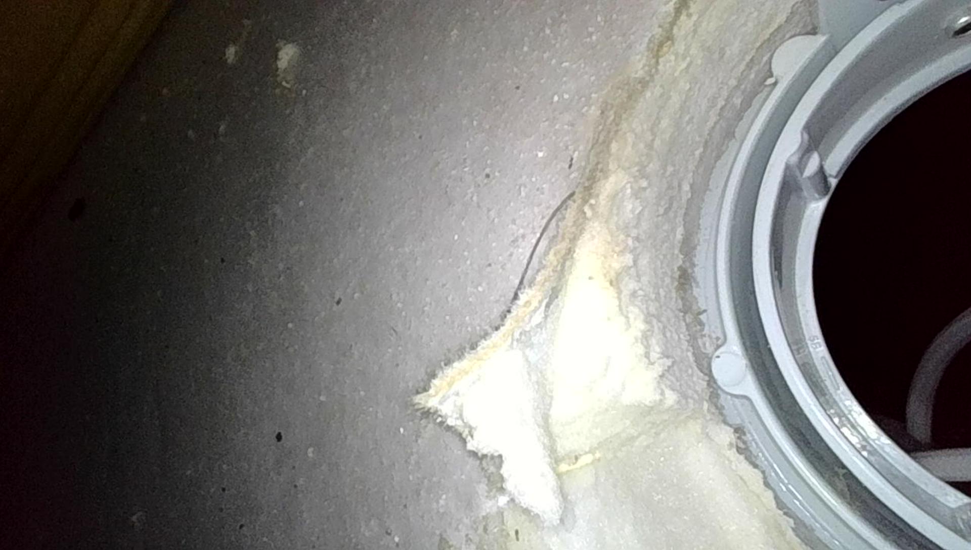

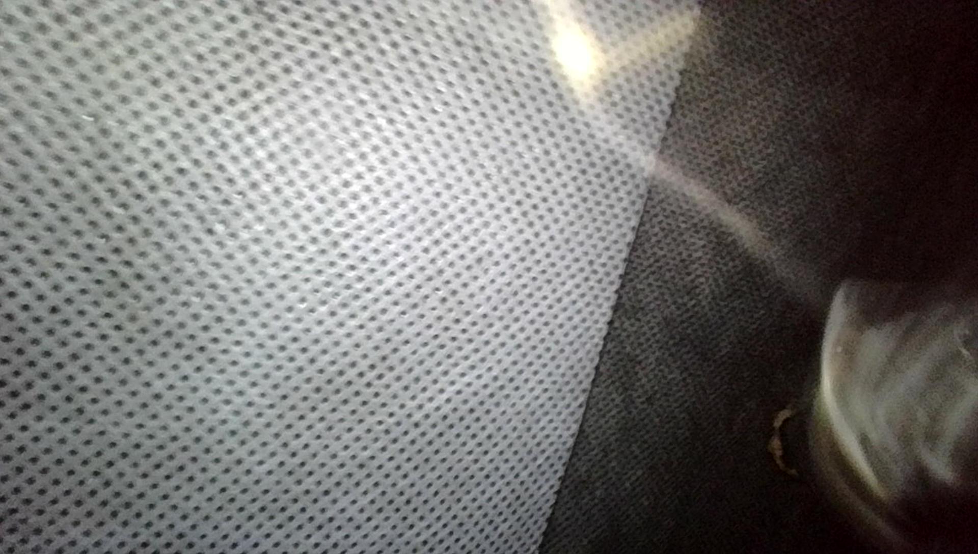

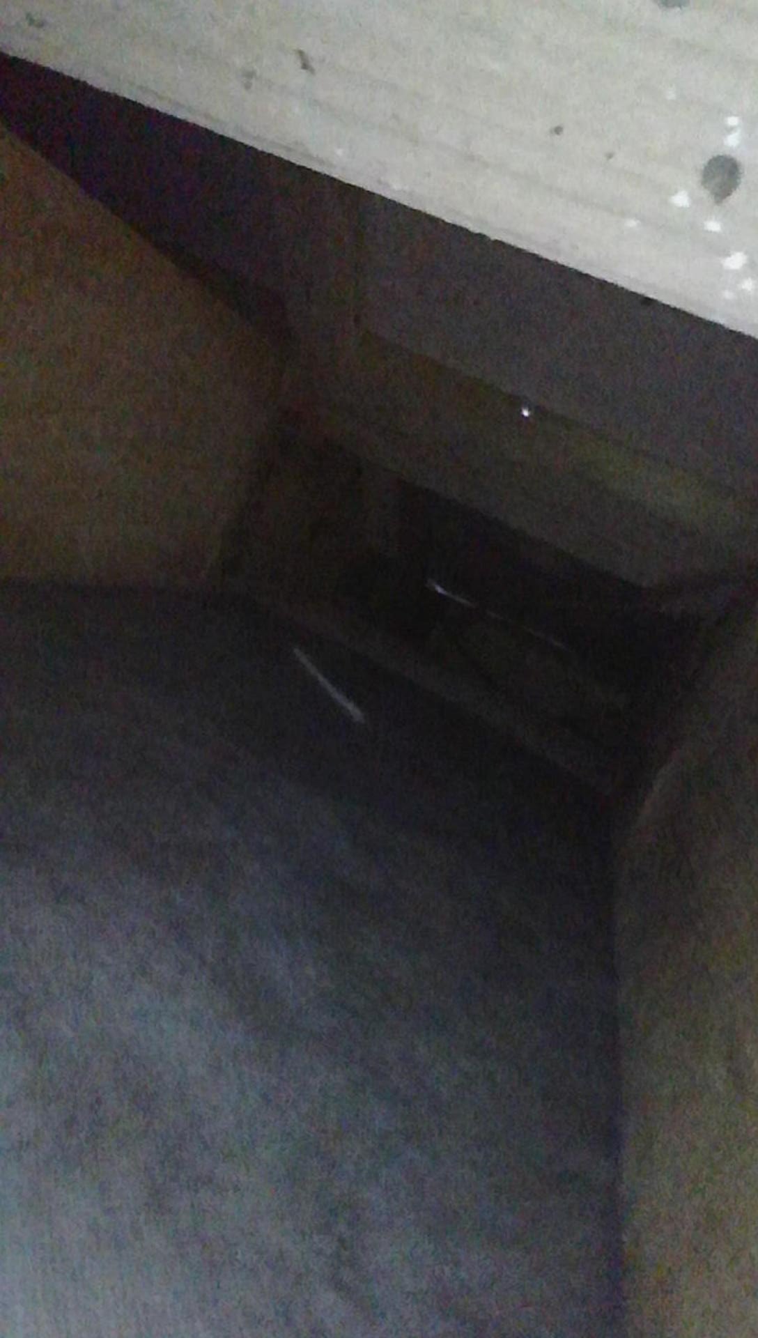

Extension 1, Dressing Room roof (pitched, tiled):
- It looks like this doesn't have much insulation, if any? Besides a thin layer of (foil backed?) foam(?) immediately against the ceiling, that the downlights attach through.
- The rest seems to be a void all the way through.
- The upper layer looks to be some sort of breathable membrane(?), then presumably the tiles above that.
Doesn't this need any sort of insulation at all up here? I know one needs to be mindful about moisture & leaving a void, but I'm concerned about heat loss, and the downlights have obviously breached what is there.
I'm planning on replacing all the downlights with fixed (non-adjustable) ones, (fire & insulation contact resistance rated, of course), that should at least help a bit. I need GU10 ones as we use smart bulbs, rather than the integrated LED type.
To prevent draughts, would that do, or do I need IP bathroom style ones (here in the dressing room), too? (As I know these have gaskets).
We'll be having some roofing work done soon, so presumably they'd be able to get at this from the top side, by removing the tiles / membrane, if needed.

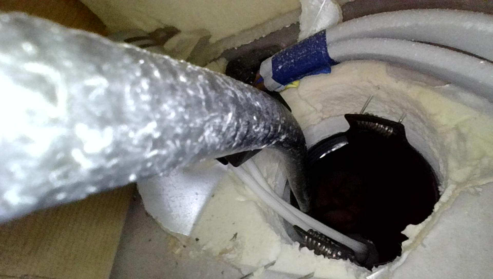

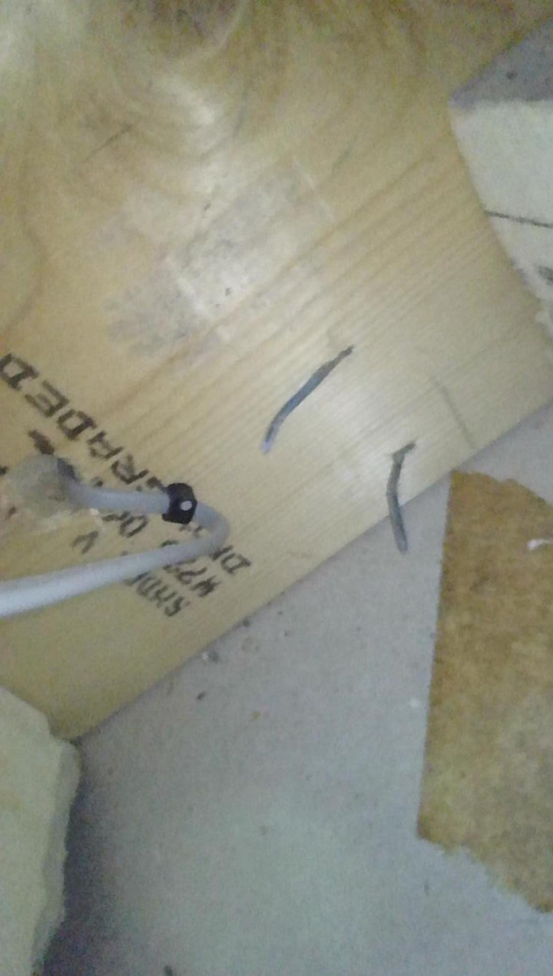

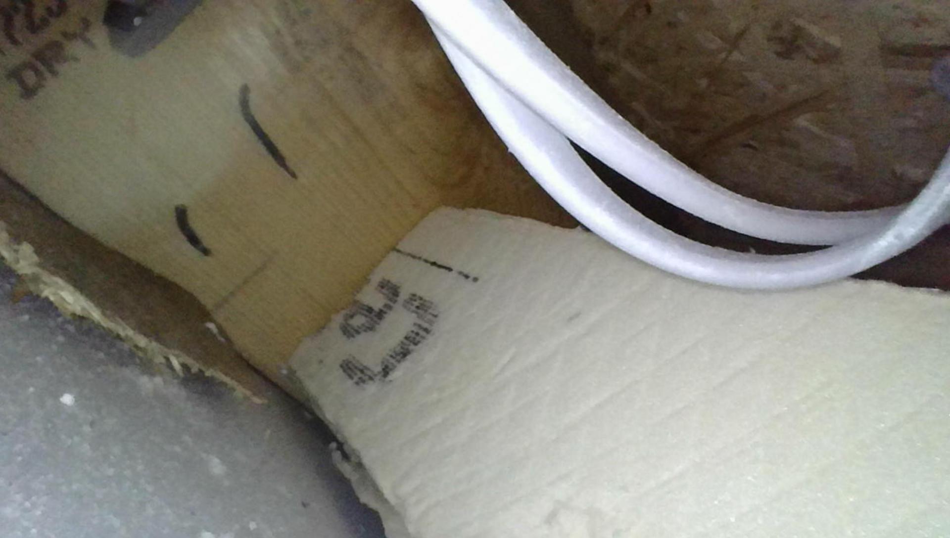

Extension 2: En-Suite Bathroom Roof (Flat, Fibreglass):
-This one seems to have the same (foil backed?) layer, breached by the downlights, of course.... IP-rated, at least so no draughts.
- This also seems to have a thick layer of (foam, Celotex?) insulation blocks, with square sections missing where the downlights are.
- There is then (presumably correct) void between this layer and the boards above, under the flat roof.
- The flat roof installers had installed a couple of "soffit" style vents at the end, presumably to allow for airflow to that section.
As this section DOES look like it has installation blocks, does it need any more?
What about those missing sections where the downlights are? (You can see this in pic 3).
Again, I'll replace these downlights too with proper fire-rated & insulation contact resistance ones (IP65-rated, of course), but again I'm wondering about cold spots, where those have breached through.
As the flat roof is apparently fairly new, I won't want to replace this. However I will be renovating the bathroom in future so doing something from the inside, would be possible.
Unfortunately won't be able to change it to a "Warm roof" style, due to height restrictions mandated in the planning (Neighbours..).

Is there any indication of insulation between that OSB deck and the fibreglass roof deck?
It looks like insulated plasterboard has been used, this would normally be in addition to a much thicker insulation layer above it, it's woefully inadequate by itself.
All I know is what I can see in those pics with my boroscope. The fibreglass roof was newer (replacing the original bodged one) and was done by a different, reputable company at least. All I know is it's the "cold roof" style due to there being height stipulations from the neighbours. (Sun angle is at x degrees at xx:yy:zz.0000 and any higher would cut off light to their extension blabla".
That en-suite bathroom has a thicker layer on the plasterboard, then those large "bricks" (celotex?) you can see in the pics. Of course with huge squares cut out for the downlights! (Seems to be a common stupid thing builders do, and for people to get them installed in the first place. Everything seems to have been done for aesthetics).
The dressing room section has a pitched roof above, with tiles. But then NO insulation at all besides the thin layer on the plasterboard?

As to the rest of the dressing room, I'm presuming that needs some (celotex?) insulation up there?
Steve the Roofer's vids were helpful, however he stipulates using a dropped ceiling, which isn't feasible with our rooms, unfortunately. (The dressing room wardrobes would also need to be changed as they're up to the ceiling).

- Have roofers add rockwool insulation over the dressing room & kitchen extension lights, and anywhere else (from above. We're having the main house tiles off for a re-felt soon anyway, so they can nip under the extension tiles too and add some insulation, while they're at it).
- Whenever we re-do the en-suite one day, have the ceiling down, and put it back up with insulation over the downlights. (Shame we didn't know about this before the flat roof was done. I suspect they didn't expect to see the missing insulation either, and it will have been too late once the roof was already off).
