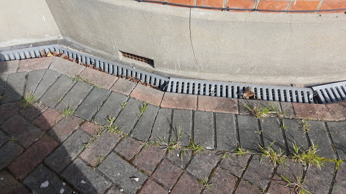

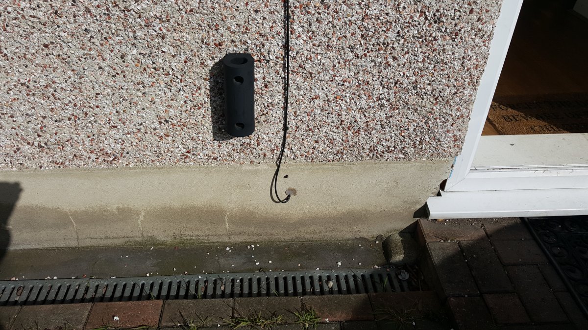

Hi all,
I'm about to paint part of front of my house on cement surface (see pics).
Need some tips please on what sort of paint and undercoat and brushes i should be using.
I'd ideally like to use a paint that is hard wearing and doesnt need repainting for a while..
Colour black or white. Any help appreciated. Many thanks

A couple of Coats of Dulux Trade Smooth Masonry paint should do ( Black 0r White) (4 inch Brush)
Bedec masonary paint is the best i've used
... and don't forget to thin the first coat as its not been painted before
