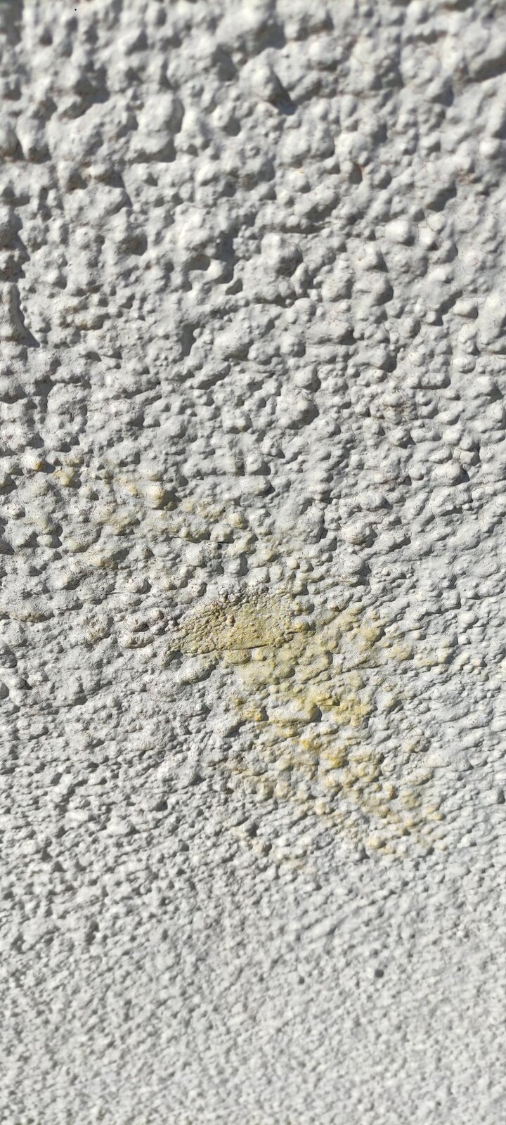

We have recently moved into a 1960s bungalow on the south coast. It is generally in a very good condition. The external walls are half brick half pebbledash. The bungalow has cavity wall insulation.
I am planning to repaint the pebbledash walls. They are white at present but we are changing to a cream colour. However after some rain recently I recently noticed a dark patch had appeared on the external wall between the front two windows. On closer inspection the paint was what I can only describe as soft. If you run your finger along the wall it leaves a yellow residue. When the wall dries the dark patch disappears. But again if you rub the wall you get a powdery yellow residue.
Can anybody advise on what they think the issue may be. Could it be a damp issue? Although there doesn't appear to be any damp on the internal wall. Or is it just some poor quality paint or painting?
Grateful for any advice.

How big is the patch. It might be rust. I have, on a couple of occasions, seen rust marks in newly dashed walls. In theory, a spot prime with an oil or shellac based finish should suffice- but it is not guaranteed to work.
Hi opps. It's a relatively large space. Around three foot across by six foot high.
Just run my finger along it again. It leaves a white residue on my finger and a yellow streak on the wall. The yellow streak disappears after a short while. All very odd.
Can you take photos from further out?
I agree that it sounds odd- for what it is worth- I am a decorator

I went to take a picture but as the weather was dry the wall looked blemish free.
I'm going to use a stabiliser and then paint the wall with a good quality masonary paint.
Incidentally, the (empty) bungalow next door has a similar issue in exactly the same spot. Some of the neighbours seem to think it is a problem caused by the cavity wall insulation.
If it was felt the cavity wall insulation was a potential issue with the wall would it be better to use a water seal rather than a stabiliser? And can you use masonary paint over water seal?
