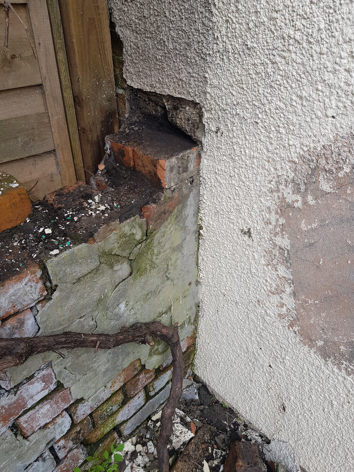

External render blown/damp/issues, best solution?

Fair enough, I just thought it was more exposed now I removed the dashing.
I won't worry so much about getting it sorted quickly then

I agree. That second coat of render was put on for purely cosmetic reasons, to hide the cracks in the first coat. Likely the first coat was too, but you find that out if/when you remove that first coat. Left as it is for now, it will not deteriorate much at all.
If that wall is any less than a cavity wall, then best to save your money until you can afford to do it properly with insulation.

Thanks, yeah it's two layers of bricks but only with a tiny cavity so the bricks could be layed, which I've been told is still classed as a solid wall.
My issue with leaving it is I need to fit the soil stack and waste etc. So was hoping to sort it before that
Also, how do you even get off the layers of render that are so firmly adhered?

Thanks. I'm a bit confused by the breathability factor. Everything I read says if the original materials were line based, then you should remove all the cement renders and render with lime.
But then everything I read about external wall insulation says you don't need to remove the old render as it uses mechanical fixings. But then how does an old solid wall breathe with the old render and EWI on top?
Also, just noticed that the wall in my garden seems to be built into the back wall of my house. And my damp issues internally were all in this corner, could it be moisture transferring through this garden wall...see pic
