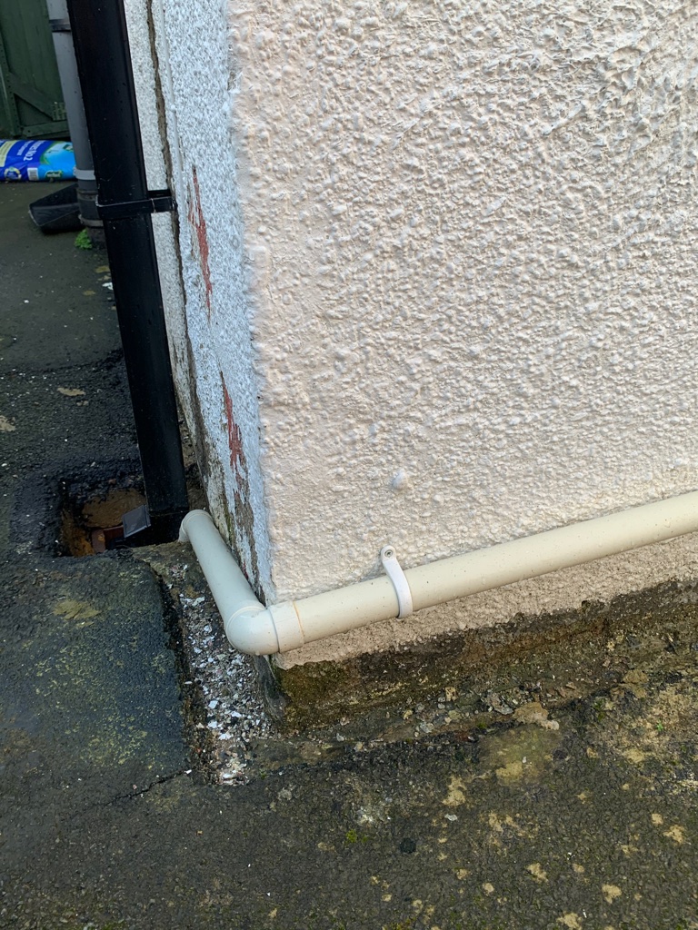

Sorry for the delay on this, first day I've been home in the daylight to get some photos.
We don't have access to the leaking pipe anymore, it was the water meter that was leaking, this has now been relocated to under the sink and is not leaking. All of the pipework was replaced when the new kitchen was fitted. The pipe was low, right in the bottom corner of the kitchen.
The floors are solid. I believe the walls are solid.

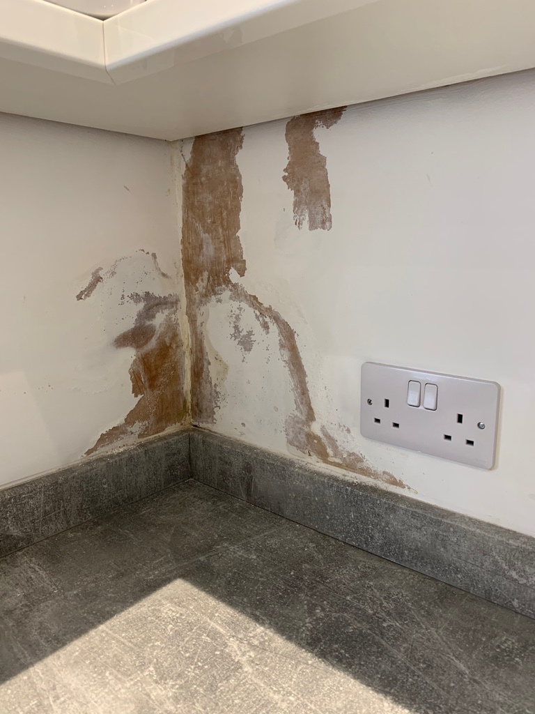

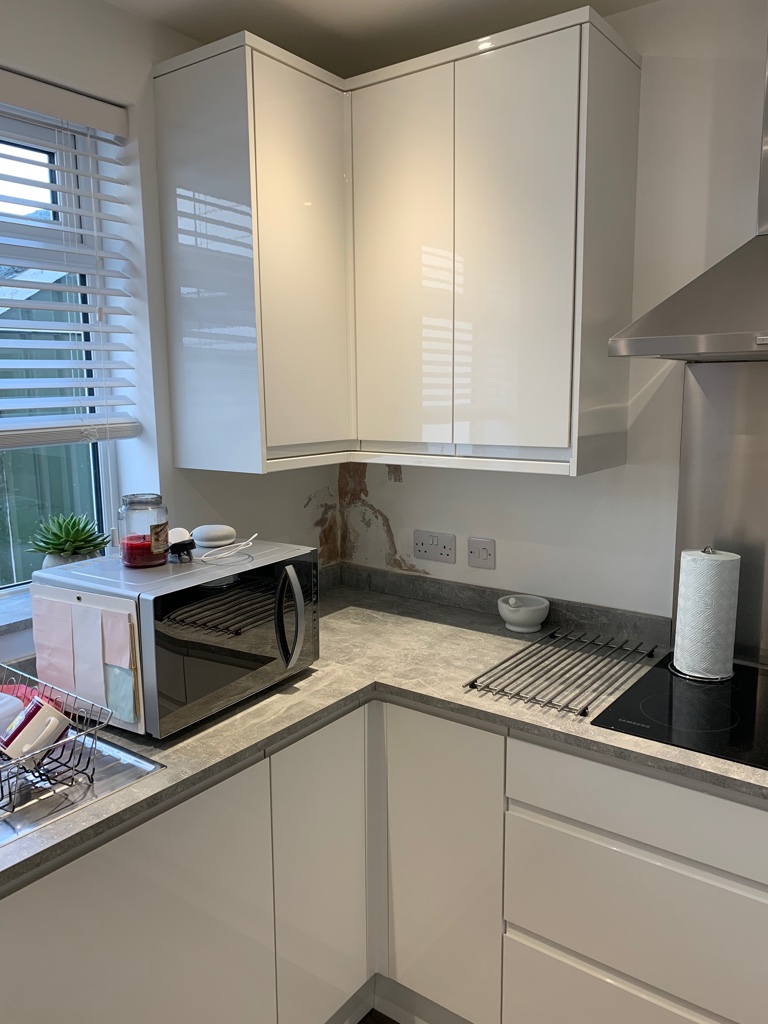

I've attached photos, the inside wall is slightly damp again today as it's been raining.

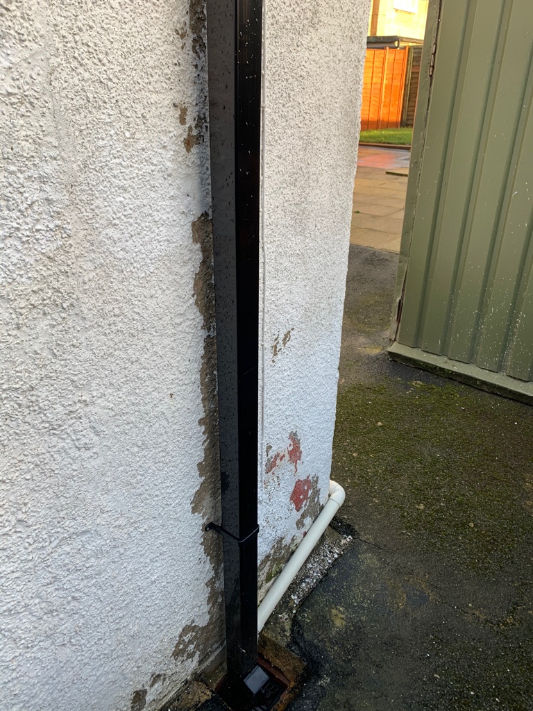

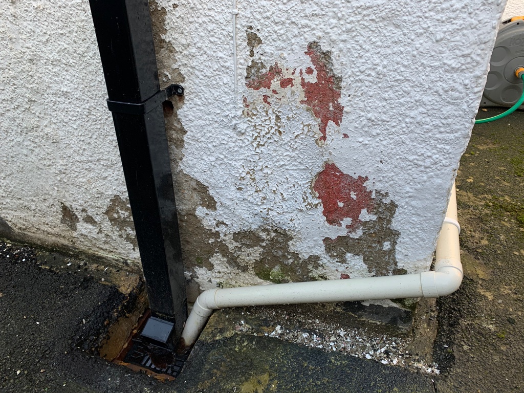

The outer wall is mostly hollow around the bottom 30-60cm from the corner in both directions, after that it's hollow again. It's hollow from the black painted line at the bottom to about a metre up. The patches are from where I've pulled off the loose outer render, I imagine I need to get it off all the way to the brick though?

1. at the outside corner - gulley side: remove the render back to brick from ground level to fascia board and as far back as seems needed. check the corner bead for rust?
same applies to any other area of rendered wall.
2. temp remove a length of the rainwater pipe.
3. if the paint isn't exterior paint then it all has to come off.
4. the best practice way to remove the internal damp stains at the work top/inside corner is to hack off all affected plaster.
you might have boith penetrating and rising damp?
5. units and back splash would have to be removed for a thorough job. your call?
6. the black top yard surface has raised the ground level - maybe any existing DPC has been bridged?
7. the gulley lacks a grid - rodents can exit the gulley.
8. after hacking off - render with sand and lime 3:1 mix with a limelite skim on the interior render.
9. remedial Tyrolean can be patched on. stop all render 50mm from ground contact.
10. is the kit floor higher than the outside ground level?

Was this damp here before you fitted the kitchen? Looks like a fair bit of water, check for other water leaks, it may be a new leak somewhere else and water is travelling? Poss related to water meter?
The wall was damp with mould before the kitchen was fitted (found when removing the old kitchen). The leak was found and resolved, the kitchen dried out and then the walls were treated (interior) with tanking slurry before they were plastered.
The plaster inside seems good, its not hollow and drys out most of the time. It's only when it rains that it becomes damp.
