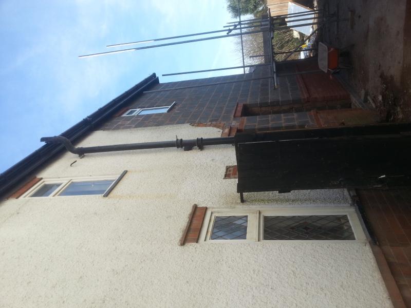

Hi guys,
I am in the process of having an extension built. My original house is rough rendered (not sure how)
Anyway, in order to match in the new extension I propose the following:
Get some scaffold up and remove the entire side of the rough render.
Then get someone in to render the whole side with a smooth render.
Sounds simple to me, but I'm no expert and wanted some opinions.
Would this be achievable?
Would it look fully uniform?
Might it cause me problems I didn't expect?
I realise that this will be a time consuming task, but I'd rather remove the render to save money.
Here's a quick photo
Also, can anyone give me the average cost for smooth render per Sq meter
Many thanks
Can't see any issues with this. Just make sure that you tell the scaffolder what you intend so that he knows how to set it up :)
As above.
OP, Do you intend to apply external insulation?
Use bell casts above all frames/tile creasing's, & DPC's.
Modern renders, aka synthetics, are typically used nowadays. google up some finish pics?
Quite how you will save money by removing an elevation of what looks like perfectly good render is a mystery?
Hi fella if possible square all your windows and doors with stainless angle beads. Try and drop the building in one without using drip beads as they hold water and will go black aventually. Whatever finish you put on it.
jd67stella,
I understand what you are saying but no way is it worth sacrificing the bell cast or drip stop simply because the projection will get dirty before the remainder of the wall render.
PVC bell casts are absolutely essential for my two pee, otherwise you risk water running back into reveals or background.
Agreed that some modern renders are applied very thin but they still need at least a drip stop (as recommended by Render Mfr's).
