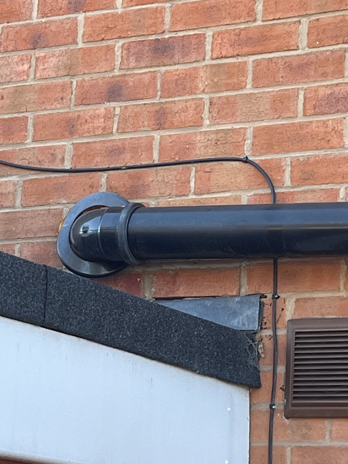

Hi Guys,
I have an issue with a pipe collar on where the soil pipe exits the house but because of the bend being so soon, it won’t fit on and comes off constantly. Is there anything I can use other than a collar?
Pic shows it after I have reapplied the collar but it will fall off soon and looks a right mess.
Thanks. I can look into this, the main issue is that the plumber filled the gap with expanding foam and I think this is because they cut the hole a little too big. I can maybe cut it away and seal.
Just re read your reply. To seal
It on. Ok sounds a pretty good idea.
Yes, cut back the foam. Then refit the seal and silicone it in place and around the edge.
