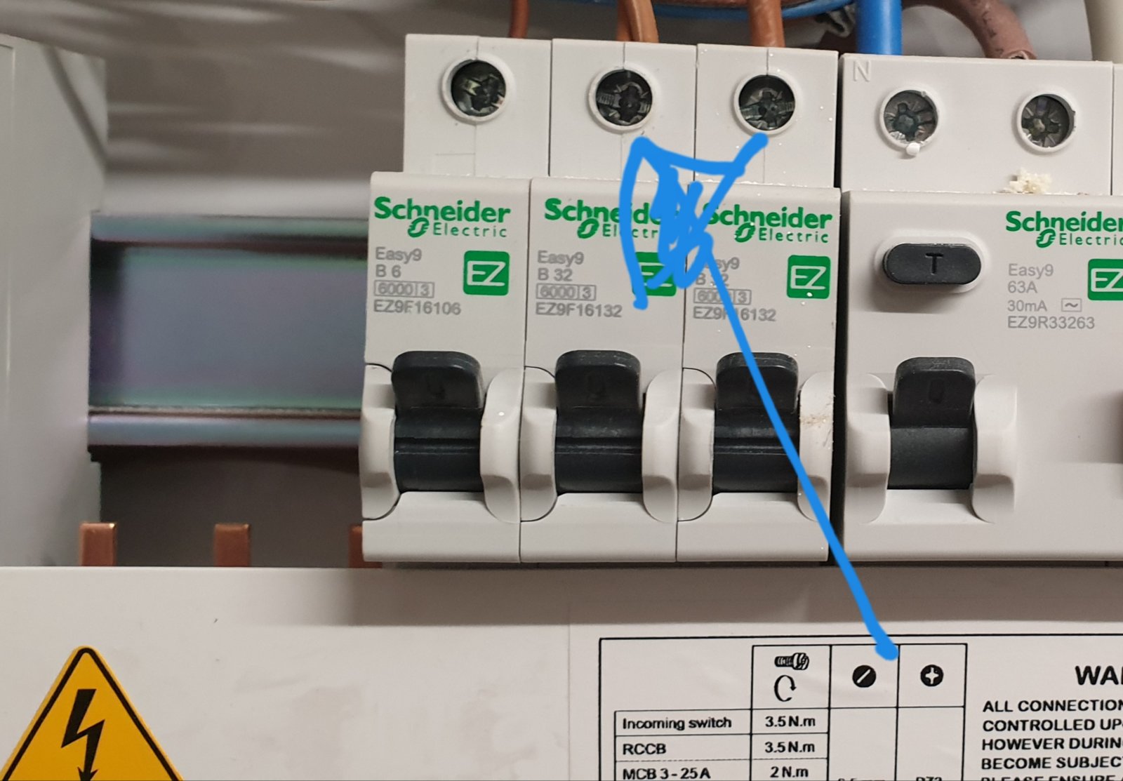

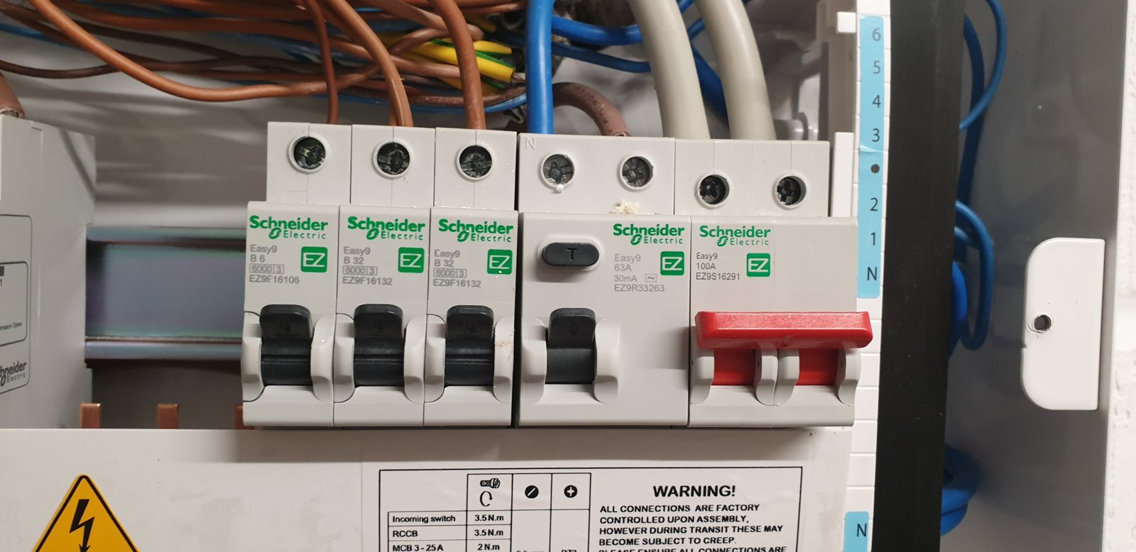

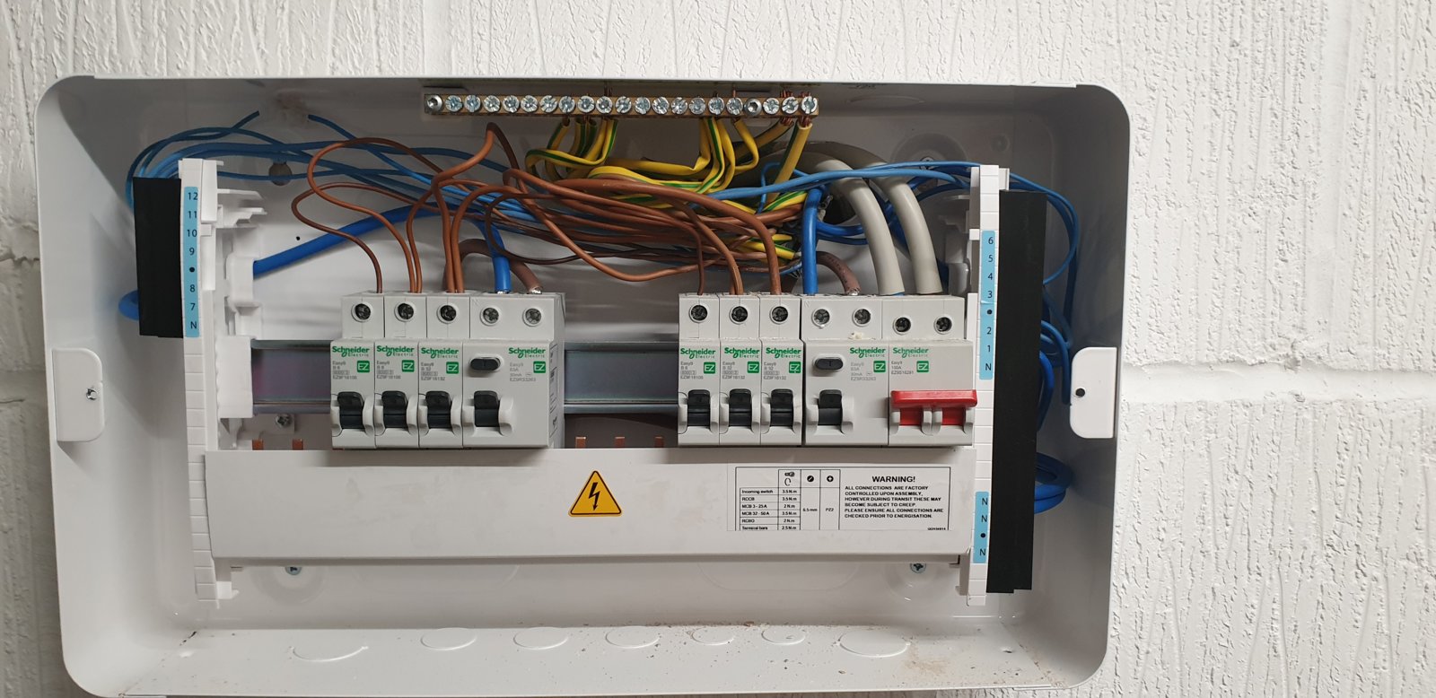

Hi...this is the board

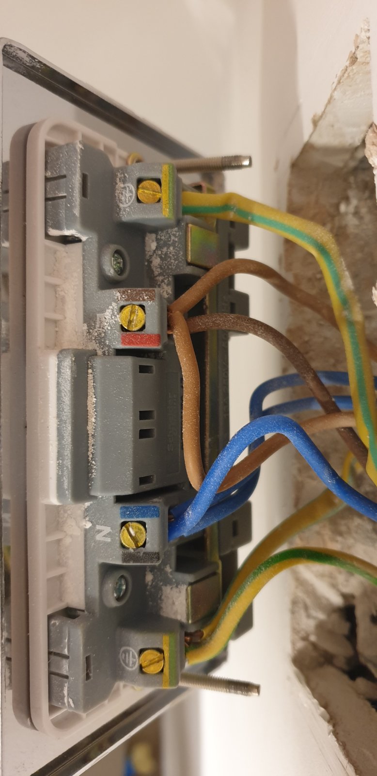

So seems to be on a ring..
The socket I want to use already has a another twin socket coming of it not this was done after the build so can another one come off it?
