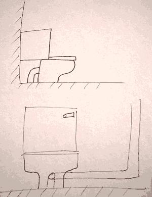

Unfortunately I can't upload a photo because it's my dads and is some 300 miles away. However, this sketch should clear up the uncertainties.
Richard may be able to clarify for definate, but i'd think no. You have a 90deg bend in the wet part of the stack, which is not allowed.

Sorry, the diagram shows the existing downstairs toilet. The upper frame shows the sewer pipe exiting horizontally and turning 90 degrees into the floor. The lower frame is the same downstairs toilet showing the hypothetical connection to the upstairs en-suite.
I did understand it; that 90 degree bend is your problem. The stack must (effectively) be vertical from top to bottom into a slow rest bend at the bottom below the ground floor toilet where it meets the drain invert - the bit under the ground.
