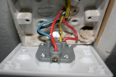

I have just been replacing some light switches - nice simple task I thought until it came to replacing the two way light switch for the landing.
In the original switch, the red from the lighting circuit was not connected to anything and a separate piece of red wire was connecting two of the points (unfortunately I didn't note which ones). The rest of the wires were all connected in the traditional way. I replaced the switch and just wired as should be with the live connected and not using the separate wire.

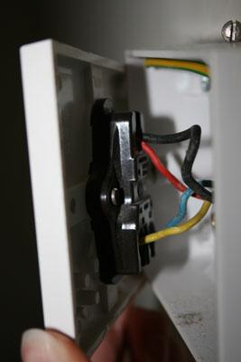

In the second switch in addition to the wires from the switch cable there is also an additional black wire connected to the COM terminal.
With this second black wire disconnected nothing works, when it is connected the lights switch on and off but aren't working properly. they do something like the following:
both switches in same position - light off
switch downstairs - light on
switch upstairs - light stays on
switch downstairs - light stays on
switch upstairs - light goes off
All a bit confusing.
Any advice on what might be happening and how to fix it appreciated
as you say "2 of the points", can we assume that one of the switches is a 2 gang switch?
with the com's linked?
pictures would help lots..

Downstairs switch
This was originally a double switch but one of the switches did nothing so I thought i would change to single switch.
Correction from first post - the Red wire that wasn't connected was the one from the two-way switch cable
upstairs switch
Each switch has inside COM, L1 and L2 terminals.
The original downstairs switch had 2 sets of terminals

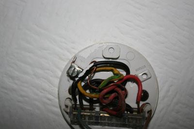

Upstairs light
The switches also switch on a second light further along the landing, I presume these are a spur from the ceiling rose
