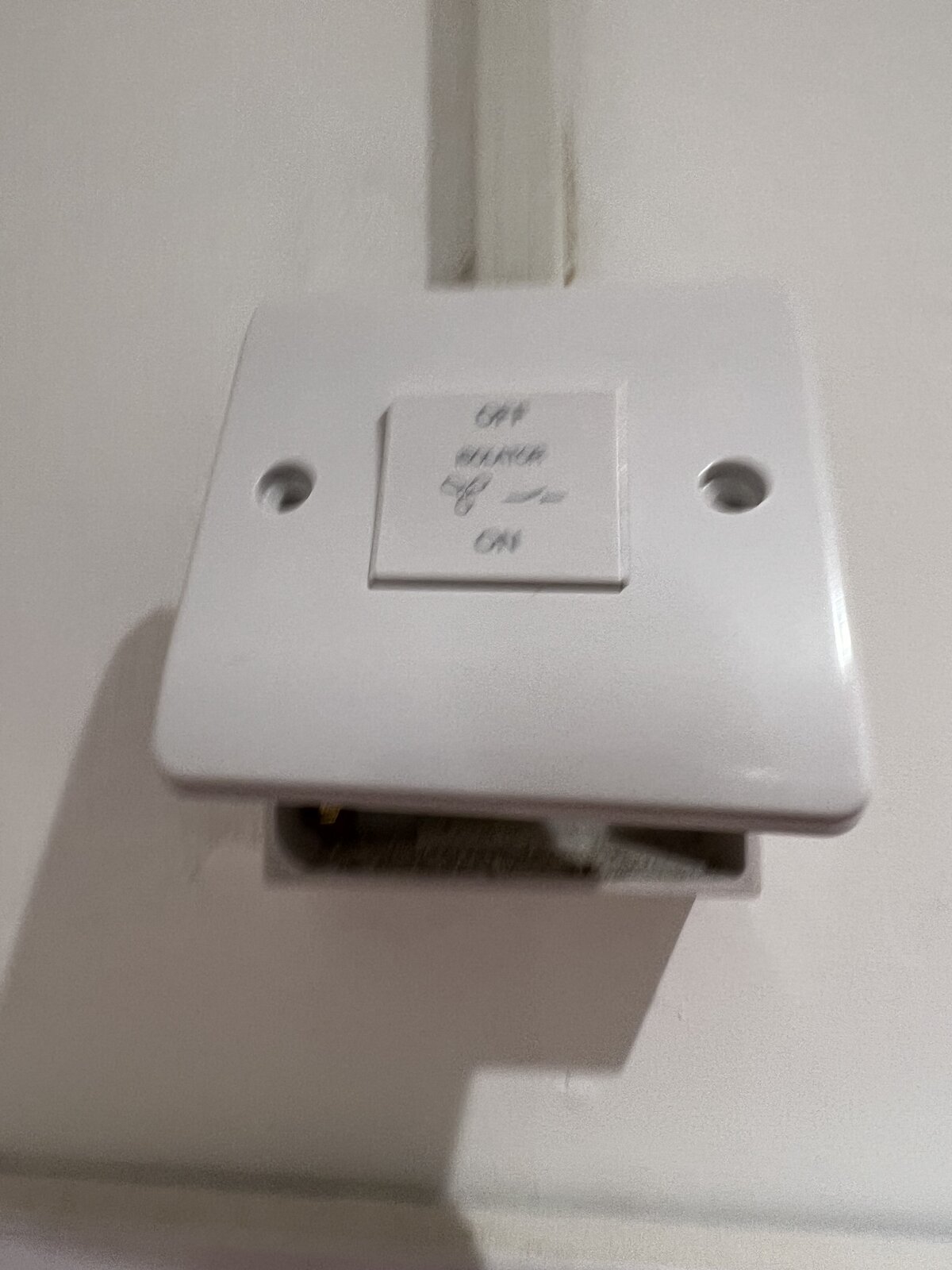

Can I get some advice with this please. It’s connected to an inline fan (no timer) in the attic and I’d rather rewire it here, than climb into the loft.
Let me explain the situation.
I have this fan switch outside the bath.
Here is the wiring:

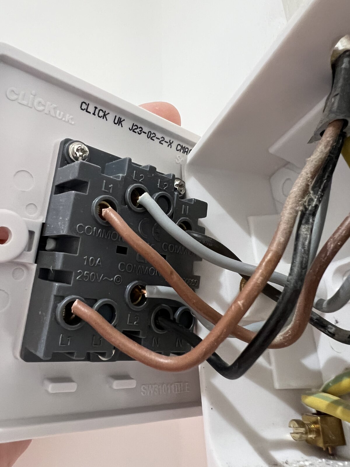

The cables at the top are coming from the light and the cables at the bottom are going into the fan.
Brown is live, grey is switch live and I guess the black is neutral. I’ve tested L and SL using my two pole tester.

Sounds like the live and switched are joined in the fan.
If you take the brown out of the switch (going to the fan side) and put it in a wago that should do it....I think.
You only need the switch live to operate the fan, so the live in is redundant. Have a look at the rose or whatever feeds the down lights to be sure if the set up
Either a standard fan has been used and live and switch live connected into the L terminal....or
A timer fan has been used and L and Ls have been linked,
Either way just remove the brown in the isolator switch/ load side.

I will remove the live on the fan side and isolate. Presumably, the incoming live has no function either? I can leave in the switch terminal but interested to understand.

The incoming brown is the permanent live (yes leave it connected) I'm assuming that when you switch the isolator on it joins the two lives together switching the lights on permanently.
I might be wrong but the first thing I'd try is removing that outgoing brown.

Thanks and all and especially @pete01. As suggested. I removed the live from the fan side and everything now works correctly.
Are we saying the live on the feed side is required or is that superflous here too? I don't plan to change it now as it is working! Just interested to understand.
Good I can sleep tonight now :)
The permanent live (brown) isn't needed here, but if you ever change the fan again you have the wiring in place to fit a timer fan.
