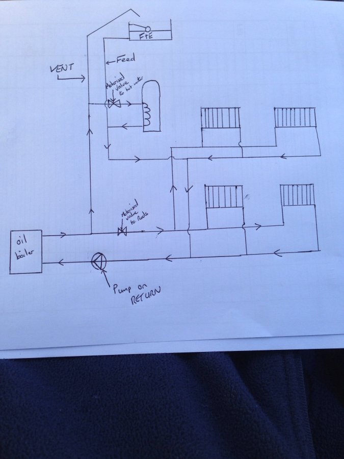

Hi everyone I'm Scott..I recently bought a house and decided to re plumb myself..fired up the heating for the first time today and found that the hot water was pumping out of the vent pipe in the attic into the f and e tank I thought the speed of the pump was mayb to high so ran it on speed one but this just slowed the water flow slightly coming from the vent I decided then to close the valve coming out of the f and e tank feeding the heating circuit and the water coming from the vent stopped..from this I think that the water is circulating in my f and e tank I drew out the way I have plumbed my heating circuit and will try upload the photo any advice would be greatly appreciated
The vent pipe is connected to the feed from the boiler; but the feed from the tank is connected to the return. The pump over is probably caused by the pressure difference between the two connection points as they are on opposite sides of the pump.

Yup, look at the design specifics of a typical combined feed and vent system specifically the location of the pump in relation to the vent and feed pipes and distances between the vent and feed.
Thanks for your replys..I see that I should have my feed and vent closer to the boiler before the pump with it on the flow rather than the return as I have it...is there any other way of doing this rather than taking another 2 pipes to my boiler because it is situated outside and would be a lot of floorboard lifting lol...would a combined feed and vent work where I have my feed pipe in my drawing?

Looks like you've used an old configuration from 40 years ago.
Look for a diagram showing a "close coupled feed and vent (that is where the 2 pipes are within 150mm of each other so at the same pressure)" on the flow from the boiler directly followed by the pump. This is your best configuration. A combined feed and vent can be a pain to get the air out of.
I am in Northern Ireland the heating systems are usually oil boilers in the area I'm from...I think my easiest way out of this is to T the feed and vent together in the attic and keep the pump on the return as in picture am I right to think this?
