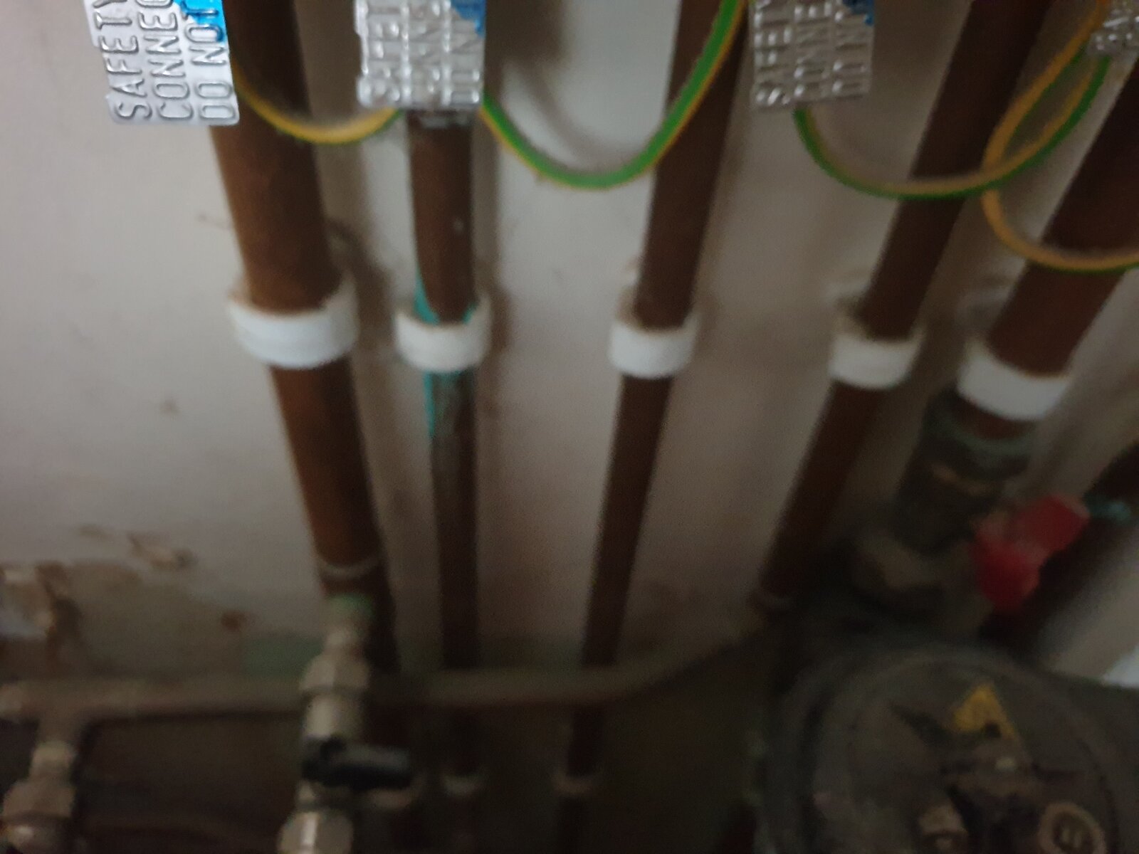

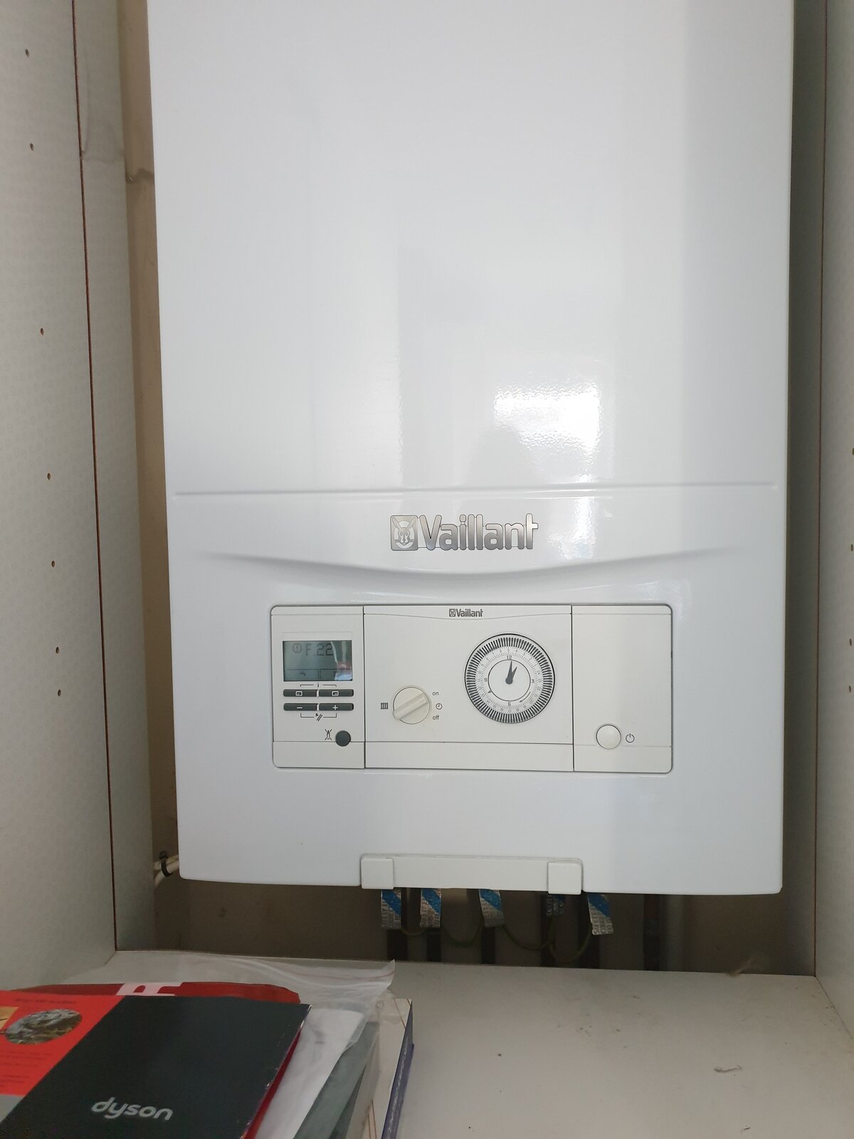

Hello
My boiler always used to lose pressure but I had a partner who could fix it... low and behold hes not around any more and its gone this morning.. I know he just used to open a valve or whatever but I dont know which one. Can anybody help me please. I will add some pics. Thanks in advance

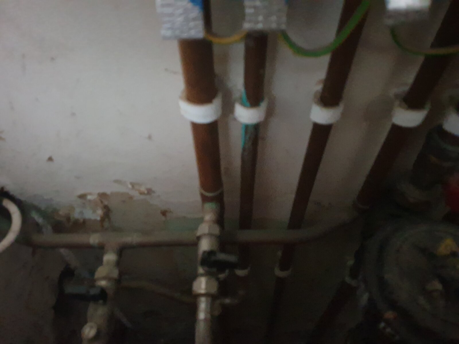

It looks like the two black levers on either end of the flexible ,silver coloured,braided hose that both need to be turned on to open the filling loop.
Thank you so much Terry. All up and running now . Hot water. Just putting heating on to make sure its OK

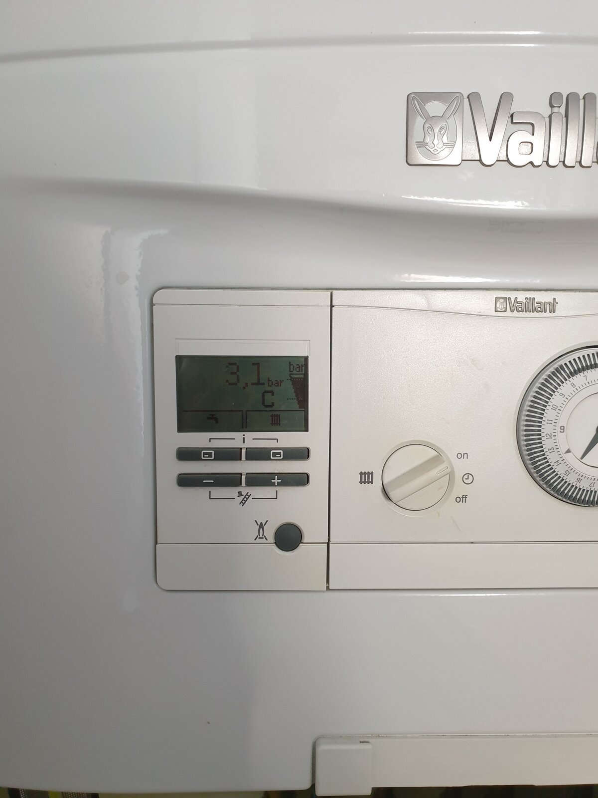

Oh dear ,just checked your pic ,and you have put too much water in ,pressure is 3 bar. Far too high. Turn boiler off immediately. Should be only 1 bar. You will have to reduce pressure right away ,the PRV may well have opened already.
Dont panic, nothing to worry about just let some water out of a bleed point in a radiator into a bowl or pot or something and the pressure will come down, take it down to about 1.5 Bar
