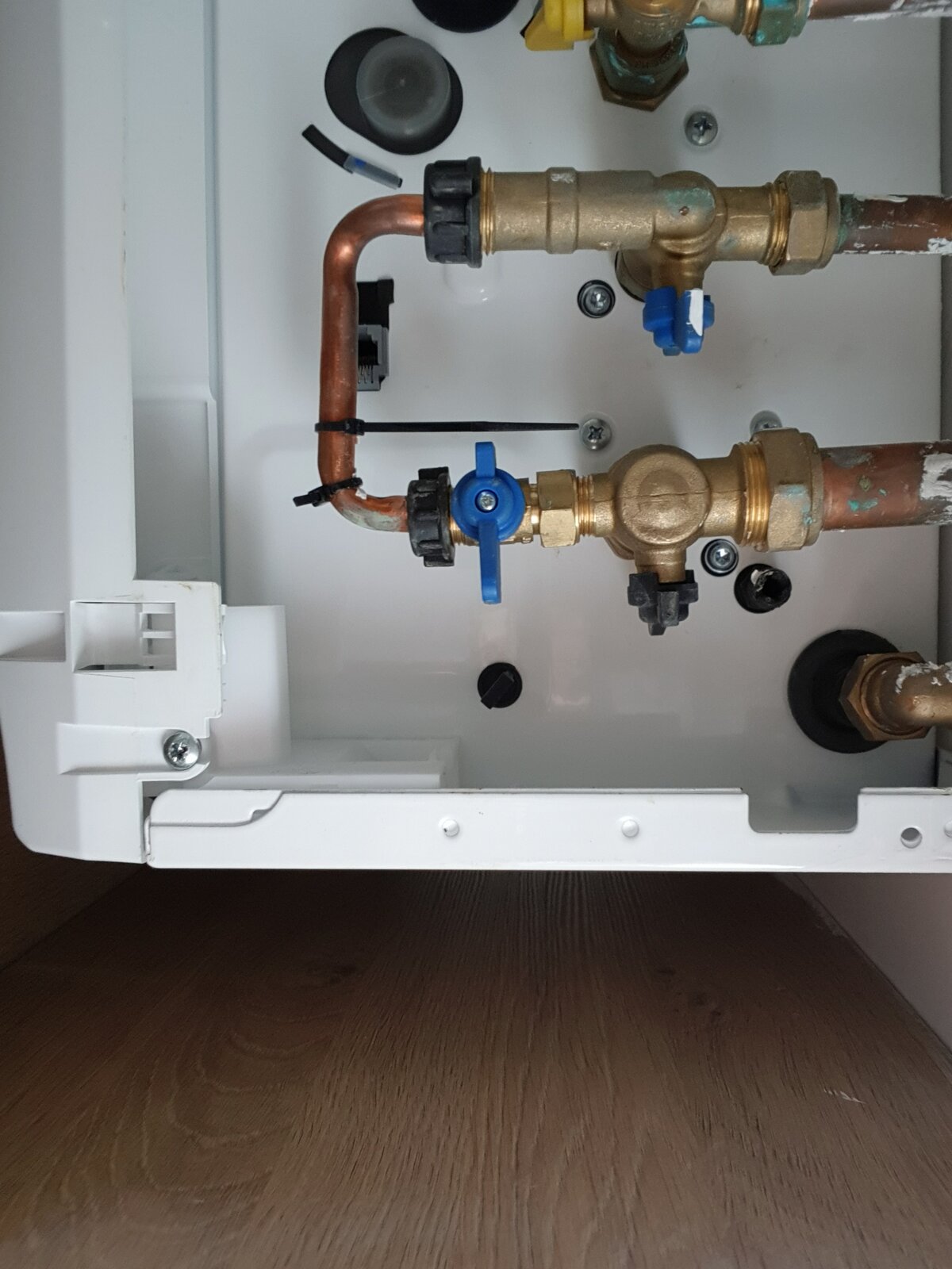

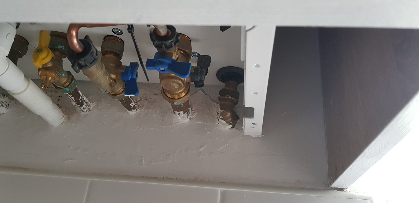

Hello,
After bleeding the radiators at the weekend my boiler pressure was low this morning (F1 code appeared) After a little bit of research a increased the pressure, admittedly I may have done it a too much as when the heating is on the bar is 2.5.
My first question is have I closed the valves properly please?

The valves look shut, and if the pressure is now stable, I.e not rising that proves it.
Continue bleeding at your radiators and the pressure will come down but you may have to lose a litre or so.
John :)

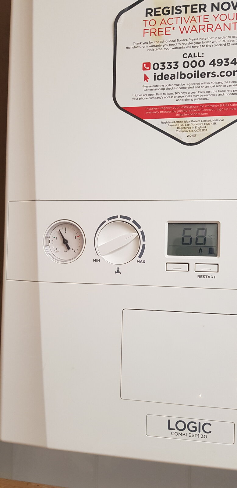

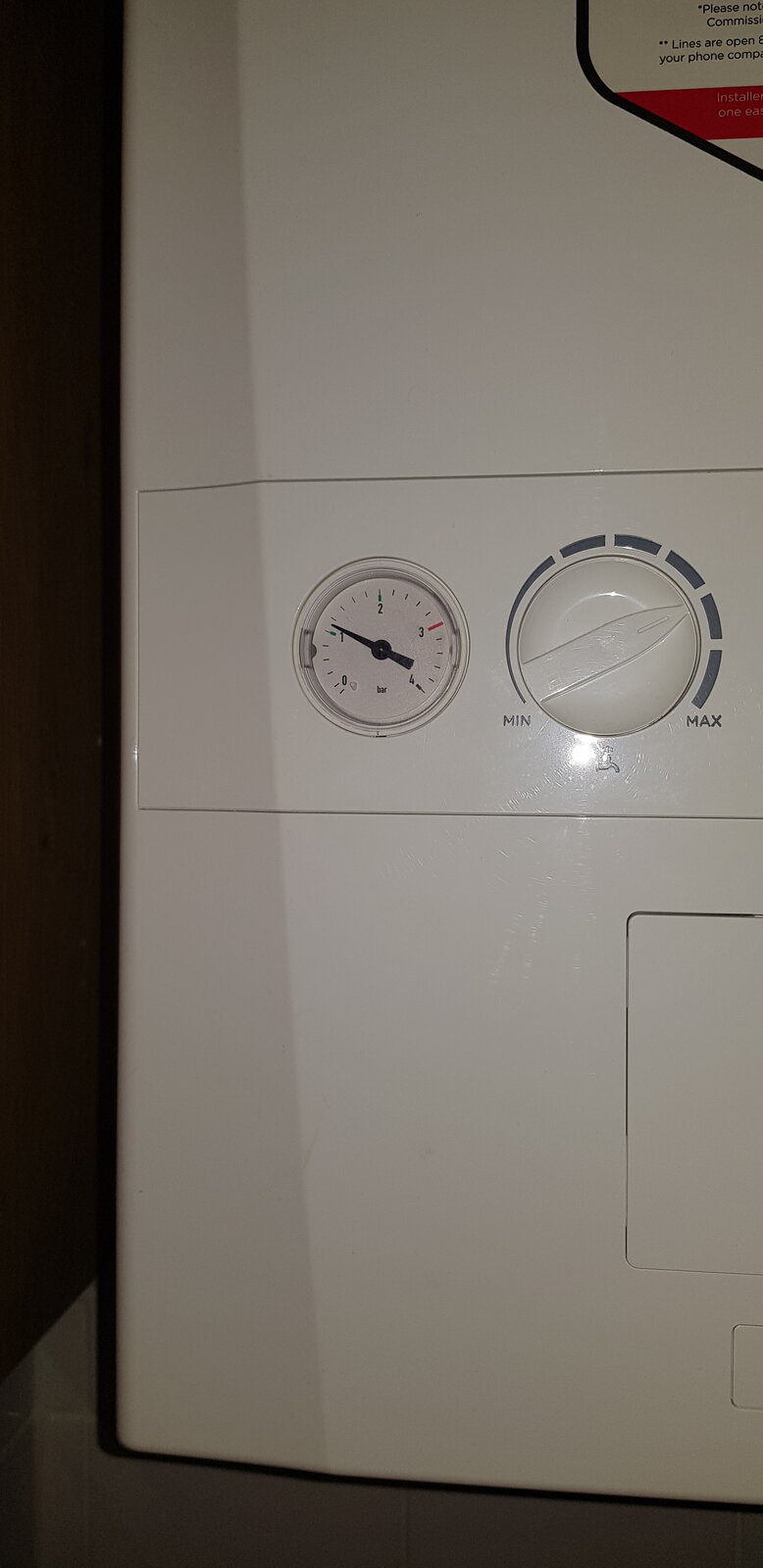

check what the boiler pressure is when cold and again what it is hot and come back and tellus the two readings
Once cool, I turned it off and did what Burnerman/John suggested, the first is after I bled the radiators, the second is when I put the heating back on.
All looks good to me, do you agree?

Yes , particularly if the heating has been on for an hour ,and the pressure stays as in pic 2
