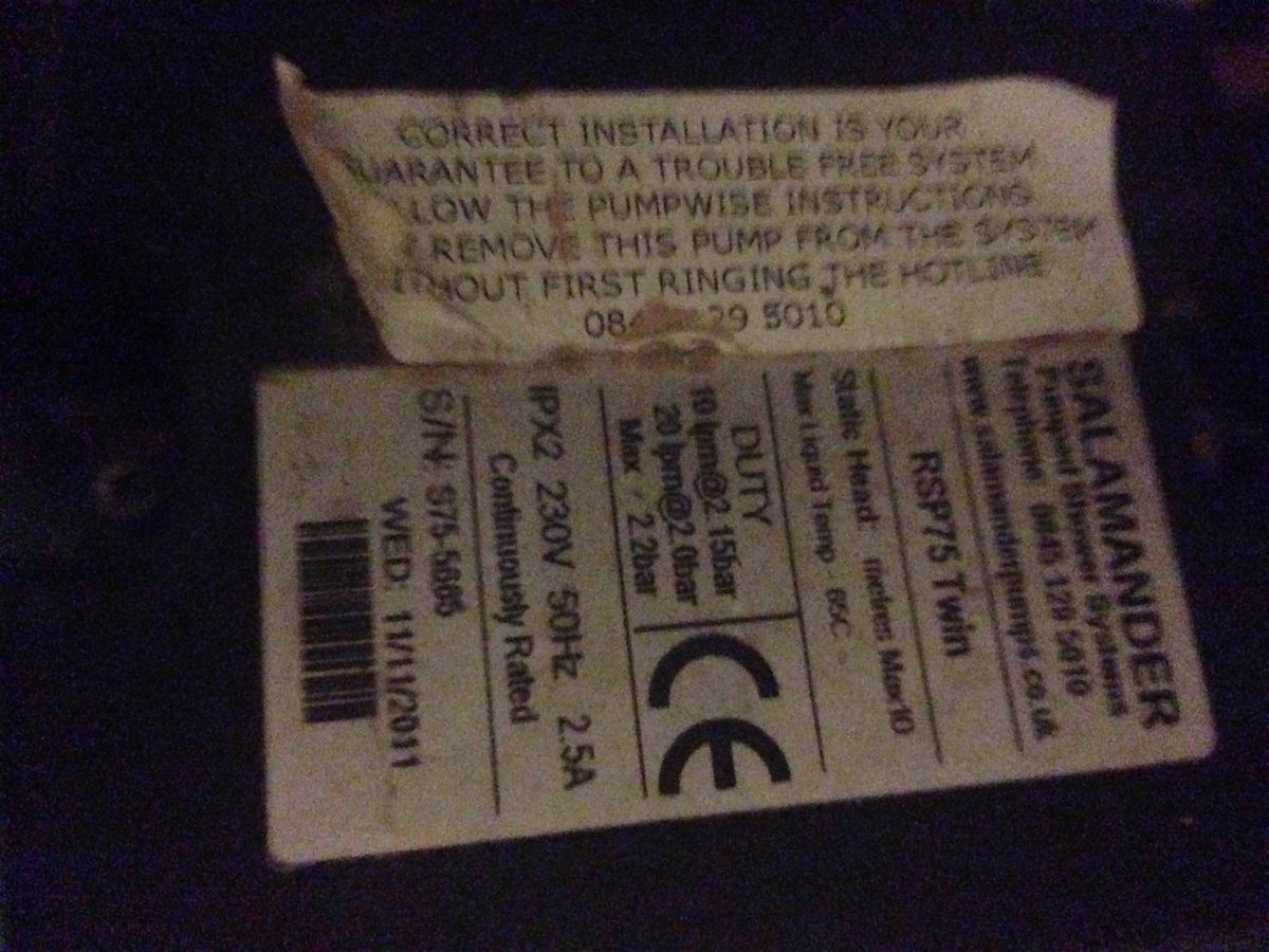

What is the make and model of the hot water pump, by the way?
Thanks for assisting me, what you mentioned seems like it would be to do with the boiler rather than the plumbing, or have i misunderstood? Does that mean it would be wise to call a vaillant engineer for free or a plumber in a light opinion?
I have at the back of the manual a page called Gas Boiler system commissioning checklist which is pretty much filled in and signed, but nothing came through the post. Only the actual boiler warranty.

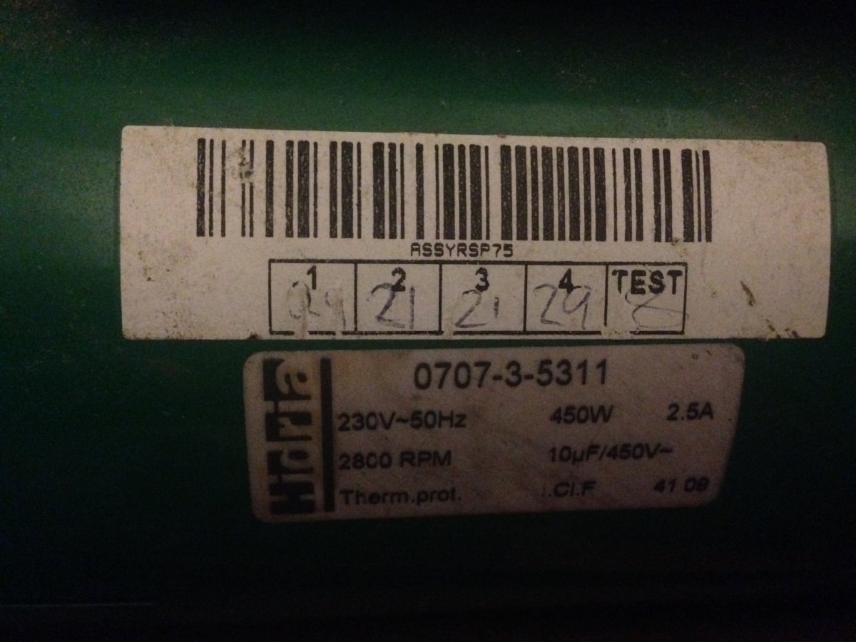

Here is a picture of the specs of the pump, it's noisy and was second hand but seemed to function well.

Here is a picture of the specs of the pump, it's noisy but seemed to function well.
You have not properly told us what boiler you have.
I am going to guess that its a heat only boiler and that you also have a hot water cylinder ( hence the pump ).

That's worrying. I hope that you still have a hot water cylinder with that shower pump??? You can install a combi and still keep the gravity cylinder. Can even use the combi to supply some outlets and cylinder to supply others if you split the system But I very much doubt this in your case
So many things wrong. Remove water pump, you could catch a terrible disease from the water and/or be prosecuted. You are putting other nearby properties at risk too.

Never mind the f75. What you have posted points to a more urgent problem. Is that shower pump connected to the mains pressure from your combi boiler??
