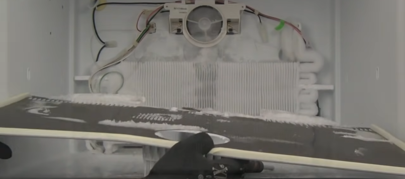

If switched off at end of freeze cycle only difference is upright relies on door seals and chest does not, upright not as efficient as chest. It only makes a difference if during defrost cycle, around a 140 watt heater on for 5 minutes is enough to defrost top of freezer if motor does not switch back on after the cycle. Heat raises so food at bottom will remain frozen, only food at top will defrost, if motors start then air is circulated so all parts same temperature.
I really don't understand these things :) Where is this 'heater'? Is it really in the freezer cavity?
If (despite the 'frost free') frost/ice develops within the cavity, isn't that most likely to occur at the coldest part of the cavity (i.e. the bottom)? If so, then (with the fan off) raising the temp at just the top of the cavity is not going to help very much, is it?
In any event, I still doubt that raising the temp of (the air at the top of) the cavity will have much impact on the temperature of the ('frozen') contents.

There is a panel
and behind the panel is all including heater.
There is a panel .... and behind the panel is all including heater.
Thanks. If I understand that correctly, the heater is heating back of the 'panel', rather than the cavity of the freezer. That's presumably fine for melting and frost/ice on the inner side of the panel, but I would have thought would have minimal effect on the temperature within the cavity, let aklone the contents of the freezer?
I would be very interested to know what a temperature probe would show of changes (if any measurable) of the within-cavity (or 'within-contents') temp during the defrosting phase of the cycle.
