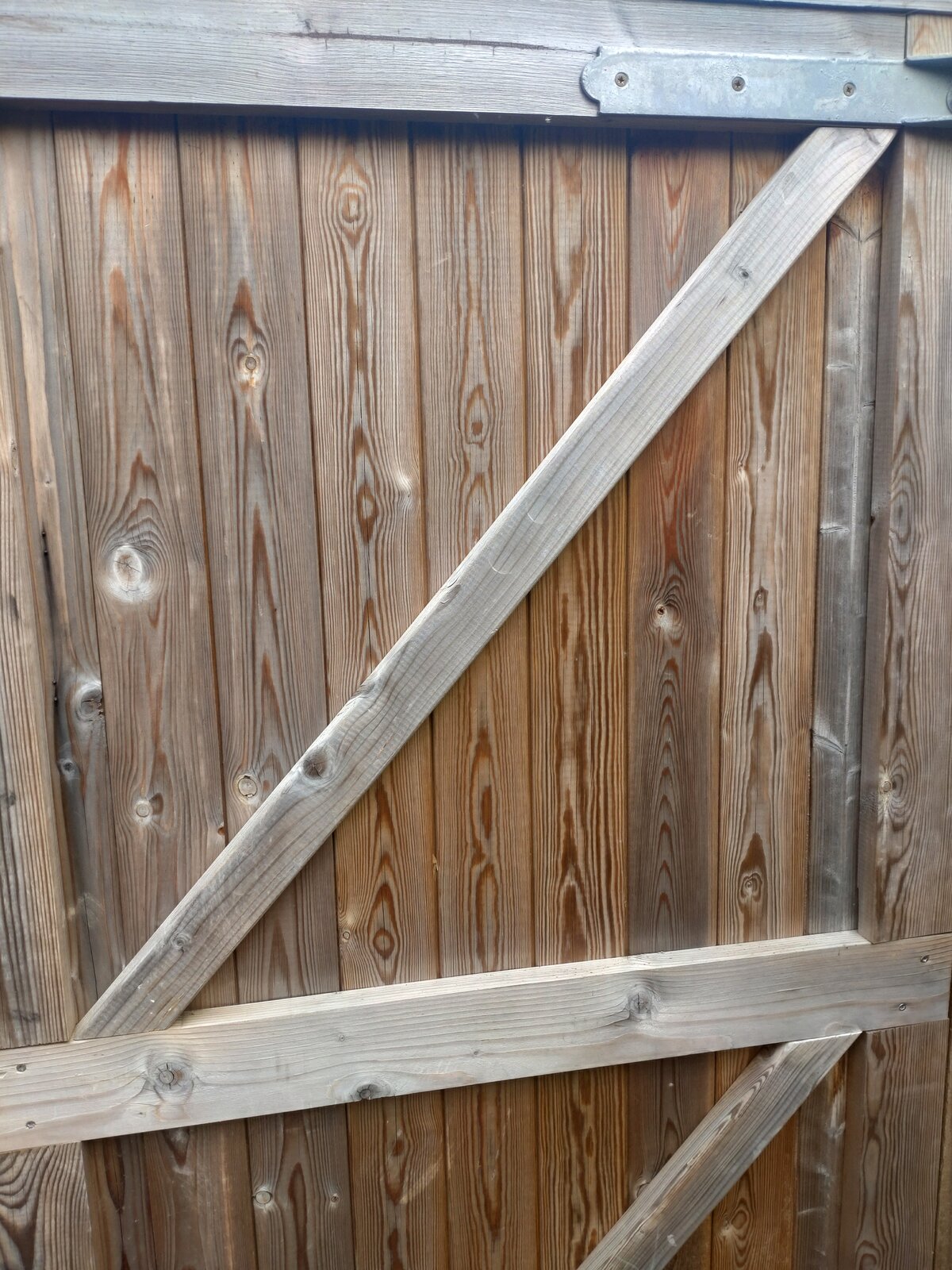

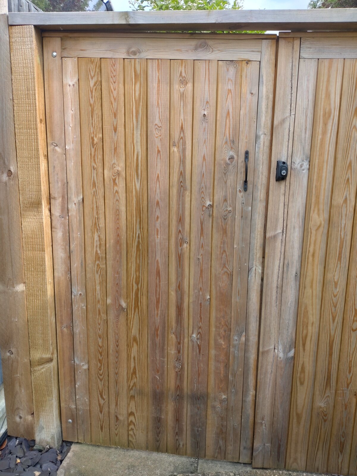

I have a pair of Wickes gates. One is fine. The other you can see has lost its square shape and is sagging at the latch end. The fixing nails have pulled out or through the cladding.
Any suggestions how to fix?
Take off. Lay flat across a couple of trestles with three 3 x 2 CLS across, then use a set of cramp heads on a timber bar placed diagonally (across the longest diagonal) to pull the whole lot back in square. Renail, but screw the braces

Please show us a full, flat-on photo of the side with the braces.
They work much better when they are built into sort of notches in the horizontal ledges to prevent them sliding out of place.

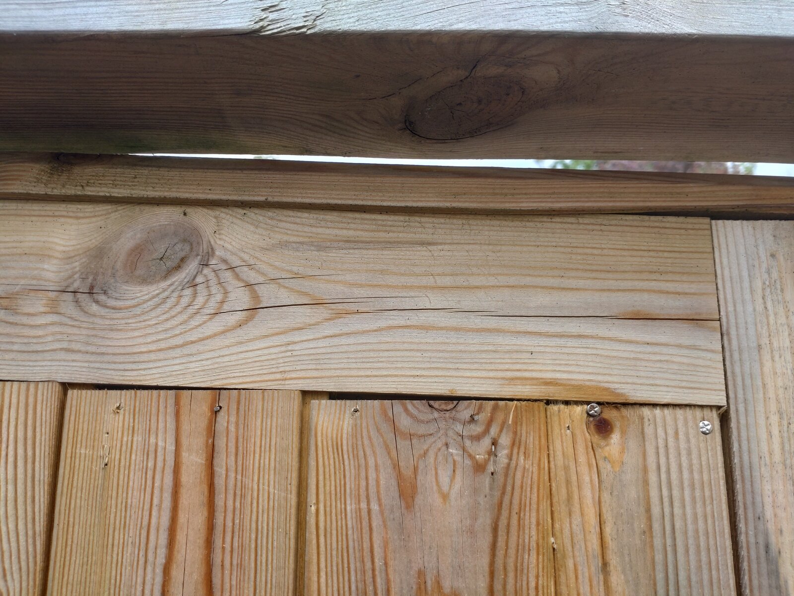

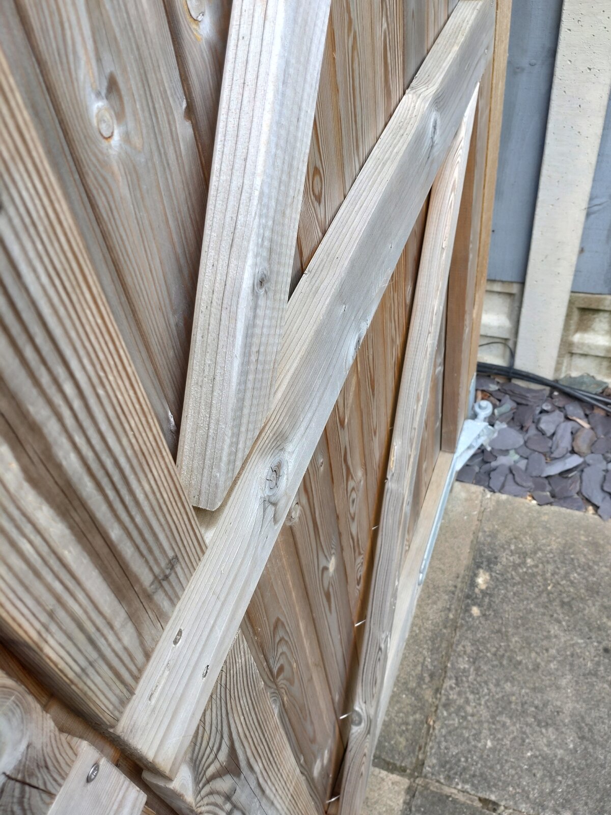

Update for you, the ratchet strap worked well enough. Gate is back on the post now and square again. I have screwed wherever there was previously a nail. I don't think the tiny thin pins they used were strong enough, plus they fixed the cladding through the V of the TGV which I suspect was not strong enough
@JohnD the braces are not rebated into the rails or attached them in any way. I could skew screw the braces into the rails if you think that will help.
Just to point out an installation error - the gate appears to be hung upside down or is wrong sided! (take your pick) To resist the tendency of gates to droop over time the diagonal braces should always run from hinge side (lower) to latch side (upper). Yours appears to be the other way round which wasn't immediately apparent from glancing at your first photo's
...the braces are not rebated into the rails or attached them in any way. I could skew screw the braces into the rails if you think that will help.
Glad the diagonal pull fix worked for you.
If you screw the diagonals, as I suggested previously, the best way is to use a long screw (4 x 70 or 4 x 80mm) and screw downwards through the ends of diagonal braces into the (horizontal) ledges. That will at least resist part of the tendency of the gate to drop, but won't cure it if the gate is wrongly installed. Another technique is to make up (or buy in) triangular corner strengthening plates and fix them in the corners, joining them to the (vertical) rails, (horizontal) ledges and (diagonal) braces. Not pretty, but works, and in this case may be what you need to do
You don't get a choice, they only come RH. At the time I bought them in COVID they were the only sensibly priced gate I could get. Lesson for next time though.
Definitely not upside down unless you're telling me the capping rail should be at the bottom!
